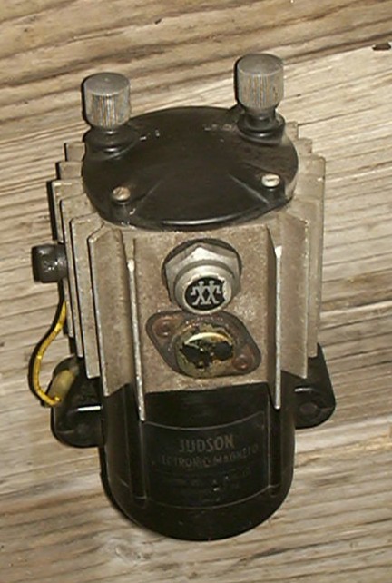

    Found this old ignition coil in the JY today. It looks pretty cool, so I had to grab it. Couldn't beat the $5 price. It was bolted to a 64 T-bird witha 390 so I'm sure it's 12 volt. Also I can make out JUD then 2 letters and a N on the sticker. So I'm thinking JUDSON or JUDSEN. The terminal end says BAT and DIST as well as MADE IN USA.
    Can anyone tell me who made this, what years it was made, or any other info? (check out the pics below)
    Thanx, Bungy

    I think those were called "Judson Electro Magneto" coils. I swear I've seen them mentioned before during one of my archive digging searches.

    I didn't look at the pic, but if it has finned aluminum on part of it, with black bakelite, it is Judson from Pennsylvania. The Judson bros started off doing speed parts for Flathead V8s way back.
    ..then they were best known for their popular vane type superchargers for lots of smaller engines, VW being the most popular, but MG, Healy, Corvair, etc..
    Their coils are popular with the VW crowd.

    Bungy it looks like a combination coil and electronic ignition. One of the components on the heat sink is a transistor.
    Definitely a cool early accessory and should boost your ignition a bit as well.

    Guys building late 60s / early 70s "period correct" hot rod volkswagens like them and will pay decent money for them. Judson would have them in their ads foir the Supercharger kits they made for VWs. Pretty good coil in its time.

    Its a Judson Magneto Coil...you see them advertised in 60s Hot Rod magazines and later into the early 70s...they are just a normal coil in that you dont need a special ignition system to run it...here's a pic of mine so you can see the whole decal...

    Thanks everybody for the replys. I guess it's not quite as old as I thought, but I still think it would look pretty cool screwed to the firewall of my 32 Chevy.

    with a transistor it must be a CDI set up.

    Yep, a judson coil, they are really good, its keeps the voltage in the coil and away from the points basically.
    I put one on Bulls A tudor.
    I think they came around in the early early 60s, they fit right onto the facotry ford flathead coil bracket.

    Nope, not CD...just "transistorized".
    The transistor was in the circuit,
    merely as part of the triggering
    system. It allowed most of the
    current going to the ignition
    coil to bypass the points, thus
    extending their life.
