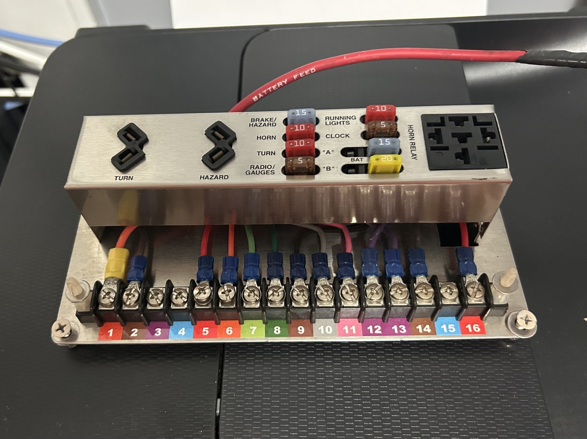

    This came with a car I purchased, I want to use it. I need the wiring diagram or any instructions. It does not identify who made it.
    Thank you
  2. Ron Francis and missing cover for terminals that would have his name on it.

    if you remove the fuses and use a continuity tester, you will be able to make your own diagram.
    each side of the fuse should be connected to a terminal and the fuses ae marked . brake, horn and hazards should go to Battery power. gages and turn go to ignition feed

    Hopefully readable if you click on it once.

    Anything Ron Frances is quarity.

    If you get the serial number off of it and call them, they will email you diagram and instructions. Good people. 800-292-1940
