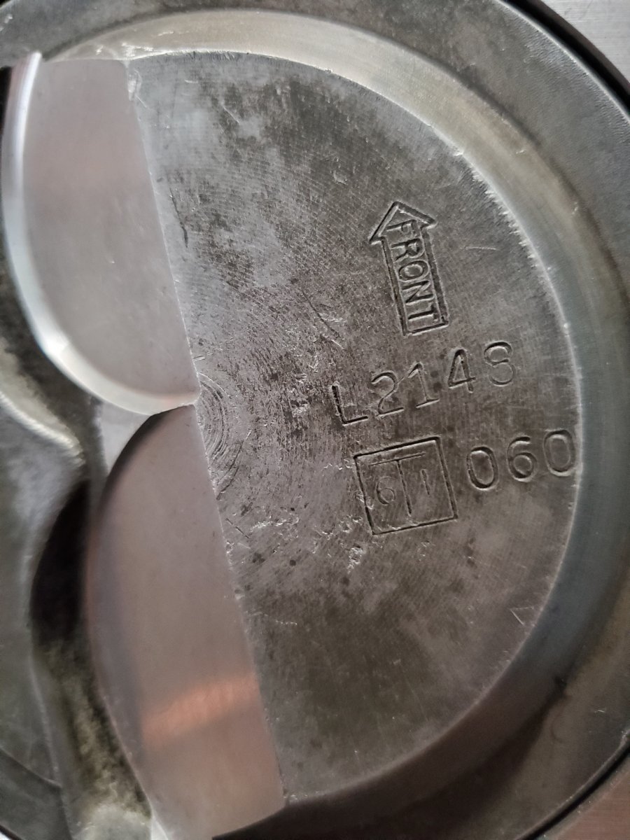

    Hey guys been a long time since I posted on here! I acquired an engine for my build it's a 57 283 bored .060 and has been 0 decked its gots some slugs in it I was hoping to find some info on. They are a pop up and look to be forged part #L2148. thanks for any info.

  2. Look like old TRW probably 10:1 or 10.5:1 in a 283

    I looked in an old TRW catalog but have no info on that part number. I had L2210 TRW’s for a 301 back in the late ‘60’s but the numbering was changed at some point to use numbers in the 7000 series. Info from my 1983 catalog shows TRW listed a 283 +.060 piston with 11.6 comp that they called the Race Version of the Fuel Injection piston. IIRC the F.I. used 1/8” domes.
    They also had another one at 12.4-1 compression that obviously had more dome height. It does look like yours were cut for more valve clearance.

    Due to pin offset, the left side pistons are L2149, and the right side pistons are L2148. TRW designates these pistons to the 1961-63 Corvette Fuel Injection engine.
    Source:TRW 1972 Engine Parts Specificatons
    Factory CR was 11:1.
    The KB piston #166 Hyper shows it as O.E. replacement for 57 - 61 fuel injected Corvette with the following CR chart: 55cc = 11.0 58cc = 10.5 62cc = 10.0 64cc = 9.7

    yeah the valve reliefs look a bit more clearanced and the dome is decent size sticks out a bit I have not measured it yet I will be in the shop probably tmrw to take another look! but thanks for the info

    2148 left, 2149 rights..offset wrist pins like factory 283, 327s had.
