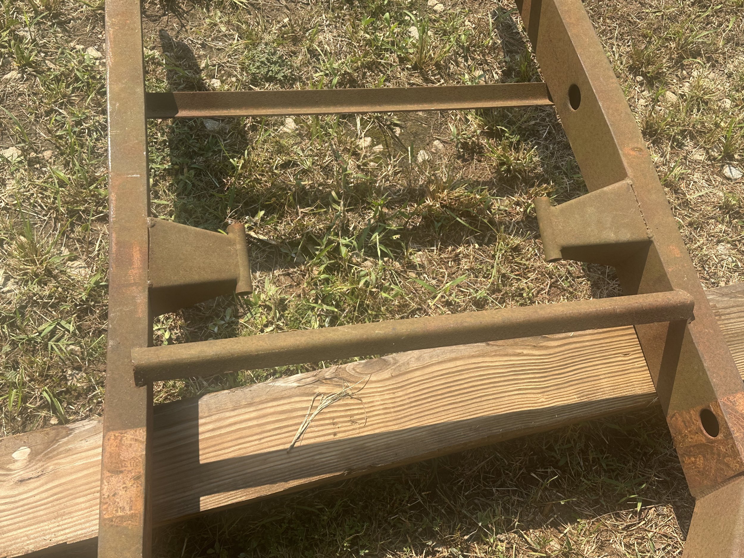

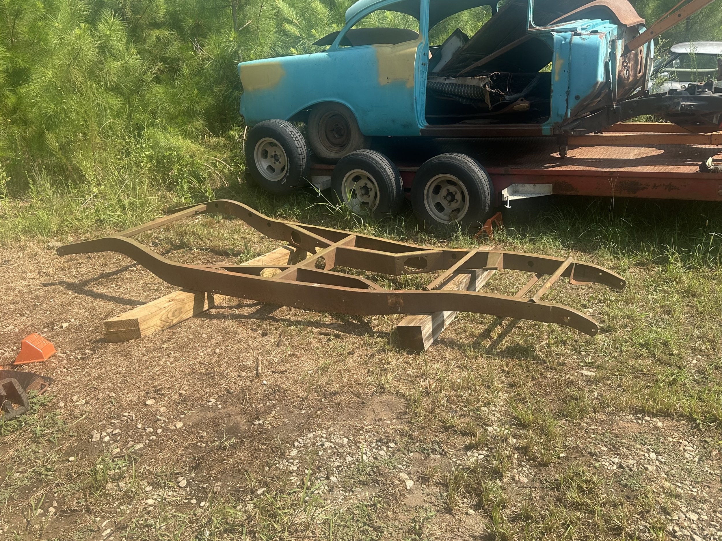

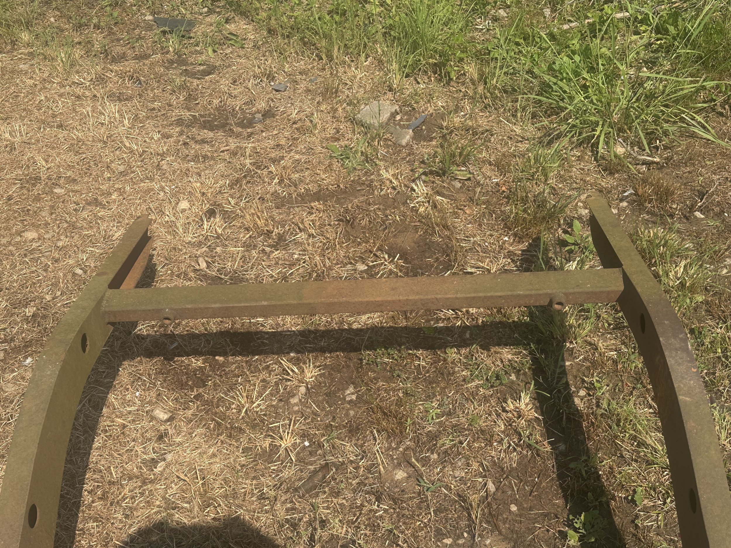

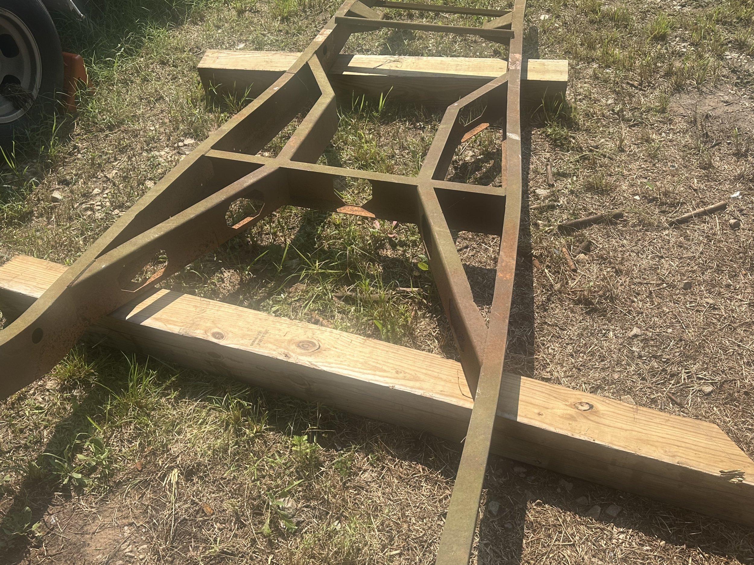

    Can anyone help me identify this frame?
    I'm nearly certain it's '33-34 Ford.
    it's been boxed, has SBC engine mounts, a welded-in shock cross member, and a stock-style K-member.
    there are six-sided holes punched in the K-member rails and driveshaft hole.
