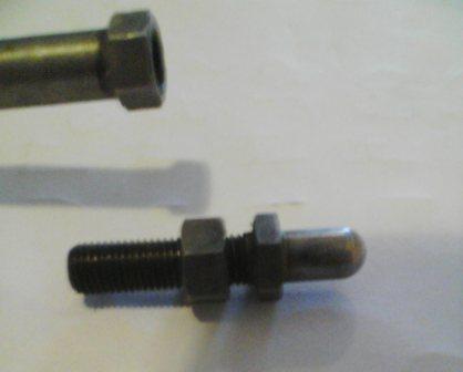

    Hi Guys, any body out there able to identify the manufacturer of these pushrods. They have cone into my possession with no history.
    Unfortunately one of the adjusters is severely worn and I would like to know if I can get replacement adjusters. The thread appears to be1/4 unf.

    Easy! For virtually any replacement, call Smith Bros Pushrods, 541.388.8188. They are masters of the craft.
    FYI, Most threads for this application are ex-fine at 32 tpi.

  5. The pushrods on my 354 look the same and thay are PAW.

    Thanks guys got onto Smith Bros and got it all sorted out.
