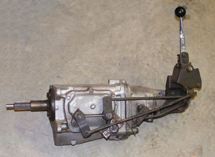

    Chevy Muncie beefed shift rods vs stock.jpeg My $0.01 is that some guys trash the stock and aftermarket shift rods and build larger diameter, stiffer rods that won't flex (appreciably) in rugged use.
  12. DDDenny
    Posts: 22,848
    I'm sure folks are tired of seeing this...........oh well!
    This is my 67 Novas' Muncie four speed, note the required forward shifter mount location.
    No if, ands or buts, this combo is a requirement, just thought I'd show these for reference.
    No speedo cable to interfere with shifter rods either.
    OP might be willing to endure the monkey motion required to save some money, not me.
    Obviously others have struggled with the wrong parts.
    Bet the shift pattern was fun getting used to!
