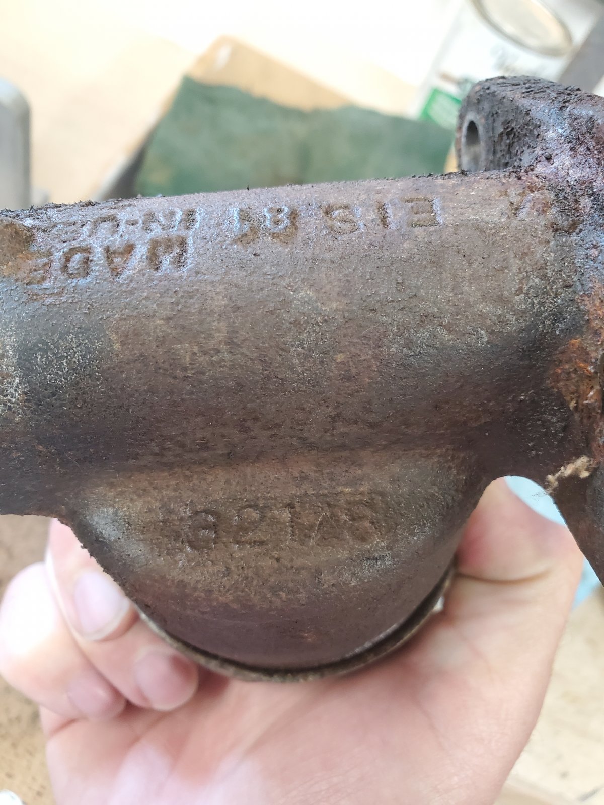

    32 Ford Magoo built ch***is. Need to replace cap and rebuild master cylinder. I can probably get rebuild parts from local hydraulic shop. The cap I'm thinking is more specialized. I think the number reads 32178. 20210925_152702.jpg 20210925_152716.jpg 20210925_152719.jpg
  2. Any idea the bore? this look really similar in my illustrated guide.

  4. Closest I could find. That number matches nothing in my parts store books, but, my copy is 1994, It is probably listed in an earlier edition

  5. Can you have a parts store look up the number?

  6. Looks 70s with the booster and extra stuff. You really just need to know caliper and wheel cylinder bore sizes. There are a lot cleaner ways to run brakes. With those sizes you can find the appropriate MC in power or manual. One question, does it stop ok now?
  7. Look at a Wagner F32900 or a Dorman M32900.

    Maybe 1". I don't have snap ring pliers small enough today to get apart.

  10. Nailed it. Looks similar to the one I posted going backwards from an image search. Wagnerf32900. Photo from the HAMB

    60-65 Ford fruit jar. In stock at local parts stores.

    That's an early Mustang m/c commonly call the fruit jar m/c. Much used in the 70's with the inline booster. I haven't figured out what the other cylindrical item is. Some kind of ac***ulator? If you upgrade to a dual m/c you'll need to replace the booster with a combo unit.

    That master cylinder came with a lot of different tops so don't be scared - just check that bore size....

  17. From EIS 1981 Catalog. 32900 fits "Ford product 60-66".

  18. Might be the 39626 if yours is 7/8 bore as yours is using the "b-c" ports.
