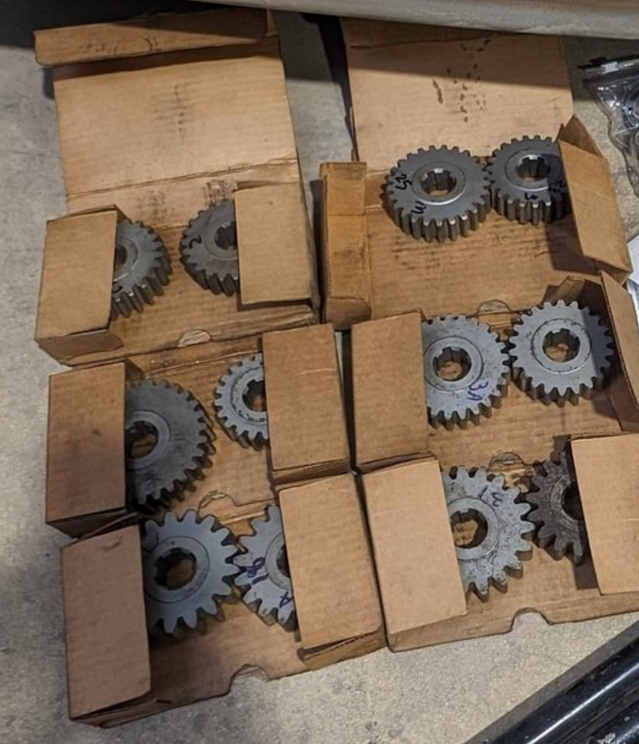

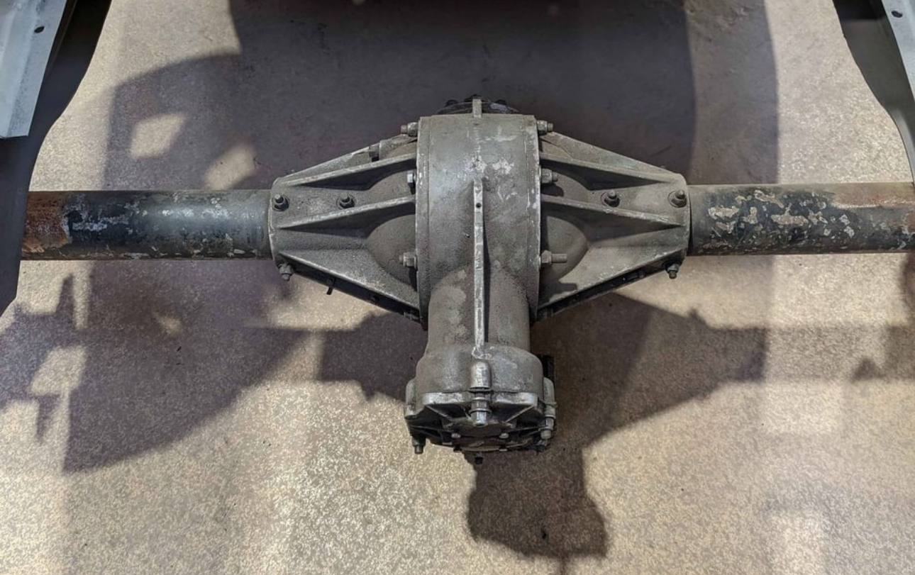

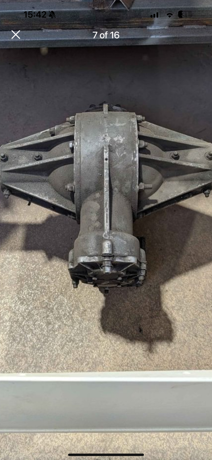

    Just picked up what my wife has called ‘yet another project’ and was hoping for some help identifying what rear end is under it.
    it came with half a dozen sets of gears, all of which are new. Can anyone recognise it??

    Looks like it might be a Frankland. How many splines on the change gears?

    those are 6 spline qc gears, i'm not an expert but i dont think Frankland made the smaller style that used 6 splines. Could be a halibrand or any number of others. There's a QC ID thread on the HAMB...

    It’s not a Halibrand, but maybe you can post pics of the cover and sides so we can see features.

  7. It is definitely not a Halibrand - ban tell by the casting itself, and it doesn't look like any of the Franklin's that I have either???

    Like 29 Sleeper wrote Speedway Engineering rear midget size using six spline gears.

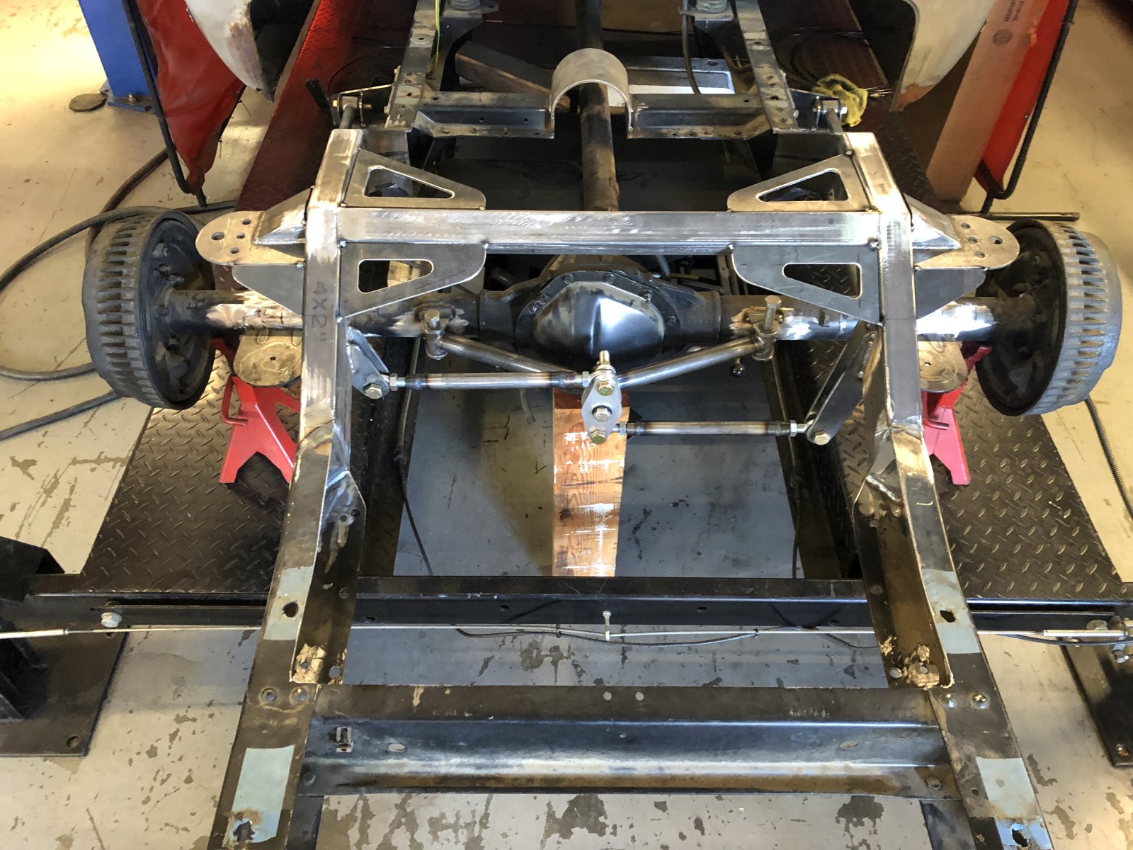

    Here's the 10" NASCAR Speedway Engineering QC in my TransAm Mustang. 3 link and Watts link. Your castings and ribs look very similar.

    Speedway Engineering Mini Stock.

    hey 29, you got any pics of that watts link? Or brand? My frankland had the upper mounts for the 3 link, but i'm going 4 link for a street car and I wonder if a Watts could be better than a panhard. I've got a diagonal link for the lower 2 bars of the 4 link but am told it might not be durable enough for a 90% street car.

    Panhard bar make the rearend move in an arc. That's why longer bars are better to increase the radius of the arc. Panhards make the rearend stay centered and move vertically only. The one on my car is very simple and light. Speedway Engineering built the complete ch***is (same as the DeAtly TransAm Camaro that won the series). I'd ***ume they did the Watts link. You'd need to machine the nose of the QC if it's just a bare casting.
