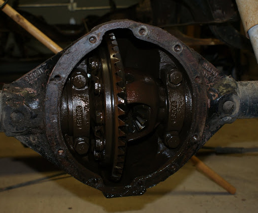

    Dana 41 from an old Ford PU without the cover. Note the flat on bottom of case matches OP photo. What about Randys R&P, it may have a more road friendly ratio available?
    48-50 (D-41) and 51-52 (D-44)

    I’ll reach out to Randy’s.

    Early Ford v8 sales carries a 3.54 ge****t for it $420.

    ah, that's the info I was missing. Thanks.
