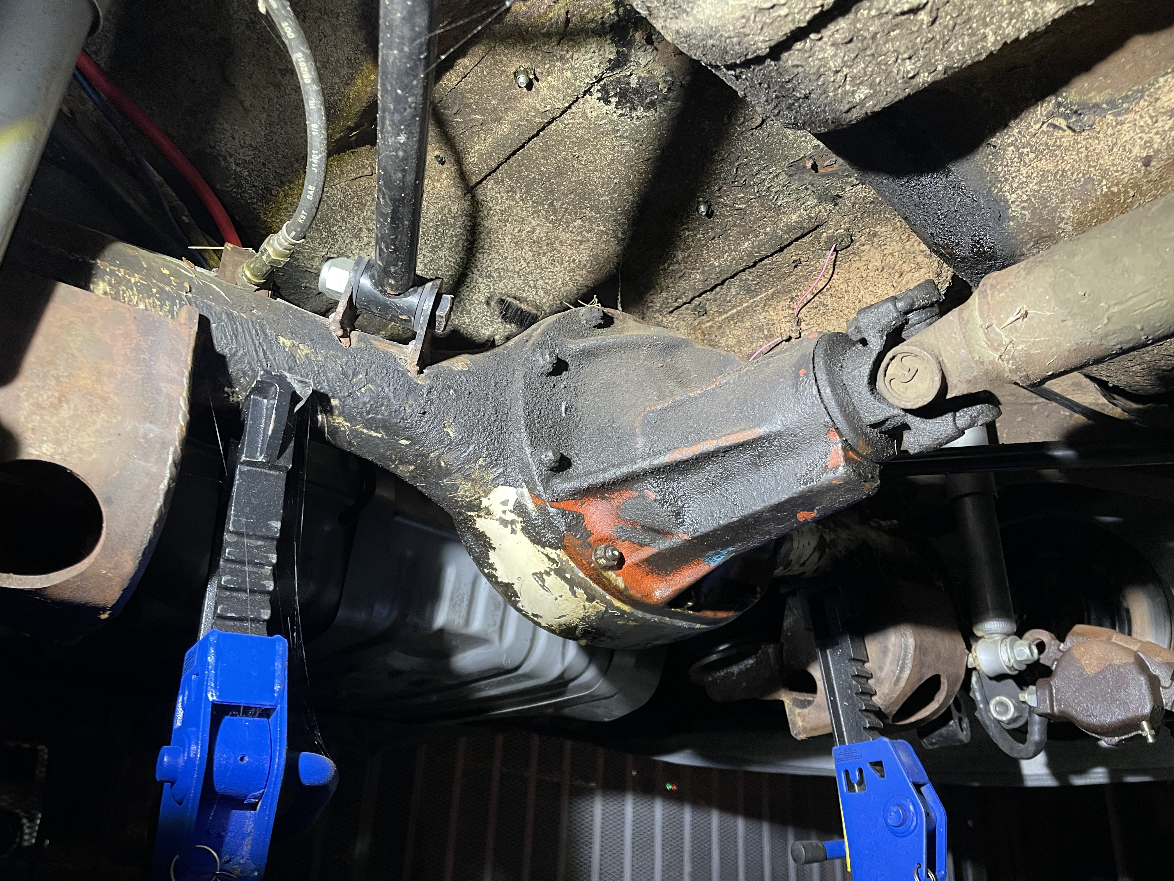

    Hello everyone! I picked up a 54 Chevy 210 a couple of months ago. It’s not all original and in need of a little TLC. Here’s where I need your guys help.
    I need new axles because somebody drilled out the wheel stud holes. The weird thing is, they seem to all vary in size o_O haha.
    Can you guys help me identify the rear end? So, I can order the axles without taking the axles out? I’m hoping you guys answered YES :D. Here’s some pics I took of the leaky rear end. Fixing the leaks will happen soon, after I get the axles.

  2. I'm guessing tri five. Could be olds/Pontiac but then it'd have a bigger bolt pattern. Got a part number for the third member?

  3. Going to say tri five based on housing ends

    55-64 Chevy car, but you really need to remove the axles to see what they are...there were different wheel bearings used, different lengths, etc.
  5. 55 or 56 Chev. 57 up had a drain plug on the bottom of housing.

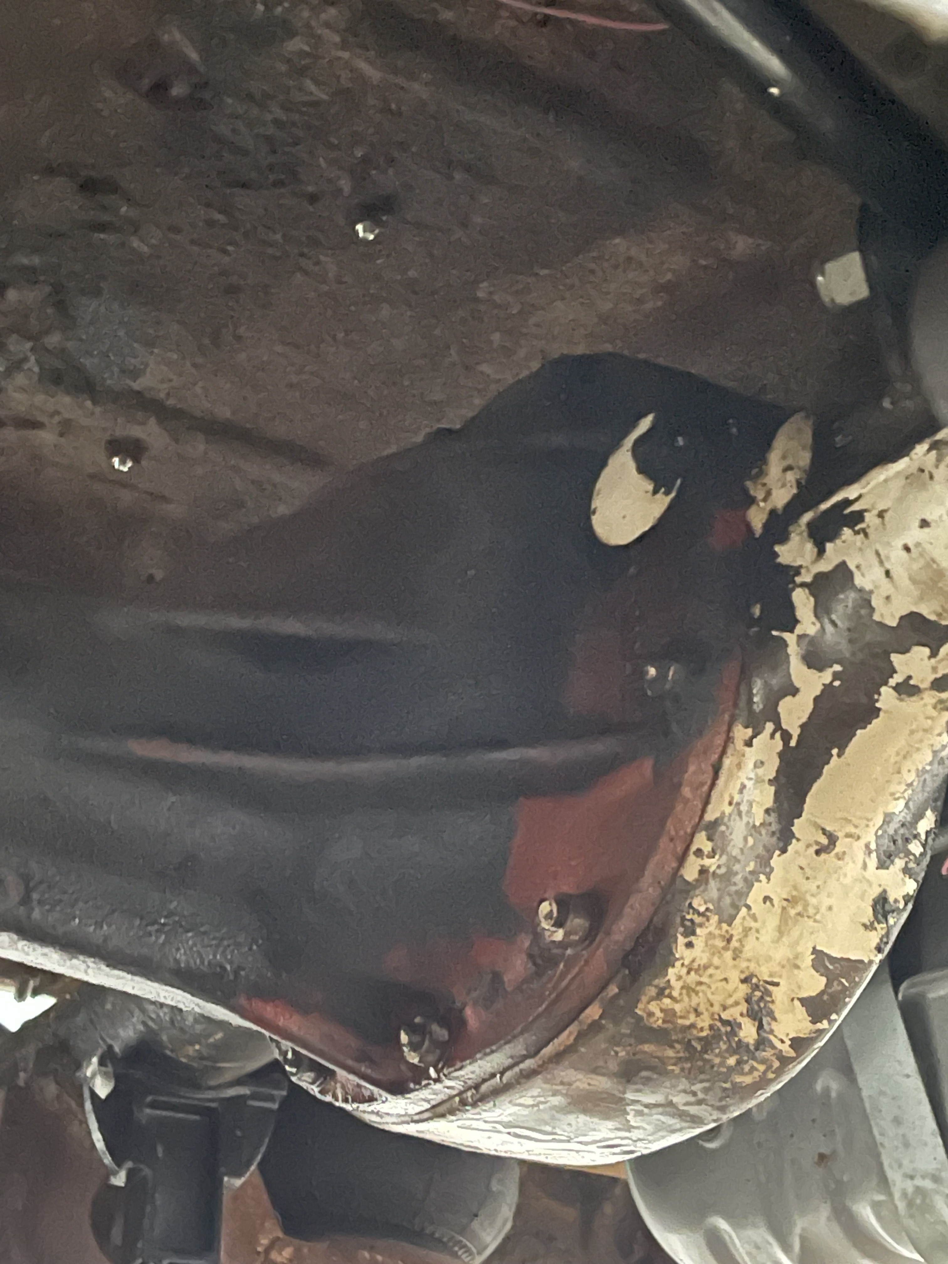

    The Chevy Pope, I was looking for the tag on the 3rd member and I think I just spotted it in one of the pics. I will crawl under there tomorrow and wipe the spot where I think there’s a round tag. Would I find the part number on there? One of my buddies also said a tri five type rear but he wasn’t 100 on it.

    I'm thinking those big rusty brackets that are hanging down on each side are what's left of the lower Control arm brackets in a 58/64 rear end. I know when we put a 61 rear under my 48 in 1973 I had to cut more brackets off it than you could write home about.

    The tag doesn't have a number, but it will tell you what ratio it is (or what ratio it was before someone changed the ratio). The shape of the tag is what matters, it will be either fully round, or have a notch or other shape cut in it. There will also be a casting date on the iron housing, and a stamped number on it, which together might narrow down what the center section was originally installed in. Unfortunately that won't tell you for sure what axles you have, because it was very common to replace the center section with something else.

    Squirrel, I was able to get under the car real quick and wipe off a little crud before my son called me to make him some food haha. I found one row of numbers, the GM letters and the white round tag. I posted some pics. I’m not sure if there is more under the numbers or behind the tag. I’ll have to try again tomorrow for a little more excavation of the other side.

    I think that casting number is 1955-56. When you get a chance to find more numbers, let us know

    @squirrel I just looked under the beast on the opposite side and I didn’t see any stamping. I wonder where it would be stamped on a 56 3rd member? A quick search of 3707306 brought up that it was from a 56 (from a different forum, somebody had the same numbers). I drove the car one time only and then put it up on jack stands. The gear ratio did seem low like 4.11 or slightly higher. I’m not sure if it’s the gearing in the 3speed 52 caddy trans or the torque on the 331.

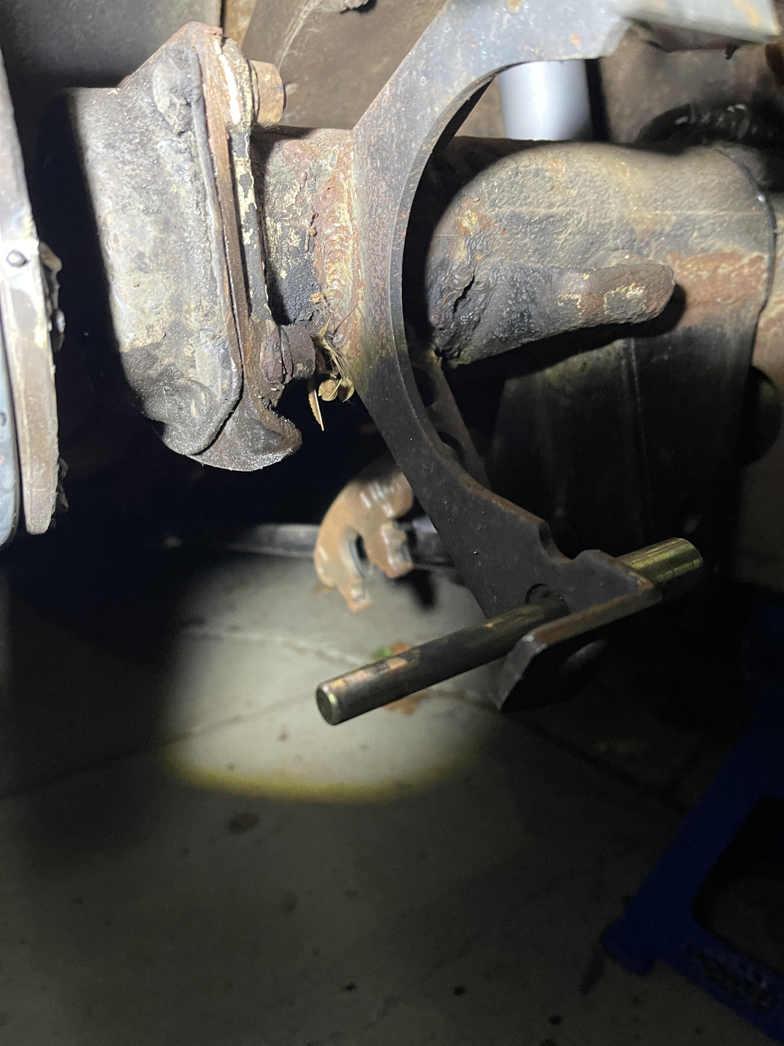

    I don’t think I ever plan on making a crazy amount of power in this car. It has a 52 Cadillac 331 with matching 3 speed trans. Im debating if I should salvage this rear end and redoing what’s there correctly or….. redo the whole rear suspension with a 9”.
    Anyone have an idea which brake bracket this is? I might need other one because one side is off by a 1/4”.
