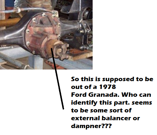

    can anyone tell me what this is on the rear end? seems like a dampener or maybe external balancer?? upload_2020-10-4_8-2-57.png

    You said it. Damper.

    forgot to mention seems it was glued to the shaft and it came loose. I cut off and its been running a few years fine without it but always bothered me as to what it was and its purpose.

    So when it broke loose from the rubber. I just cut in half and removed. I certainly don't feel any vibration but hell its a hotrod so can't really tell. Any idea if it will damage anything??

    Removal of it won't hurt a thing....only reason it was there was to prevent miniscule vibtration complaints from old fuddy-duddys with overly sensitive ****ocks. Courtesy of the Noise/Vibration/Harshness Team at Ford.
    Has absolutely no effect on parts life or durability.
