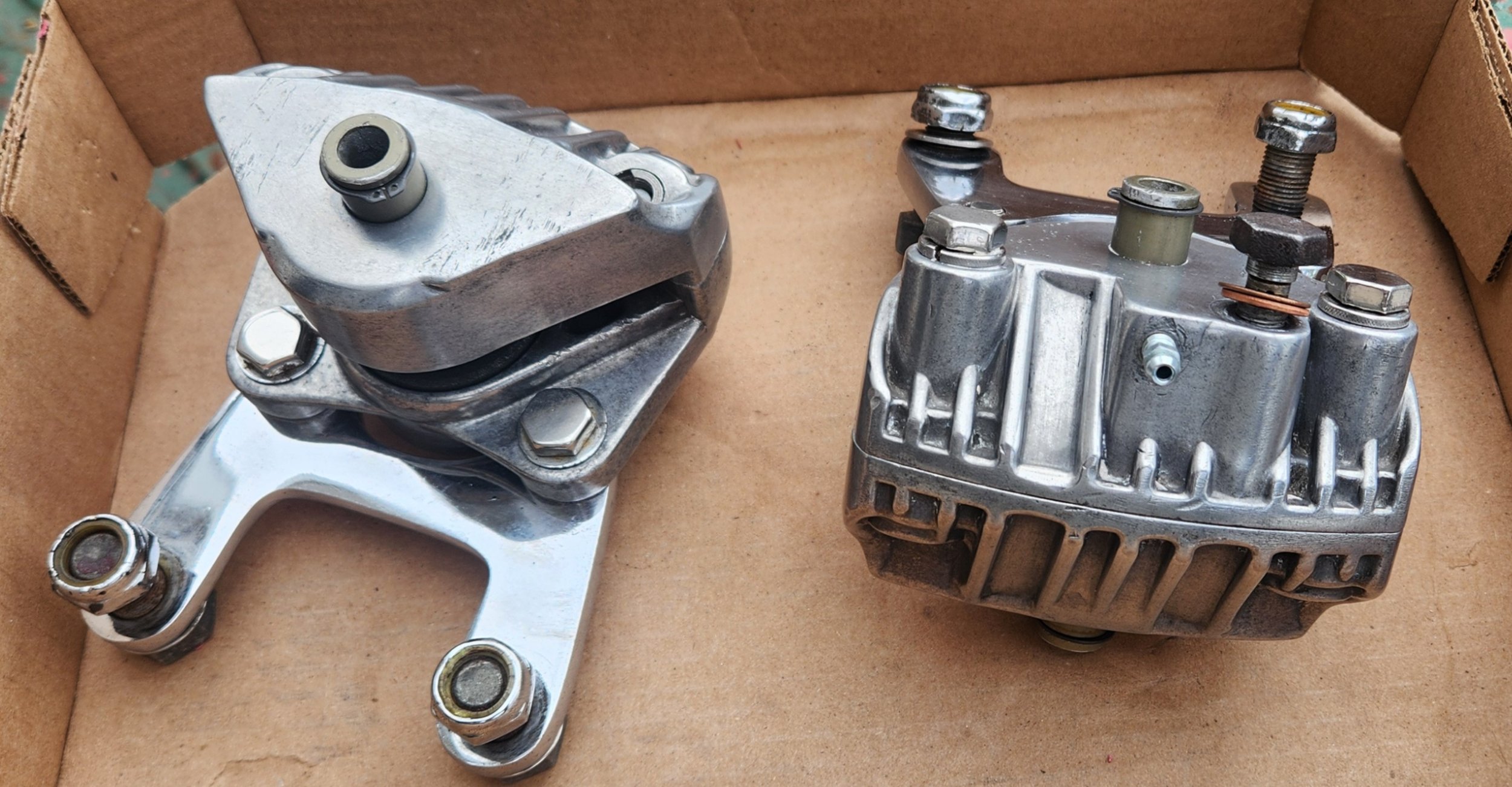

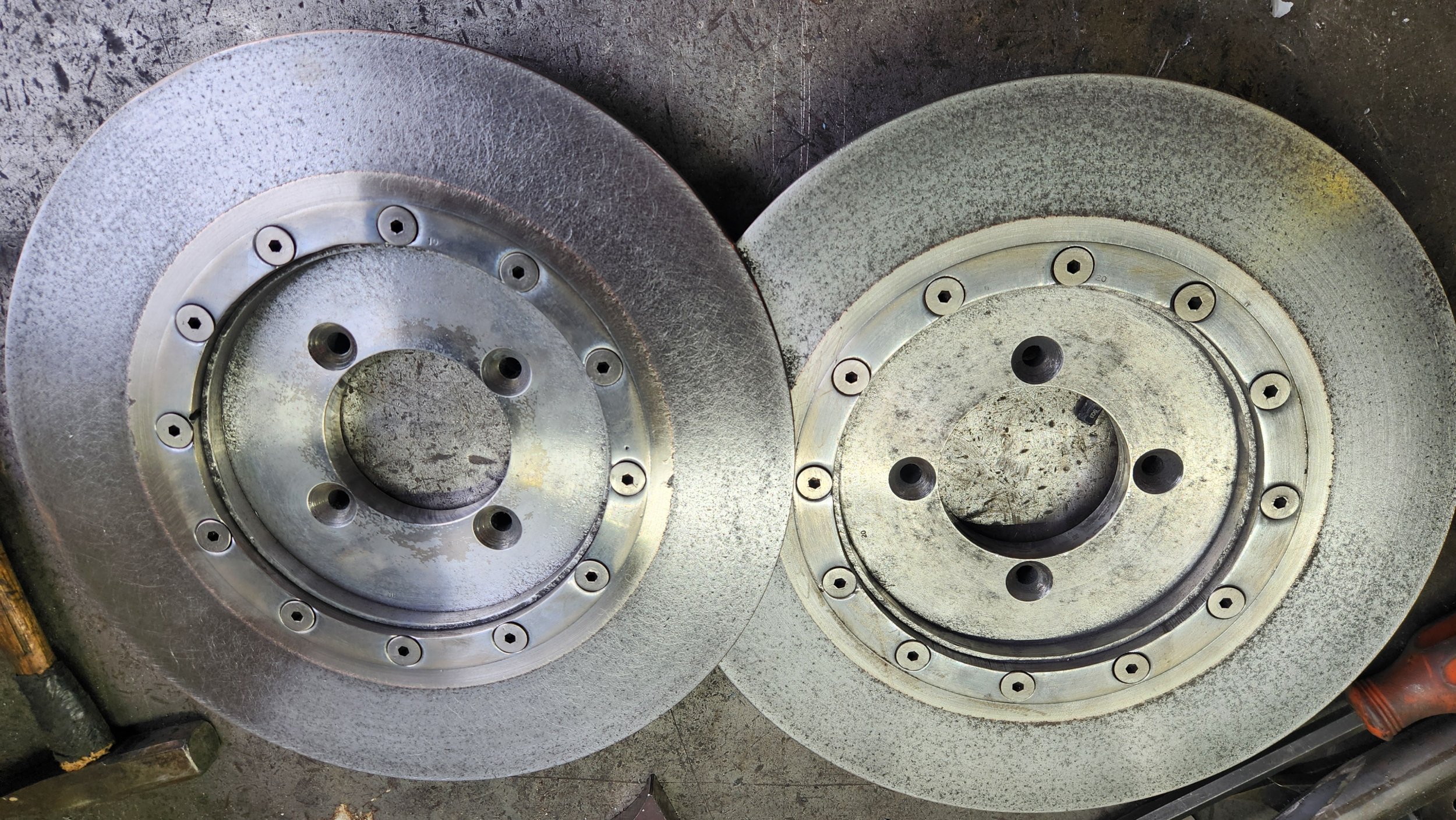

    Just picked up this setup. It looks like a lot of it was once chrome plated at one time.
    Anyone recognize? Supposed to fit 42 -48 Ford spindles, will be testing this evening.

    Look like Hurst GoKart calipers..

    better pic of calipers...

    slightly different design from this one, but it does look similar
    and generally they put their name on their stuff.

    The rotors look a little heavier than what I see on go karts, but calipers sure look like Hurst Aireheart stuff. Probably car rotors by Hurst also. Nostalgia buffs love the old Hurst stuff.

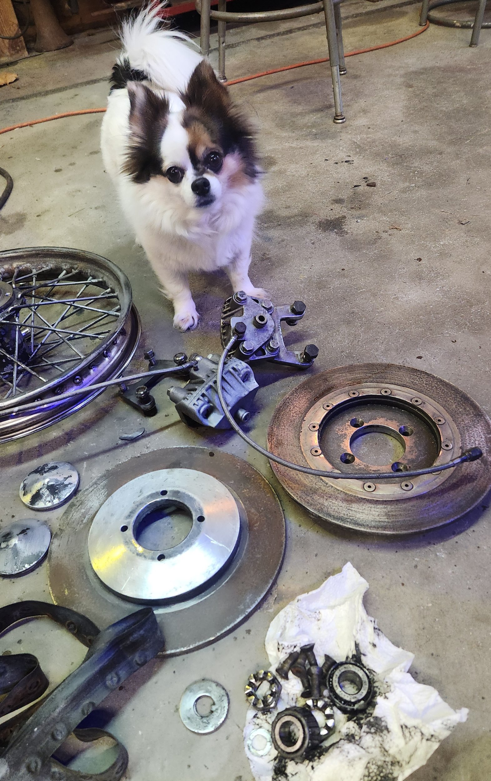

    It appears your shop superintendent doesn’t approve of the setup. Send it to me, I’ll be sure that it doesn’t upset him anymore…
    Hey I had to try

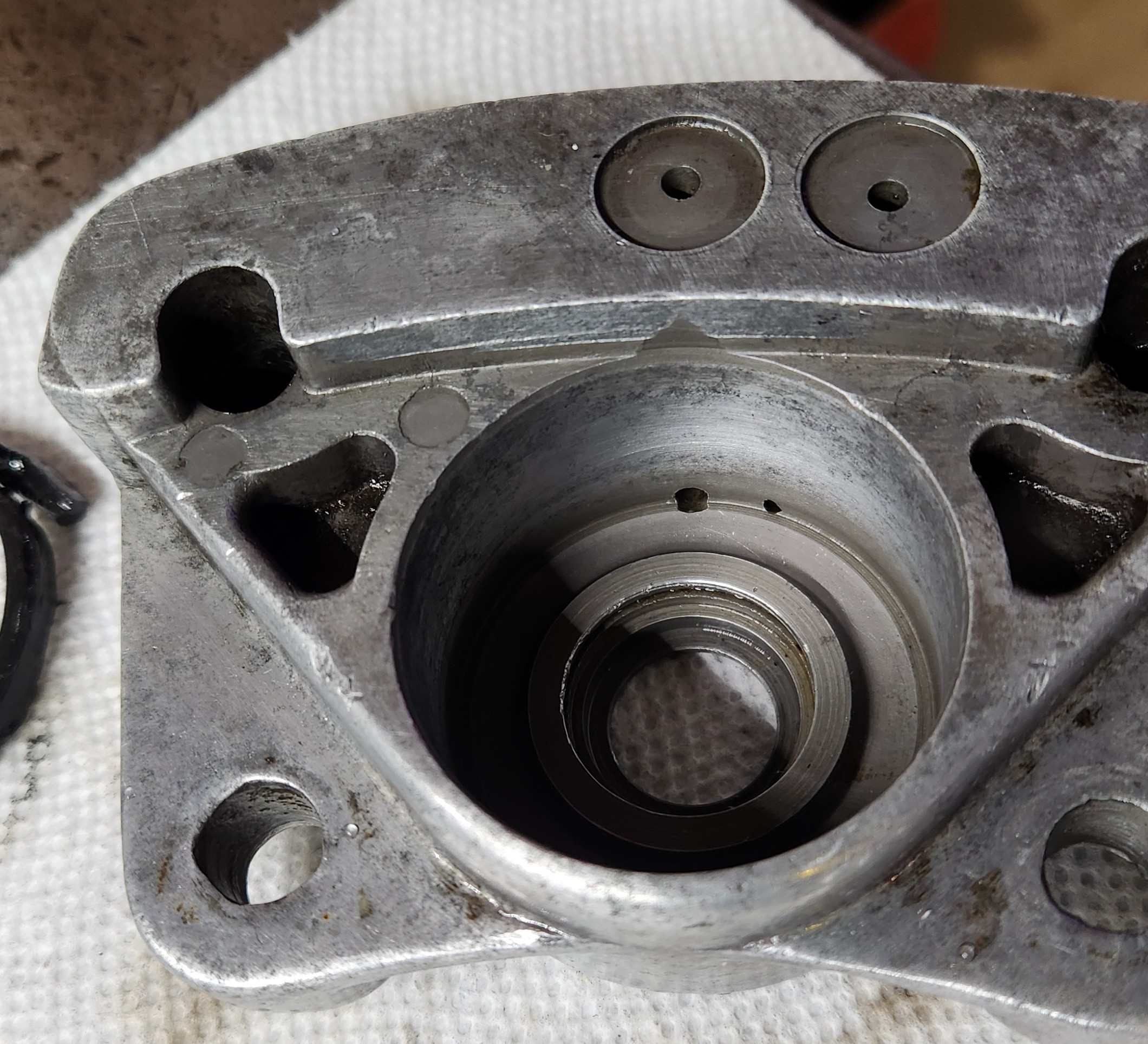

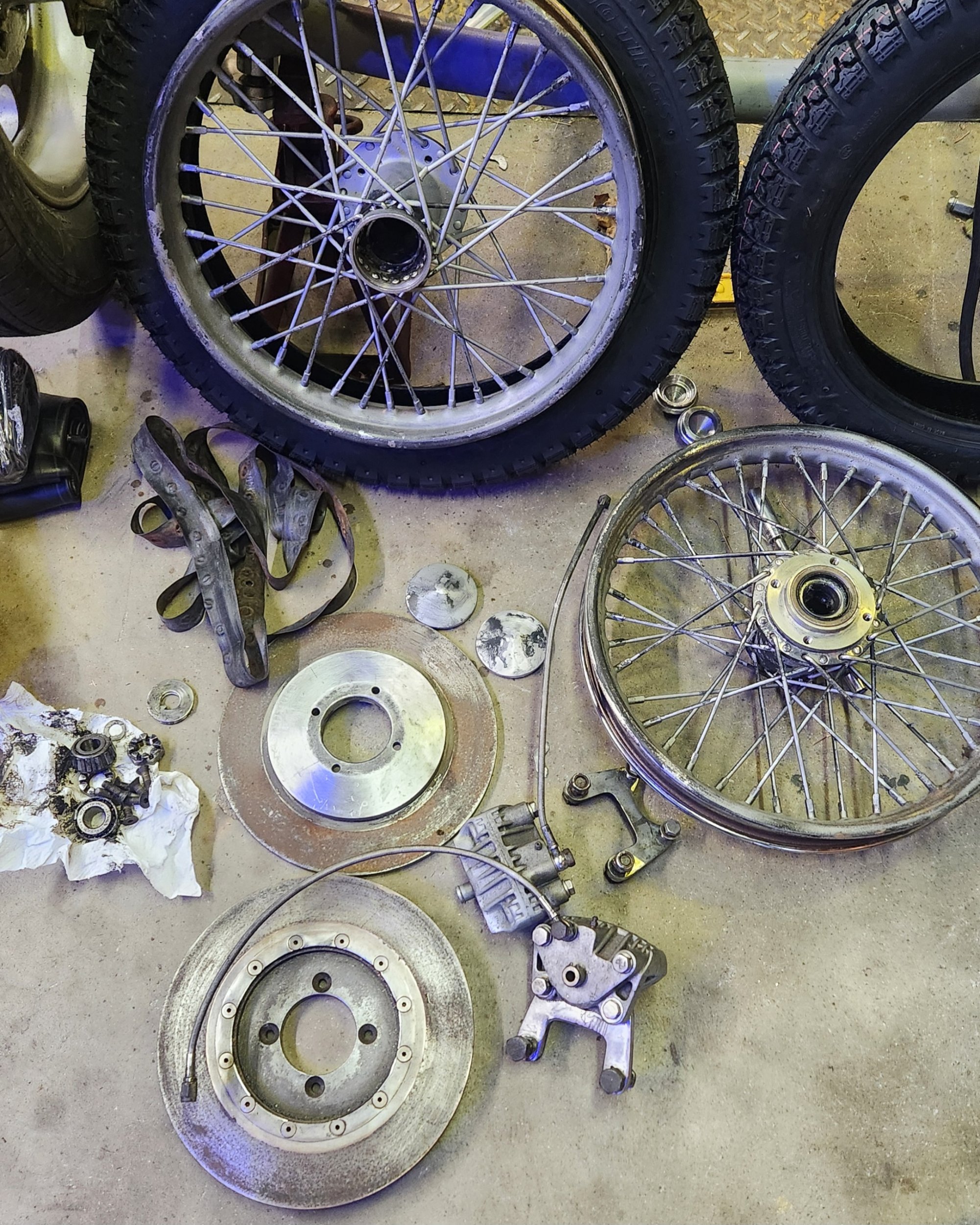

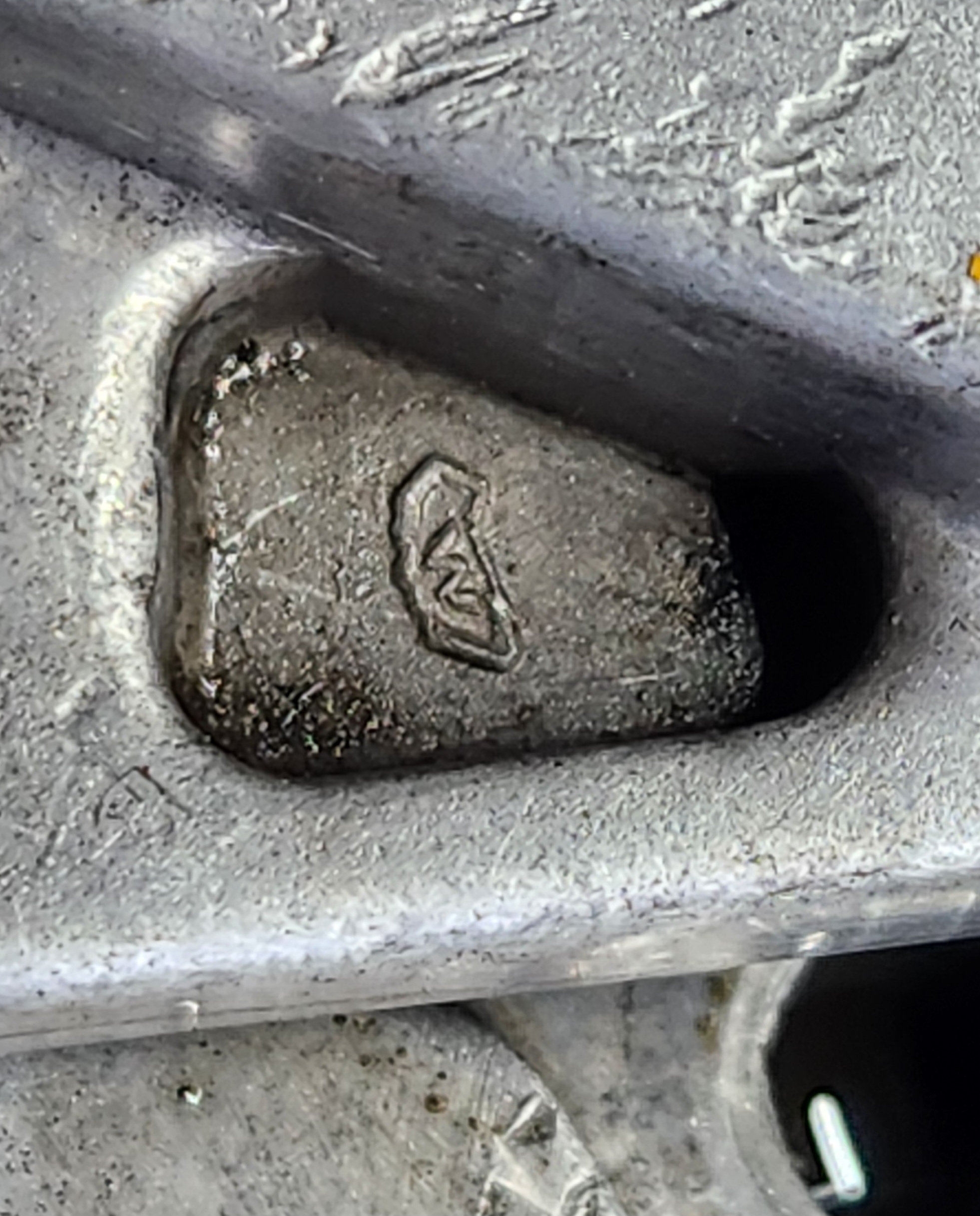

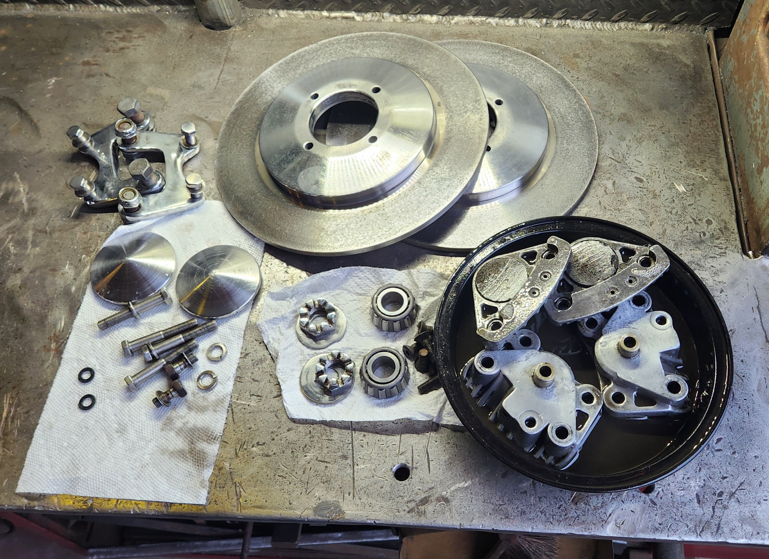

    So, I'm thinking this isn't a m***-produced unit. Calipers have a little W inside what looks like the state California cast mark. The caliper mounting brackets, dust caps, rotor mounting hubs all have tool marks. Also looks like everything was Chrome plated, painted black and silver. Decided to let calipers soak a day before trying to push the pistons out.

    is the w for 'winters' foundry?

    The W is probably Weiand Foundry.

    yes--great call

    I had these on an old altered . Problem , like many early calipers , the seal is on the piston . Whick means the sealing surface is on the caliper aluminum surface . Easy back in the dat , the bare calipers were $20 . Now you’re going to resleeve the calipers if pitted . I haven’t checked if they’re repops being made . Any shop that does the vette calipers should be able to do these .

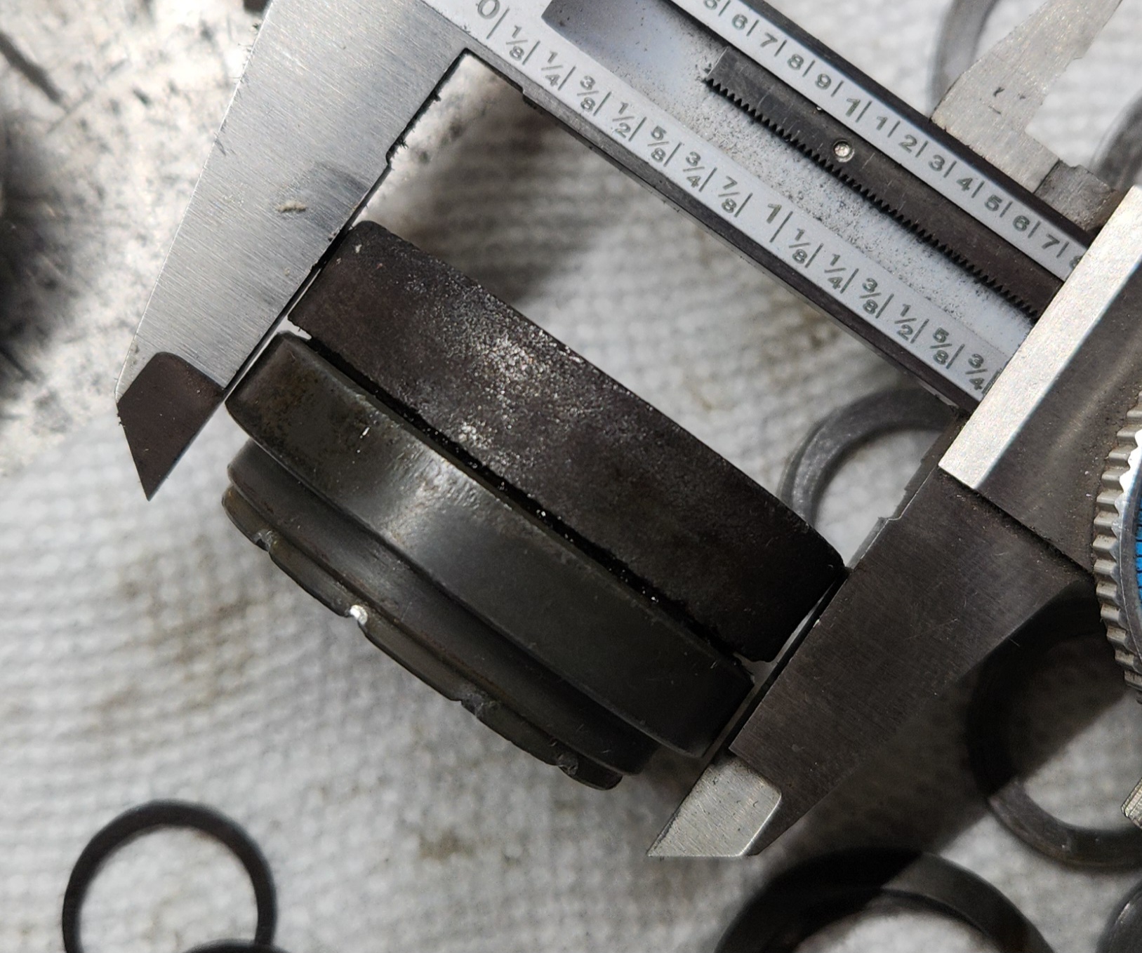

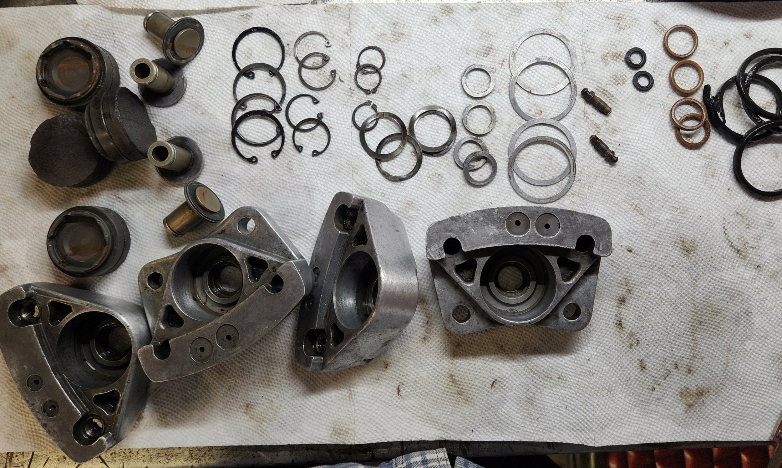

    Would you believe each caliper has 34 pieces? All the pistons were stuck really tight, later realized it was due to pucks mushrooming. Maybe from a lot of heat?

    Still cleaning laced (wire)wheels, I'm pretty sure they were made by "Hallcraft" but can't find a exact example. Got new O-rings/seals from a local hydraulic shop, they have an old school parts desk with tons of knowledge. They have build a few perfect "kits" for me over the years.
