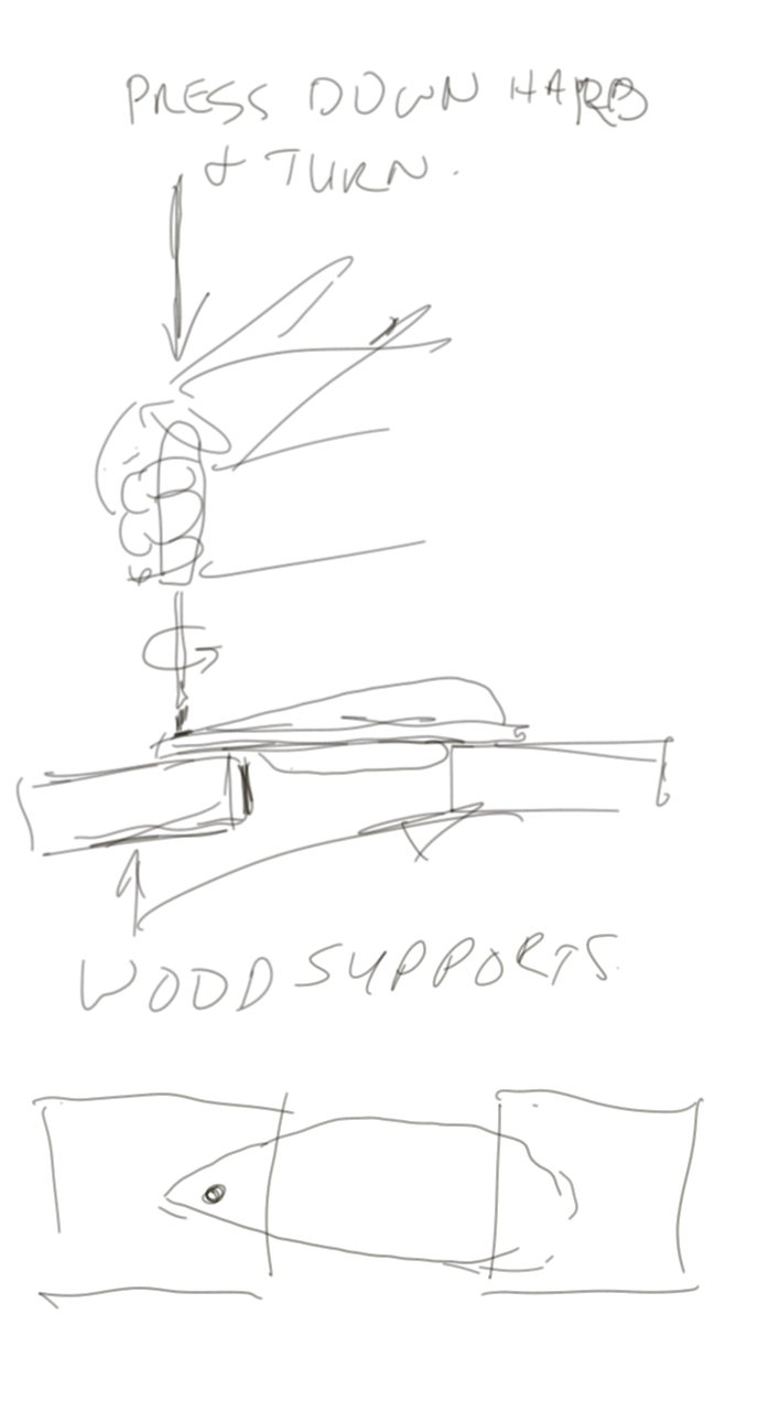

    As said great suggestions...here's what I would try...get a flat hex bit no wider than that screw and they come in different thicknesses...find one that fills the slot the best with no or minimal play. If you have one real close you can die grind with sanding disc or cut back with a thin cutoff disc and dress carefully and accurately till it fills the slot with no play...don't forget these are nickel and dime stuff so grinding/sanding a bit is no big deal...
    Second important step...get a couple blocks of wood and sit it flat and use screwdriver and two hands...align in slot using two hands one to turn one to press, turn counterclockwise and one of few things will happen...head may break off...screw will loosen or it may strip...then use drill off head option...
    If the head breaks at least you can drill the broken screw with the trim and gl*** off...
    Another method you can also do is push screwdriver down firmly and use a 1/4" ring wrench and turn counterclockwise...that is very effective as well especially on larger screws...
