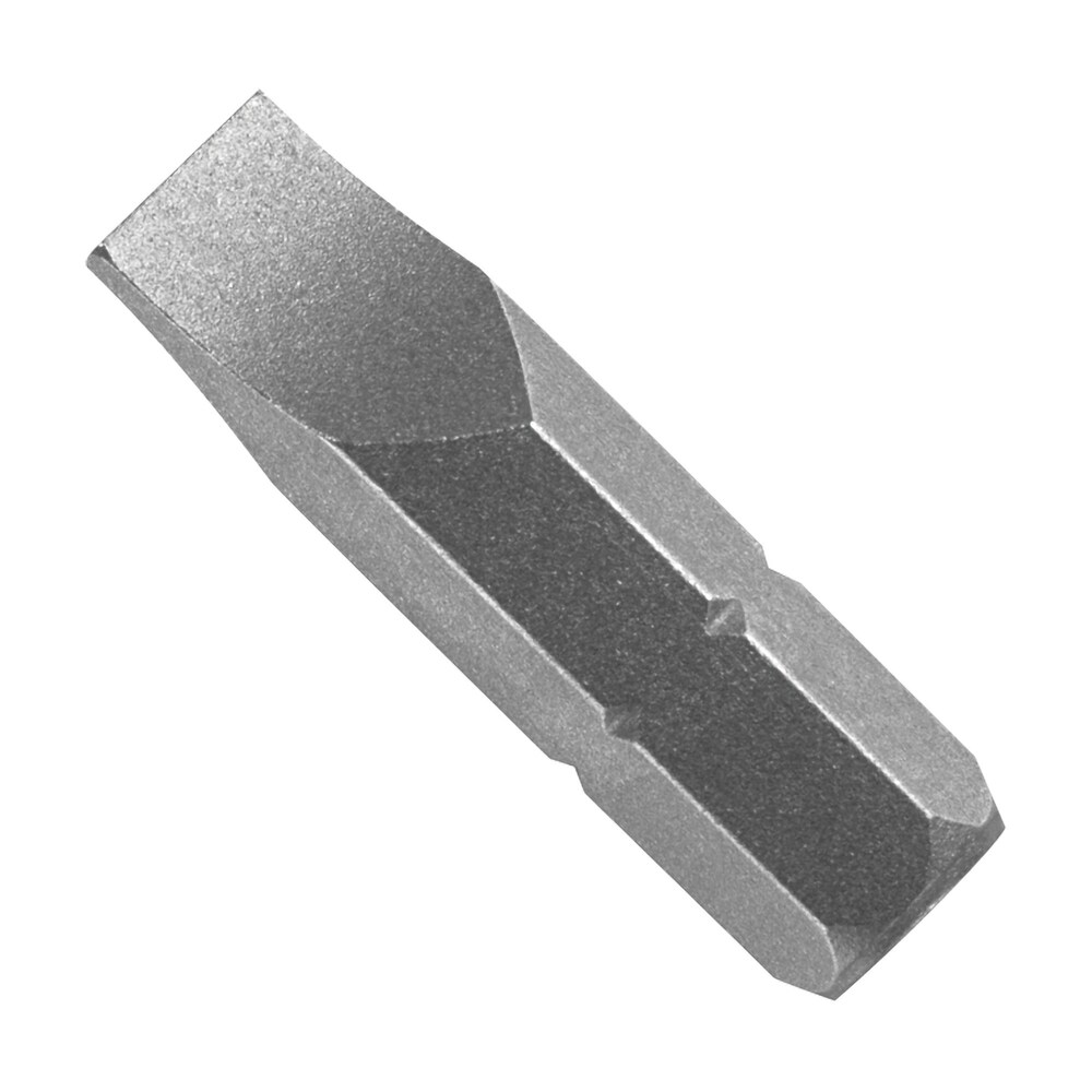

  8. Grind a screwdriver tip straight, no taper or bevel, to the same width as the slot.
    Or find a gunsmith screwdriver the correct size.
    I use Gibbs, and soak the screw front and back. Remove old paint from back side.
    Use a soldering iron to get some heat in to the backside.
    Take the ground screwdriver and try to TIGHTEN the screw just a little.
    Then try to loosen it. Repeat if needed. Tighten, loosen, etc.

    @hotrodA beat me to it: Soak the thing good and proper, get the biggest/best fitting driver that will fit, and then start out by trying to TIGHTEN the screw (this may seem counter-intuitive, but it works and helps prevent damaging the slot in the "off" direction). Once you get it to move just a little, you should be able to work it back and forth.

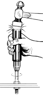

  21. As @Stogy said, but use a hand impact driver instead of a screwdriver.
    foolthrottle, sidevalve8ba and Stogy like this.

    Thank you...These come in different sizes too...Your way Harbor Freight would have them...honestly I was really impressed how well it worked...I did find a hard tip plastic mallet works well and preserves the tool...steel mushrooms it...

  25. Yes, they work great. I bought mine from Sears back in the middle 1970's. It has gotten out alot of problem screws for me. Haven't had any problems with it mushrooming and I've always used a regular or ball peen hammer.

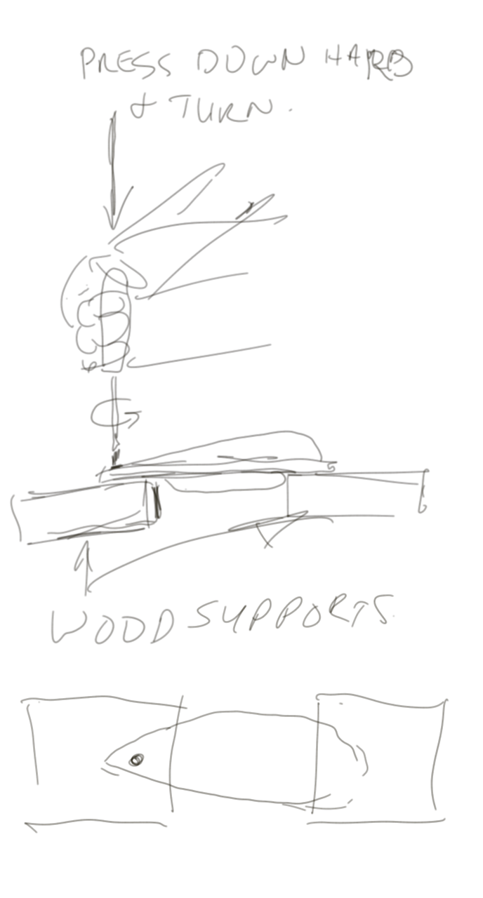

  27. Not properly supported and/or hit way to hard. I would have put a nut or piece of wood with hole to go around screw under it for support.
