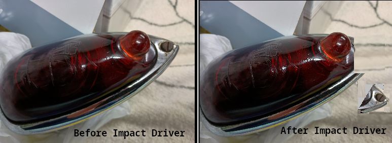

    Any time you use an impact to loosen something you also have to be aware that you may break the part if its not very substantial. Thin castings are asking for trouble. I used to use those type drivers when removing screws from motorcycle cases. They were thin castings too, but they were backed by another engine case usually, so they worked pretty well.

    This picture shows that screw going into a rusty little tab on the back of the housing, so patience and finesse are your best friends. I would go one step beyond Stogy's suggestion of supporting it with wood and make a purpose built clamping jig for it. That would free both hands to manipulate tools. Because of that rusty little tab I don't think I would use anything that provided more leverage than a screwdriver. It looks like there is enough room for a nut on the backside if the threads get boogered, so saving that tab is important. Maybe you could even TIG, braze or silver solder the nut to the tab.

    You'll have to be careful, but applying vibration to the screw head(like using an air-hammer w/a screw-tip instead of a chisel). Vibration is what loosens the rust-bond. Concept only, as that'd destroy the bezel even w/a perfect under-suppurt), while turning it, will really help. After soaking it, cutting off the exposed rotted threads, etc. Using a good screwdriver w/a square-shank allows 1 hand to put pressure on the screw, & the other hand to use a wrench to apply twisting force. So anyways, I'd go w/the cutting back off, grinding/drilling head off, & then drilling screw body out. Use a good dremel-tool for control. Just takes a little more time. For the heat, the Weller soldering iron is the best idea, given that heat, weld-spatter & old(valuable-hard-to-get)glass & ham-fisted-techniques are 4 things that do not go together well.

    being able to use both hands on the screwdriver is important, push down with one hand and twist with the other. a fixture to hold it will help. if not carefully drill the ctr of the head on the screw until the head comes off. disassemble the tail light and use a vise grip on the stem of the screw
