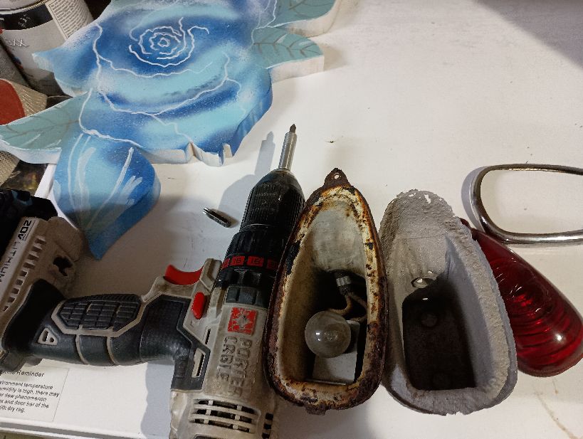

    If you can lay this on a piece of wood and screw down some blocks on either side to keep it from moving, then use some clamps with padded jaws to hold it down so you have your hands free. Then you can get a screwdriver tip that fits the slot as close as possible, and push down while turning.
    I've even put a vise-grip plier on the shank or handle of my screwdriver so I get good leverage while pressing down firmly. If the screw snaps it's no big deal. It will allow you to get the lens and trim off, and then you can drill and tap the broken screw for a new screw.

  14. It is a machine screw. Little specs of rust popped out as I turned it out

  19. Upon magnification it is not a machine screw
    Stogy likes this.
    Stogy, SS327, 41 GMC K-18 and 2 others like this.
