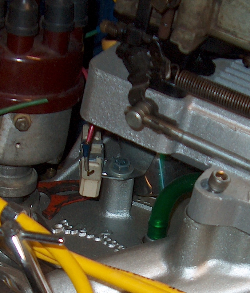

    Uh, doesnt matter how big the motor is, if the rings are sealed properly there isnt any more or less pressure in the crankcase no matter what cubic inch it is.
    And how can it be the wrong intake? Its an sbc intake and its an sbc motor right???

    Don't see anything wrong with that intake..pretty simple. If it didn't drop oil..didn't burn it..it was never there.

    It looks to me like an LS or LT intake. I'm not the magic man who knows everything, but it doesn't look like it fits the motor(as far as the design of the exit route of crank case pressure....it may not match up w/the stock engineering). I'd also add that if the block wasn't properly clearenced it will look like a mess of silver mud when he pulls the pan.....hhhhhhhhhhh and phooooooo. It's not a stock motor Tinman. I'm not gonna get in a ******* contest over it either. These are just my observations from the pictures provided. I hope you and yours are well.

    It´s an Edelbrock Performer RPM intake for SBCs up to 86. It does fit and there were no leaks around the manifold.The engine ran great and smooth, no like it had vacuum leaks.

    I noticed that, too. Not that you would pull five quarts through there, but it didn't look right to me...

    Yes, that PCV is routed to the power brake port. The PCV port is on the front of the carb body, you can see it in this pic...
