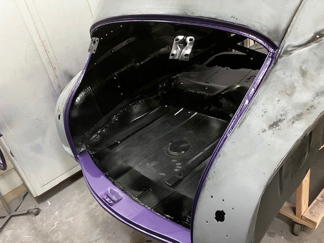

    I have some ideas but I’ve never done this before. Half of the floor is cut out and I plan to cut out all the way to where it drops down (where the DEWALT tool is in the photo, all that will be cut out).
    I sort of have a plan but am sort of hesitant so I figured I’d ask yall.
    My plan is to get the sheet metal shaped up, then take it somewhere to have some grooves put in it for strength. I don’t have the tooling for that but should be able to handle everything else.

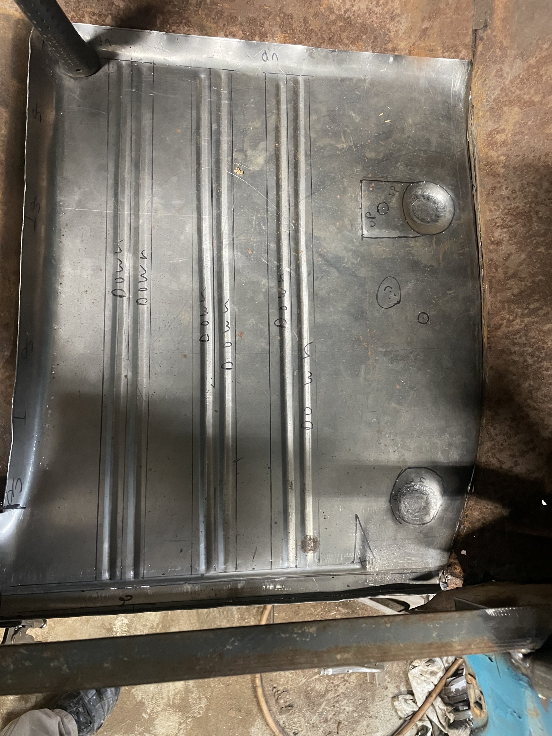

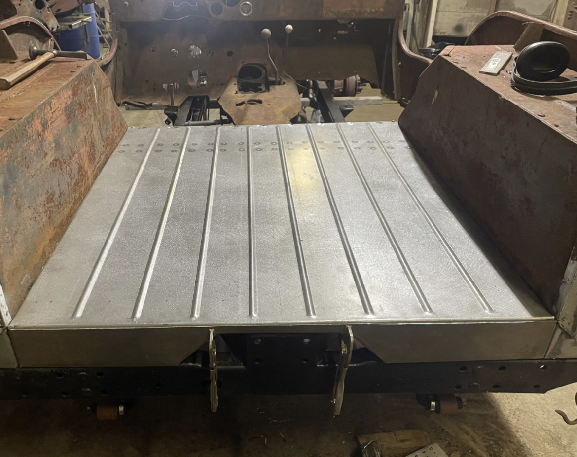

    Here's one I built, I took out the big wheel well for the spare tire because the customer wanted it gone and a flat floor instead.
    The only exotic tool was a harbor freight bead roller that I stiffened up.
    I even built the little filler panel in front of the main floor section.... here's a couple pics...

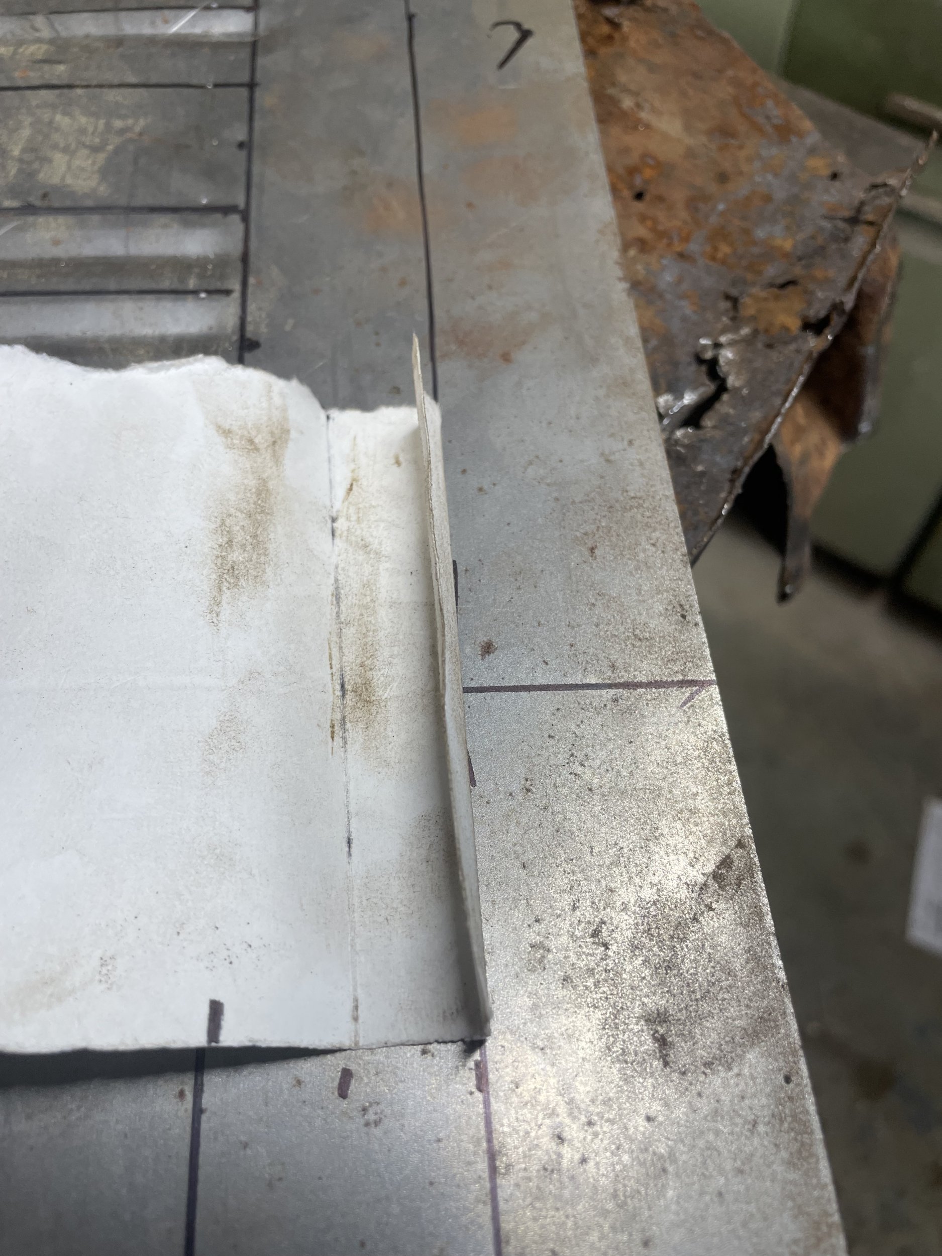

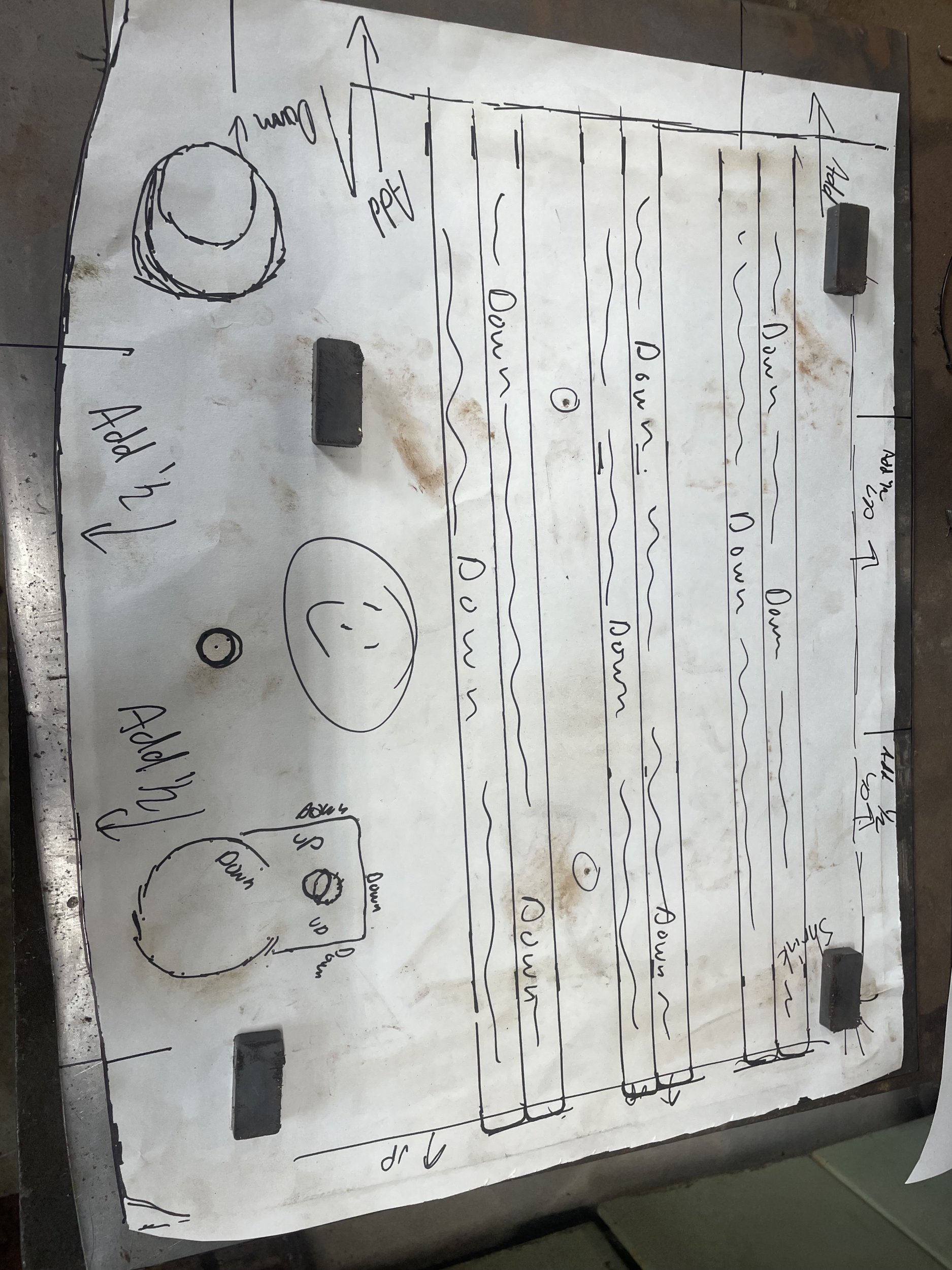

    make an accurate template.
    I use magnets to hold the poster board in place. Make reference marks on the template that line up with marks the car.
    Lay the template on sheet metal. I use the magnets to hold it and transfer the reference marks. Use a spring loaded lunch to transfer detail from the template.
    Start making parts

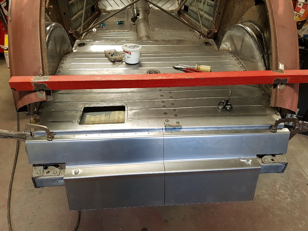

  12. It seems that the much modified and referred to Harbor Freight bead roller has been discontinued...but you can still pick up a version through Amazon (and others no doubt) for a bit more than a couple hundred dollars. This is likely way cheaper than finding someone willing to take on the task for you at a shop rate. It's pretty straight forward. cut your panel slightly oversized, determine what pattern you want to roll in, mark, bead roll, test fit, cut to proper size and weld in. It looks like the toughest part of the job (the tool tray) is already in good shape. Don't worry about not having done it before...after doing this one, you'll have done it.
    Below are a few photos from my build thread on our cabriolet...it was in far worse condition than yours...but piece by piece it comes together.
    Good luck and happy building.
    20200229_163337_resized.jpg 20200323_144635_resized.jpg 20200327_161806_resized.jpg

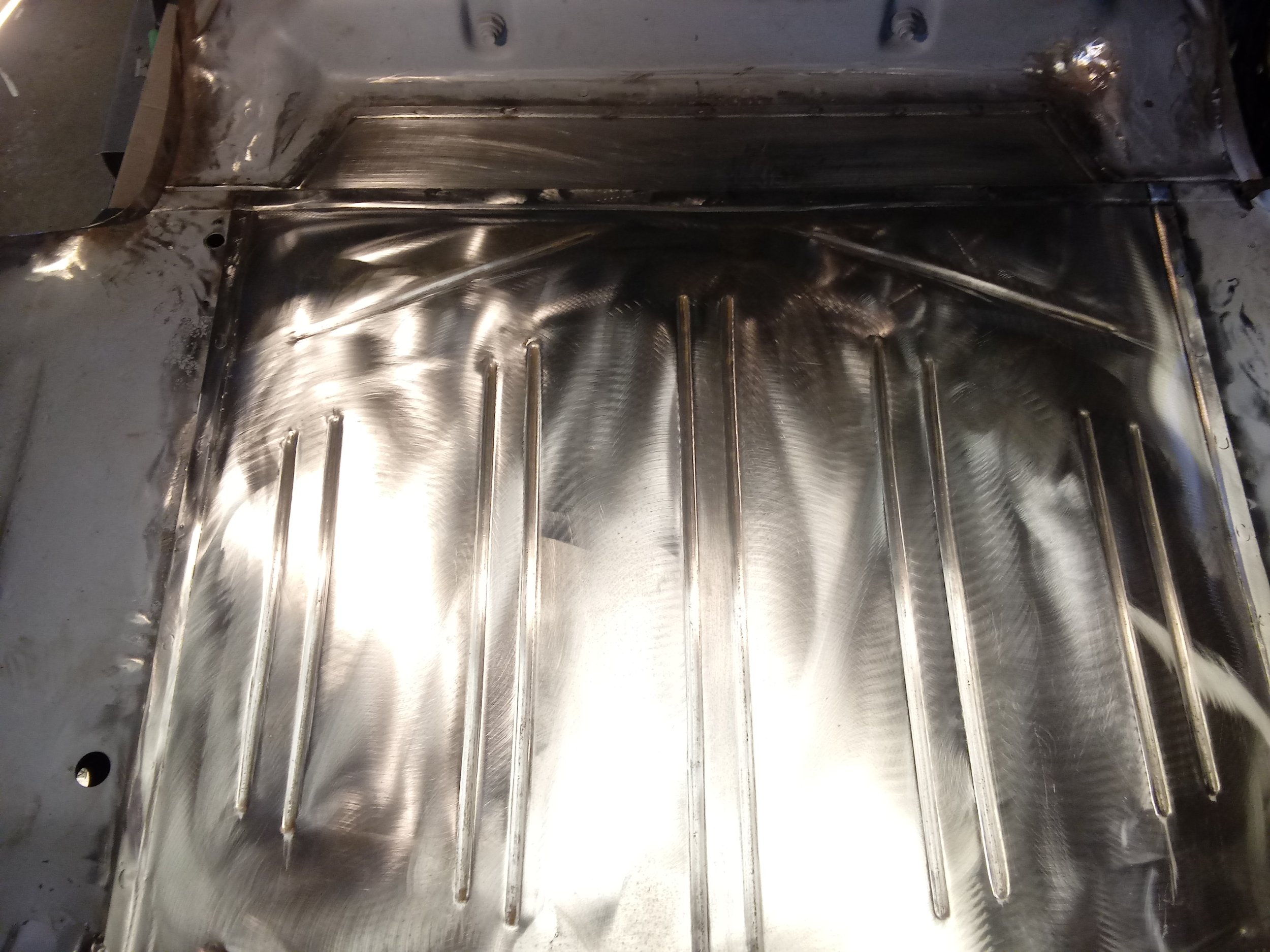

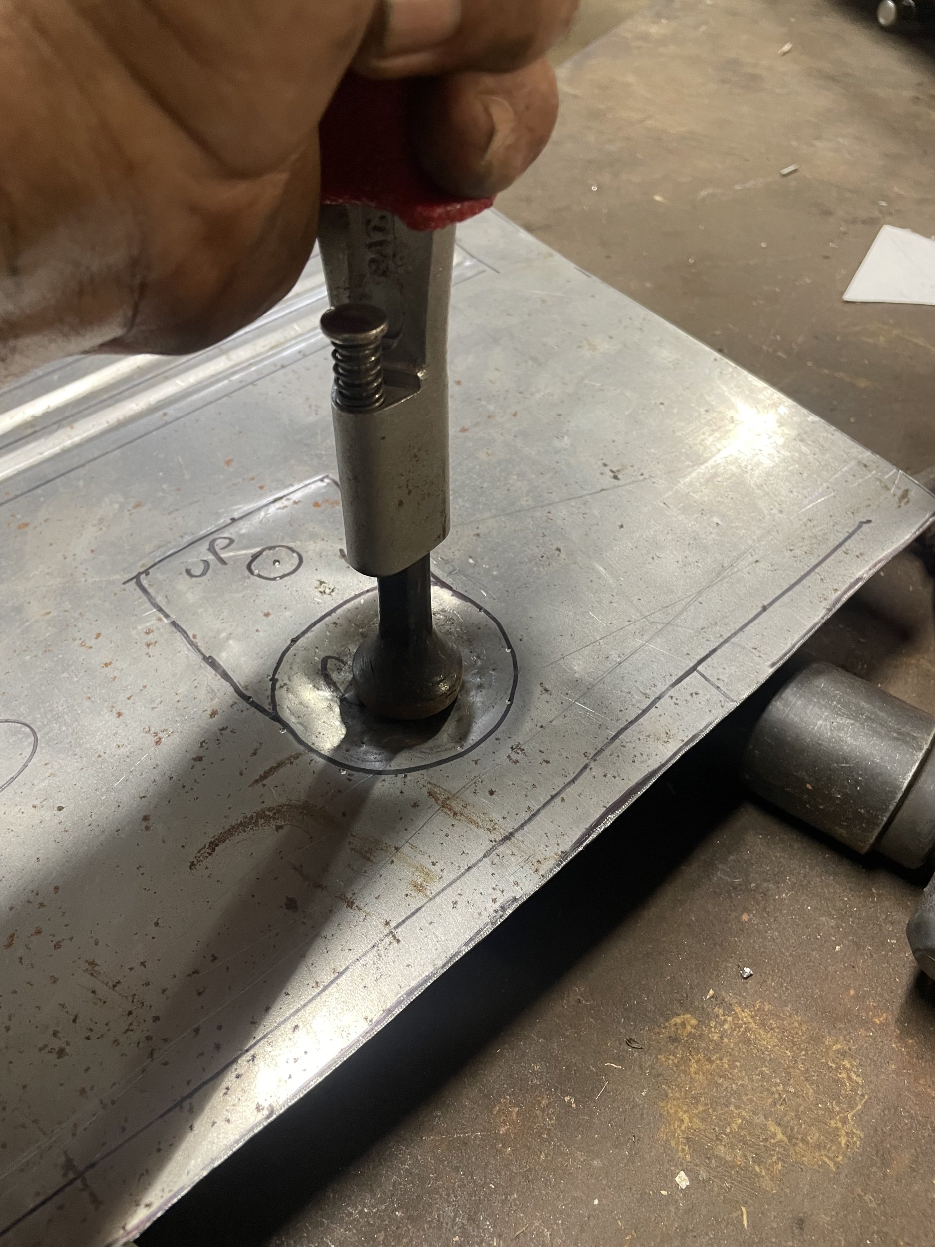

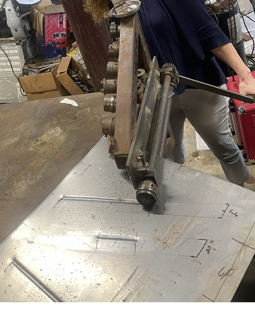

  13. Modified HF roller. Jegs, summit, Amazon, Eastwood sell the same thing. It’s **** u til you modify it.
    the wife rolling while I guide.
    Also made on that offshore junky roller
    make a pattern
    transfer over to steel
    start rolling and banging

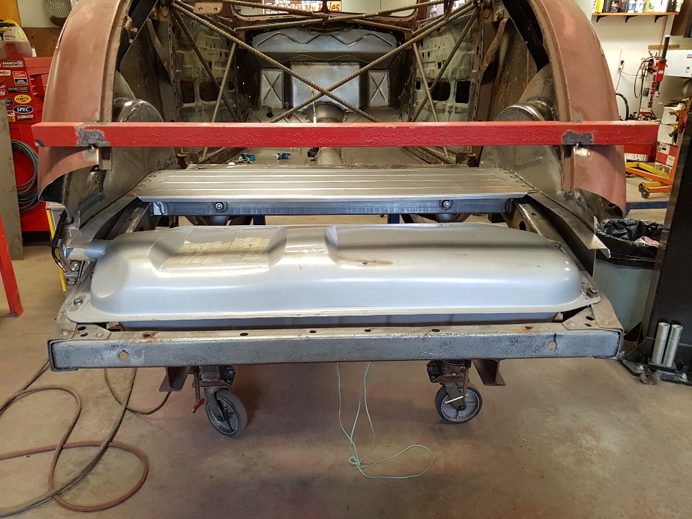

    If you haven't fixed the old gas tank yet, nor started w/the replacement flooring, you might consider an early('64-ish -> '66 at least) mustang fuel tank. The top of the tank doubled as a trunk floor. TANKS repops them. It might just fit in the trunk-hole & solve 2 problems at once. Moving the brace wouldn't be a big deal.
