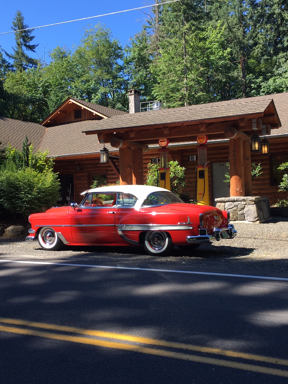

    Hey guys I’m trying to make up my mind on what to do with my 54. I have a zero mile rebuilt 283 I’m thinking of putting in. Really nice motor camel hump heads, forged pistons Duntov cam. Etc. I’m also considering a 261 swap. I was thinking about running a Saginaw 3 speed overdrive behind either engine. Then converting to an open driveline. Or if I go with a 261 maybe keep the trans and reared stock. What are your opinions? [​IMG][​IMG]

    Please note my great restraint in mentioning your ''accessories'' ... seldom did hopped up Chevrolets wear jewelry.

    nice looking car, what is wrong with the motor you have now?

    The stock trans will hold up to a 261? The accessories were on it when I bought it. It’s a work in progress. Most of the gingerbread will be gone.

    by the way nice car. 261 warmed up a bit would be cool.

    Plus your car is such a looker, a nicely done 6 would set it off even more....the way your stance is.

    I've got a 235 - 6 with a 3sp+od, 70-75 mph all day long. I have a 261 waiting in the wings for my '49 1/2 ton. PS, that 235, 20 years over 100 k miles, dd/only vehicle. You pop the hood and you'll get admiration for doing the right thing...yes, 283-350's are a couple of the finest engines made along with the mighty Stovebolt 6!
