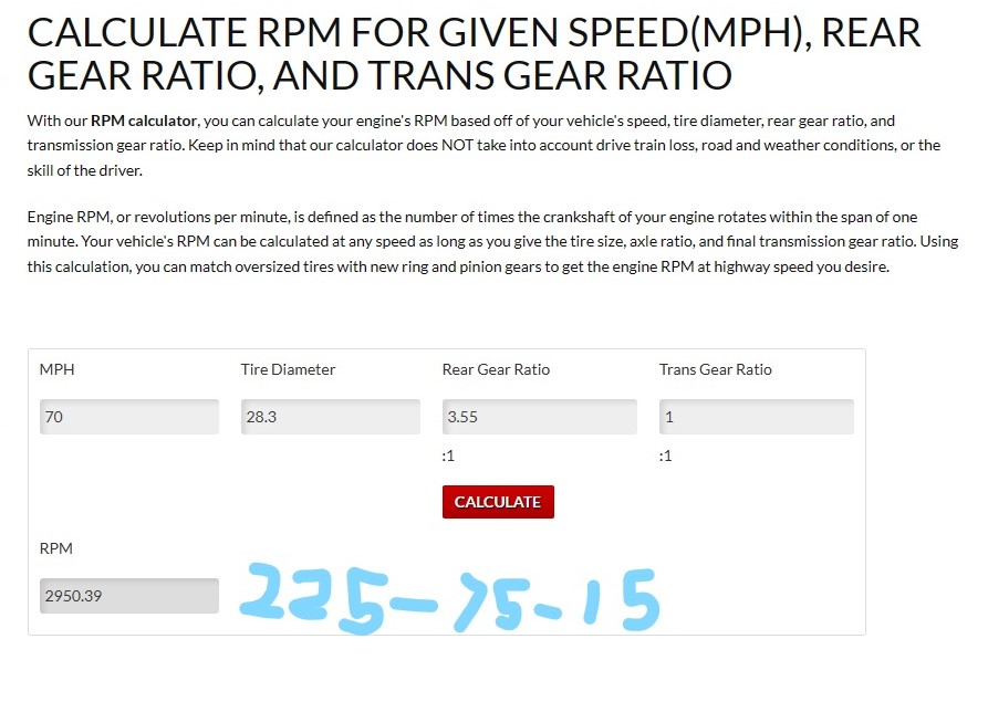

    Screenshot (2379).jpg Screenshot (2374).jpg Screenshot (2379).jpg [I just played with a calculator plugging in the possible specs for my 48 that I am putting the 292 chebby six in. 292 six, Novak adapter, AX-15 5 speed (with 51 granny shift handle) and a nine inch with 3.55 gears.
    Comparing 215-75-15 tires that are 27.7 inchs tall and 225-75-15 that are 28.3. With 1 to 1 trans ration and .79 to one trans ratio. All at 70.
    Using :
    Calculate RPM for Given Speed(MPH), Rear Gear Ratio, and Trans Gear Ratio (purperformance.com)
    Tire comparison calculator
    Tire Size Comparison
    Bias letter tire size diameters for 50/60 and 70 series
    Tire Sizes and Dimensions (plain text version) (pontiacserver.com)
    Don't beat up on me for odd numbers in the calculations. Screenshot (2379).jpg Screenshot (2375).jpg Screenshot (2374).jpg Screenshot (2379).jpg
    View attachment 5824567 View attachment 5824568 Screenshot (2374).jpg Screenshot (2379).jpg
