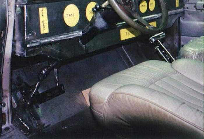

    A way to get around where the column comes out is to shorten the column so that it ends in the cab. Then you have the first u-joint in the cab. I don't have any other pictures than this to show. I did this to a COE I had back in the late 90's

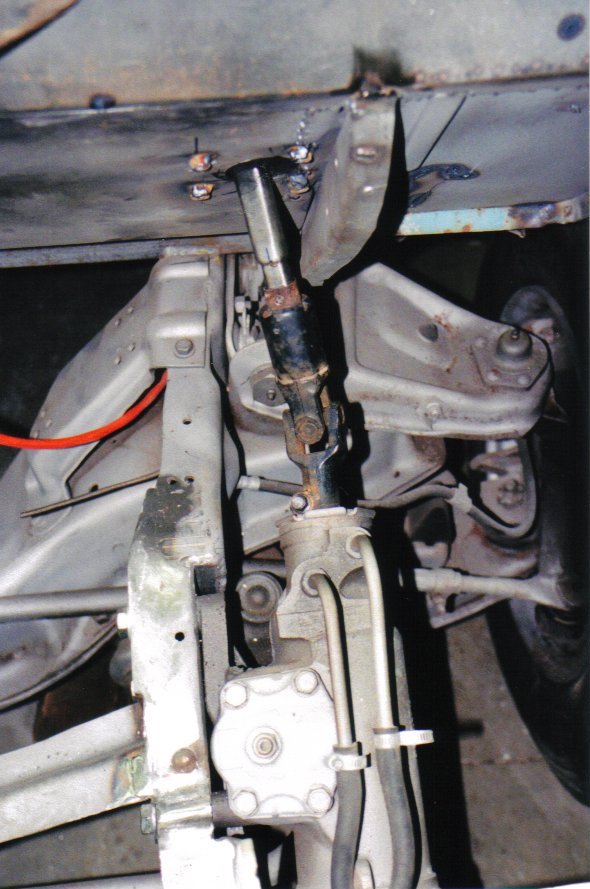

    The '53 era cabs are not tilt - here's a couple scans of some of many photos I still have from the early '90's build. Showing the '73 heavy half rear frame being grafted on. And the '73 front suspension attached to the orignal COE frame.

  22. Thank you for the photos, photos speak louder than words. I printed them.
    Looking at the first photo, your frame was modified for the steering box. Other than that everything looks just like my suspension. So my box is just a little more to the left on my frame. Or to the right in the photo. So if the shaft also swivels in side the cab, you must have a boot, like a floor sifter boot inside to keep the draft out? I wish you had a few photos of your whole tilt design.
    Were is your sub frame located under your body, & were does it hinge, down at the frame? Also, what did you use in the rear for it to sit on & latch to? Did you use a ready made system or design your tilt system? I probably have to many questions for you since you are the first response that has done a tilt cab so far.

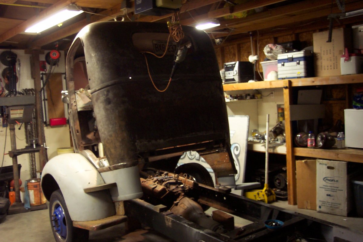

  28. My truck is a big one off project that has been going on for a few years now. Right now my cab is off once more, more body work getting done. Here are photos of the P30 frame, with the 1989 corvette motor & trans. It's air bagged, 4 bags in the rear.
    With the motor still under the cab, My running boards are 2" off the ground & I still have the original floor.
    Do you have your steering column in? I'm still looking for the right column & shaft that will work with the cab tilting. Also, have you installed your master cylinder & brake peddle?
