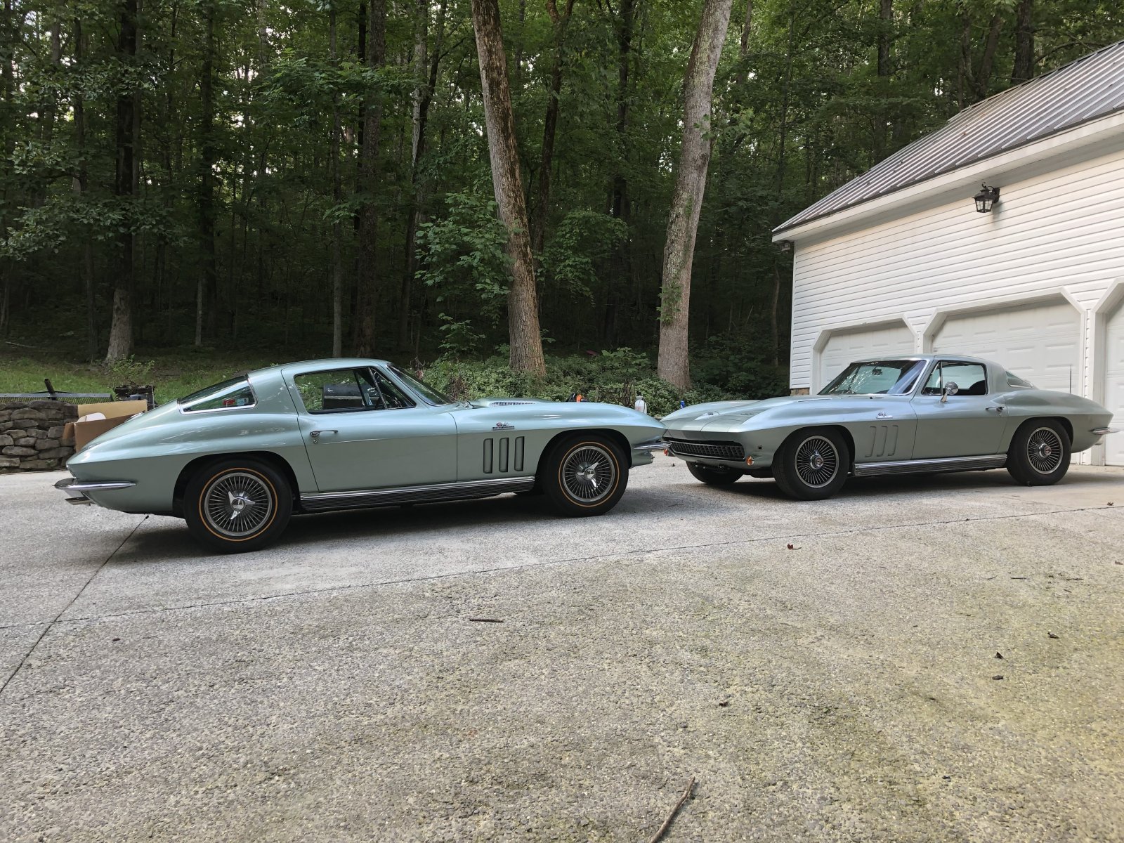

    04585F9C-D1F0-4E07-974D-C9DBA08FD499.jpeg Car on right is lacquer, left is base clear.
