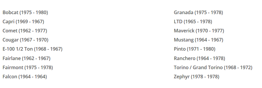

  7. Mike Miller
    Joined: Oct 13, 2008
    Posts: 4,556
    Mike Miller
  8. stillrunners
    Joined: Aug 27, 2009
    Posts: 10,578
    stillrunners
    from dallas
    Looks like a 66/67 Fairlane........and the good kind of 8"..........a little stronger web I believe.....

    That one does have the re-enforced webbing carrier which is the more desirable. After you open it up just divide the ring gear tooth count by the pinion tooth count to calculate the ratio. Cool that it already has the 4-bar brackets on it as well. Great for a daily light weight car being much lighter than a 9". Everything is readily available for them with a good range of ring & pinion ratios. That chart that Mike Miller put up will give you a good indication of where it originated.

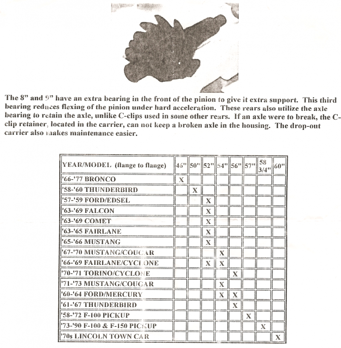

  27. nobby
    Joined: Jan 8, 2006
    Posts: 1,358
    nobby
    if the longer half shaft is 29 3/4'' flange to spline end
    its from a 71 72 73 maverick
    74 75 76 same length, bigger drum register
    total 56 .5
    if 3/8 longer than 29 3/4 - to equal 57 1/4 total, its mustang
    those drums are for 10 by 1 3/4'' shoes
    so you need Bendix back plates with the number
    319480/1
    you need the shoe separator bars with the little h plates and the springs
    also the park brake arms
