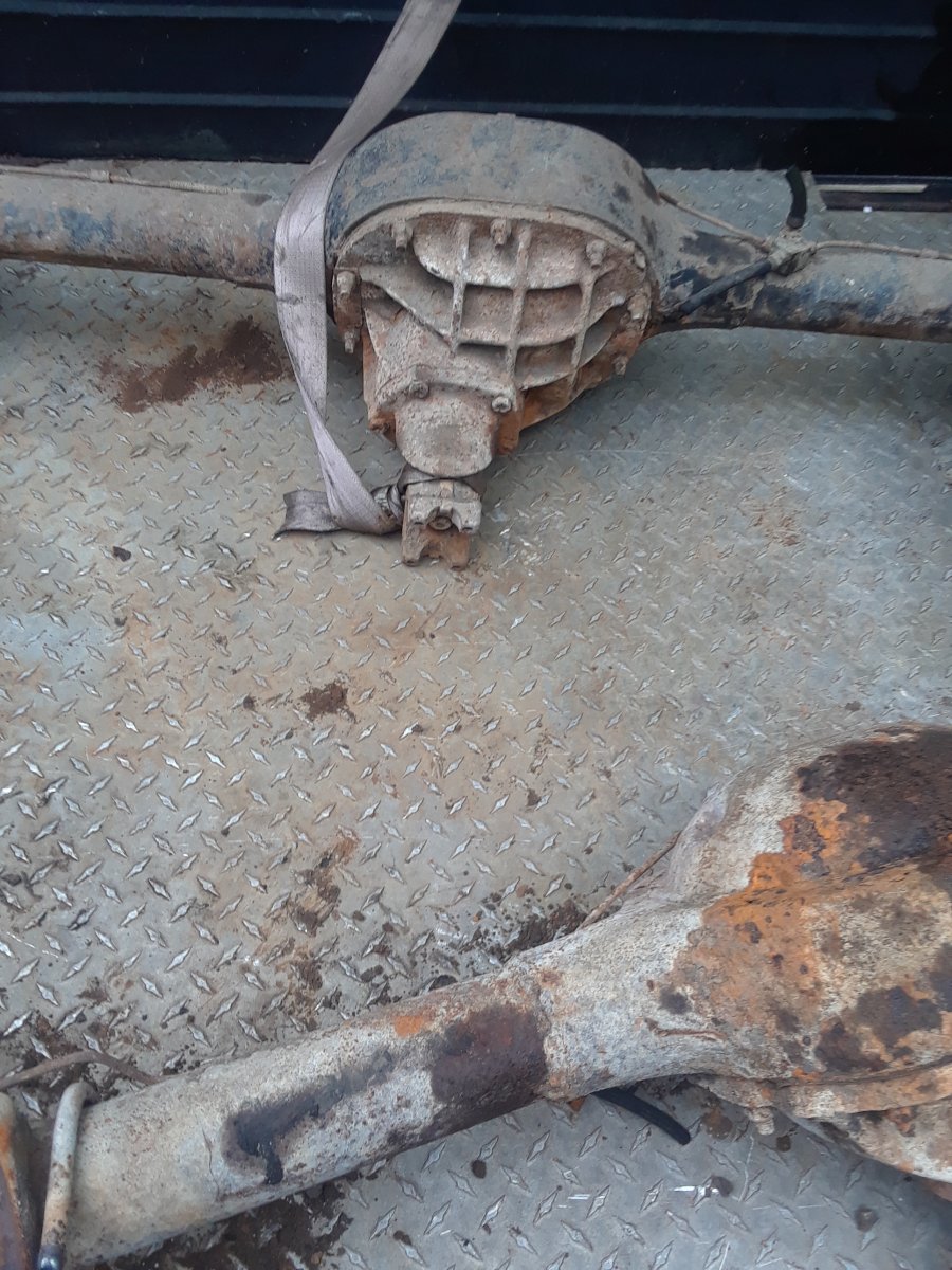

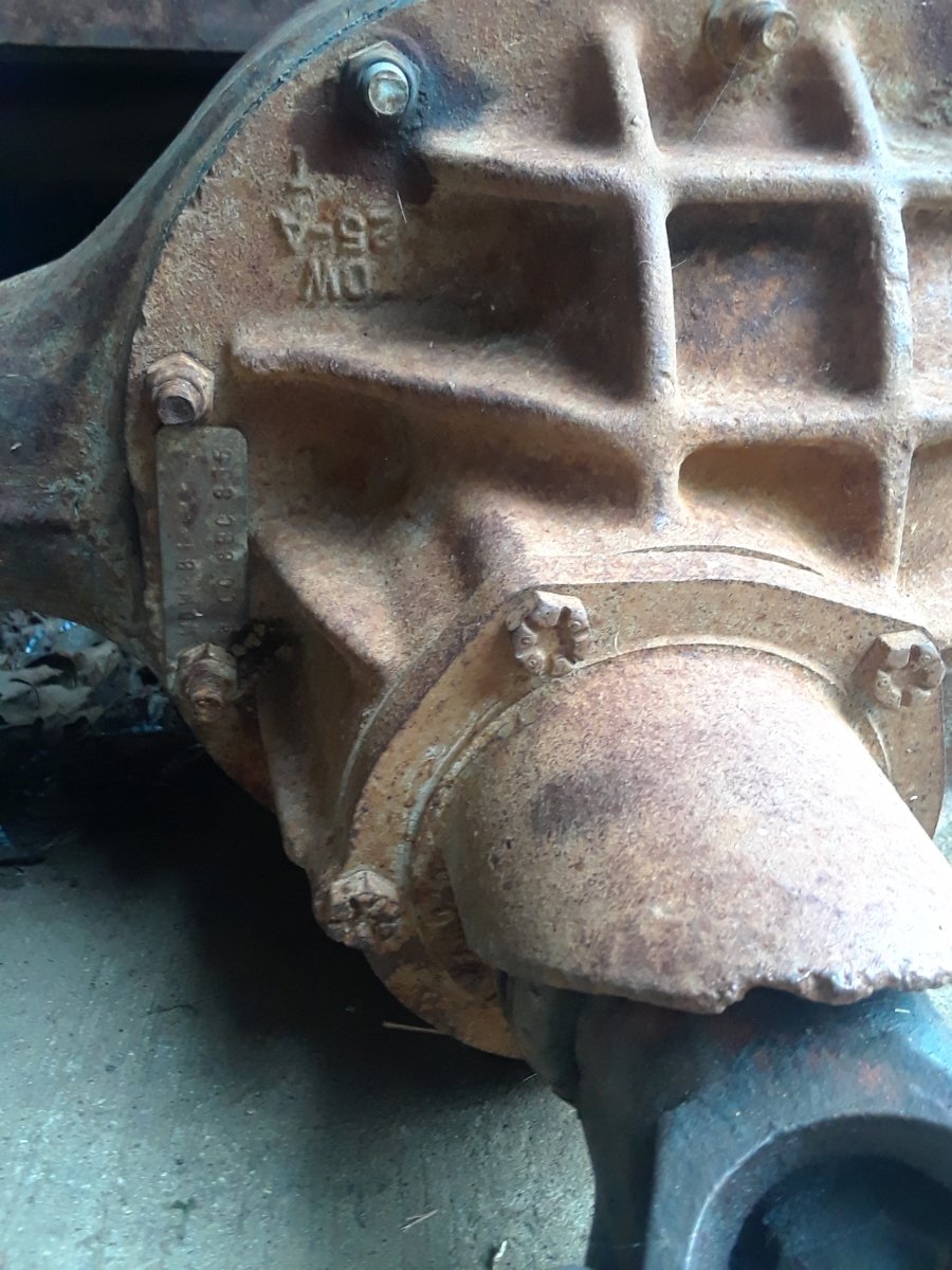

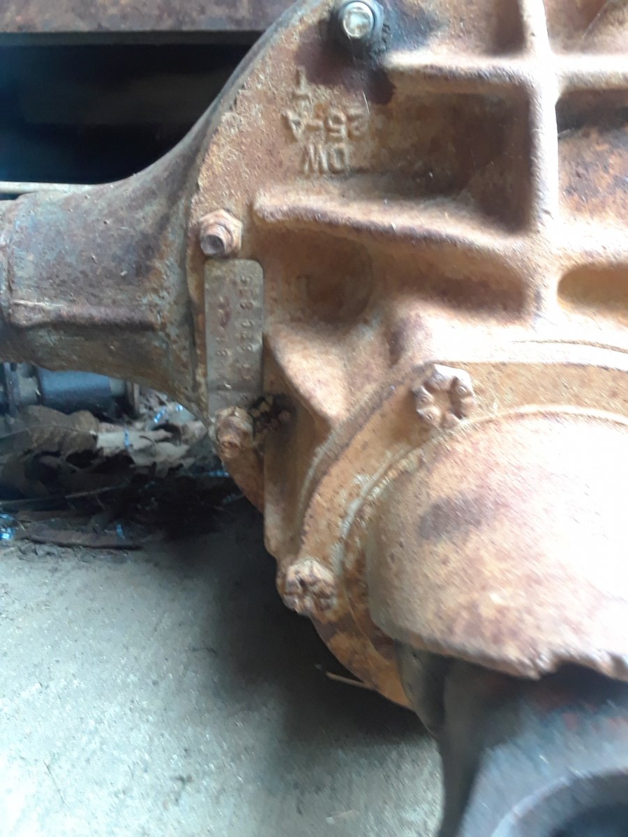

    Since my compressor has quit working and I am not able to sand blast them in the cabinet I am trying to figure out how best to clean up the rusty axles, Before I got the rear end the axles had been pulled and for some unknown reason by the previous owner and left both of them outside but stored the axle housing inside.
    The axle & the splines have a lot of surface rust and I don't want to damage anything by installing them in the housing, I was going to do this to try and figure out what ratio I have.
    Know any back yard way of cleaning up the splines without sandblasting? HRP

    Early 8" 3rd's were fewer webbing,but 390 Fairlane would be 9",usually the rule of thumb was any v8 engine 351 ci or larger got 9" or 9 3/8" rear smaller got 8" rear there are exceptions but the large majority follow this pattern,high performance cars typically were some of the exceptions.
