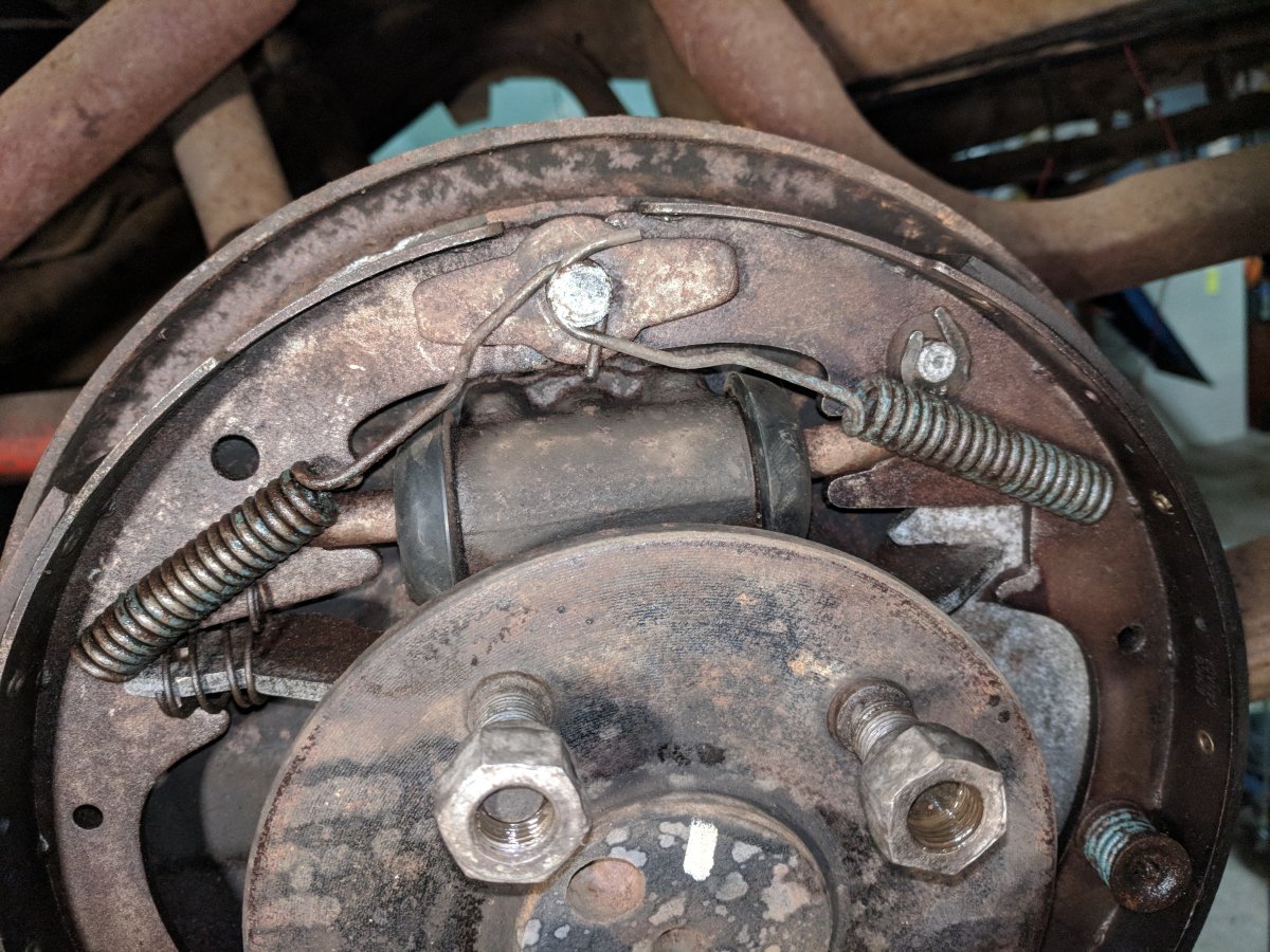

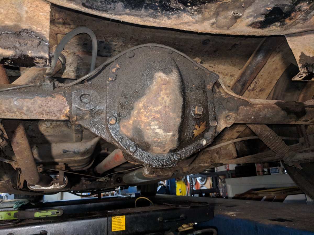

    I'm working on old 59-60 build that started out as a 55 Crown Vic. I'm pretty sure the 10 bolt rear in it is not Fomoco. It has a bolt pattern like a Dana 25/30 series. I found a casting number 18419 on the housing. I'm enclosing photos of the unit and what the brakes look like. I'd like to identify a year range-probably Mopar if I determine that's what I got-to get some brake hardware etc. Would you all agree it is not a Ford rear end? Thanks for any help

    S****e the **** off the center housing, look for a cast number like 40 or 44 or 44-1 or something. Either on the top/front behind the pinion yoke, or on the bottom web below where the axle tubes go into the center casting.
    It's probably a Dana/****er, and that number will be the model.
    What's the wheel bolt pattern?

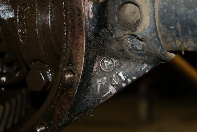

    Looks to be a Dana 41,Ford used them in 1949-56 F-1 Ford Trucks and 1952-54 Ford station wagons the 1955-56 Ford wagons went to the Dana 44. Look for this code. 1-oops.jpg

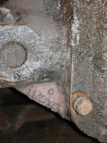

    Here is casting number I mentioned-I Found 18419 stamped in housing-can one ***ume the '41' refers to Dana 41

    you're looking for a 2 digit number. Keep hunting.

    Thanks to all that helped me out. found the Dana 44 markings on it. It appears to be of 55-56 Ford era and brakes are 1.75 in. -Sedan variety not wagon. I'm on my way to a brake job with proper parts.
