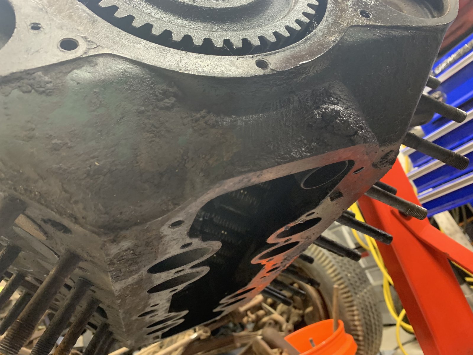

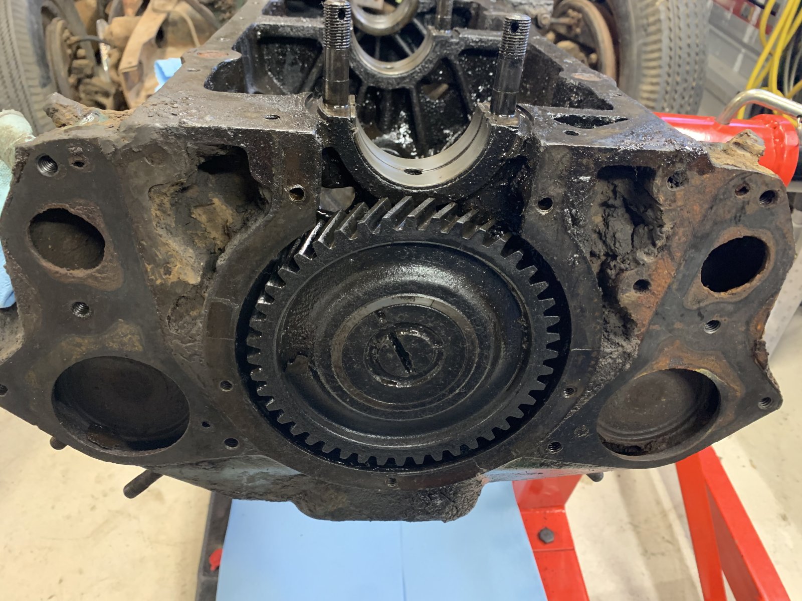

    I just took my two cranks to the shop. While there I looked for numbers on the bell housing. There are none. Does this tell you anything?
  24. rusty valley
    Joined: Oct 25, 2014
    Posts: 4,351
    rusty valley
    @'34 Ratrod 59a was the ford ID for the block series. 59 ab referes to the heads. Early heads were one side only design, and marked a or b with the part number on the head. Later, the 59ab heads will fit either side, and are marked 59ab.

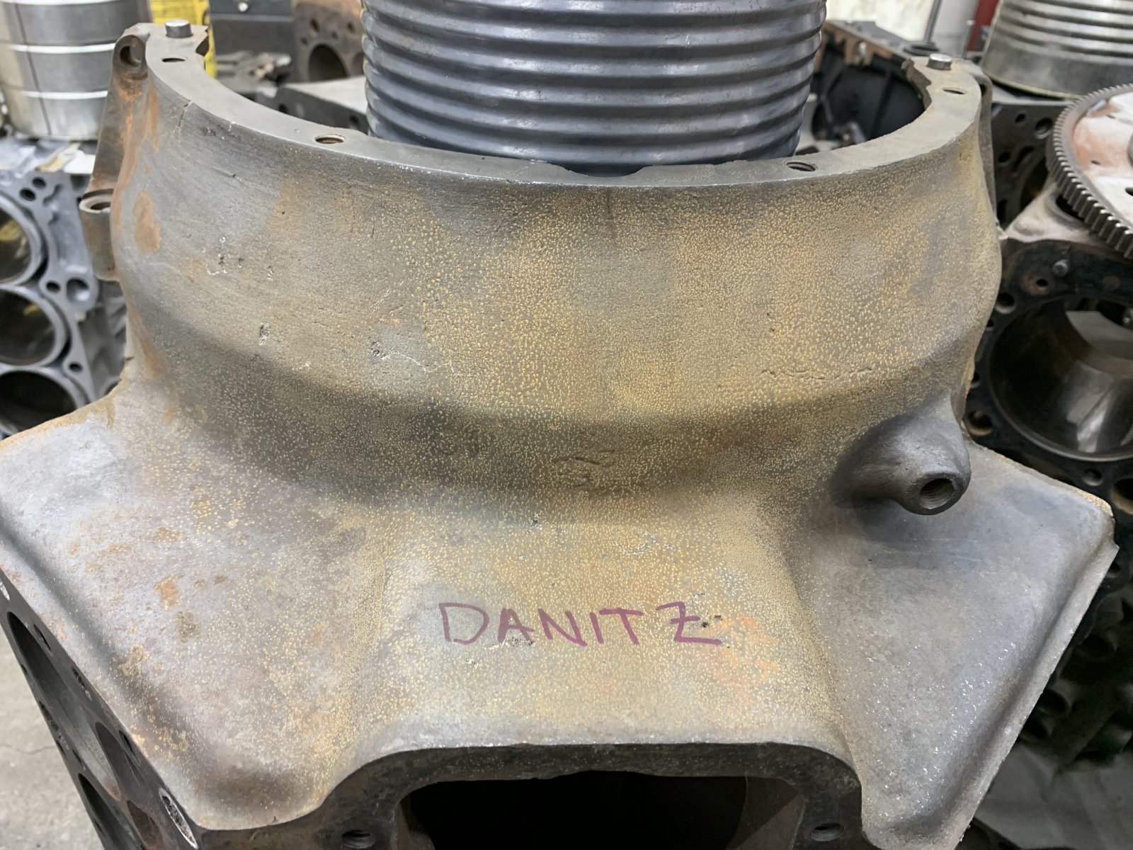

    Bus man, show us the front of the block to see if it p***es the pencil test
  26. Busmania
    Joined: Oct 16, 2022
    Posts: 193
    Busmania
    from Denver
    Yes, I believe it p***es the pencil test. Also has the Welch plugs under the oil pan.

    Nope. Every '40 Ford block I've had did not have 81A on it. Some had a smaller group of uninterpretable numbers up closer to the valley on the bellhousing, but none have had a big 81 anywhere on them.
  29. banjorear
    Joined: Jul 30, 2004
    Posts: 4,831
    banjorear
    Came here to say this. In all my years messing with these lumps, I've only come across one of these blocks. I was totally stoked to find a good 59AB. Took the heads off and was like what the heck? Found the small, 3 1/16th bore that can only be bored out to 3 3/16ths max. It also had the 59AB casting loud and proud on back top of the bell.
    Turns out these were some odd ball replacement engine sold after WWII for pre-war cars. Makes zero sense why in the world they did this when a 239 would be nice upgrade to the 221. Really odd.
