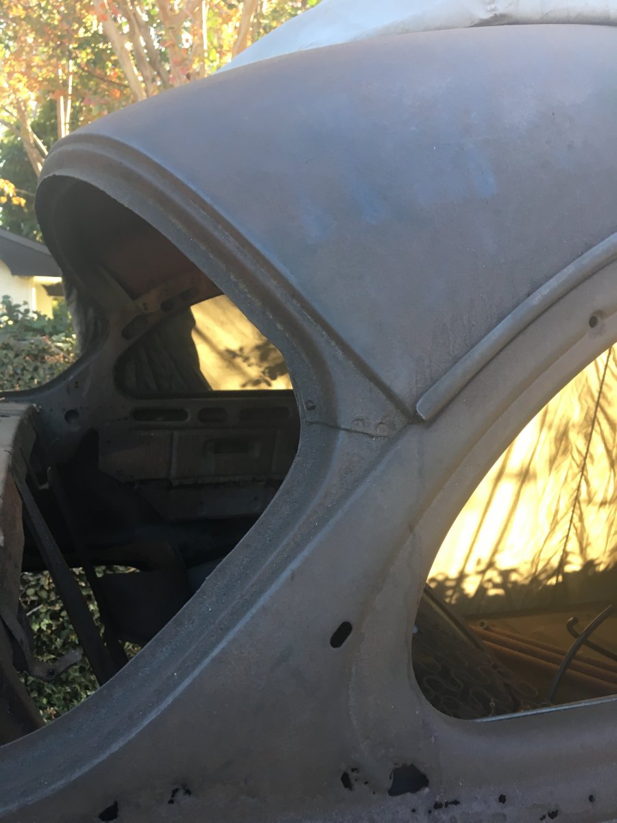

    Hey everyone,
    I bought this car yesterday and am pretty excited to start on it BUT, the rear window is f’d on the chop; sits too far below/in the drip rail. I would love to hear some advice/suggestions on how to salvage this roof. My intent is to make this car useable for video/photo shoots. [​IMG][​IMG][​IMG]

    You can't cut that gl***, so it has to go somewhere. I'd think there is no other solution for the sides overhanging unless you use a different gl***. Like the guys said above, using smaller windows would be my favorite. Like a 50 Chevy rear gl***.
  8. 56don
    Joined: Dec 11, 2005
    Posts: 10,333
    56don
    Just eliminate the drip rail. Lots of customs do that.

  11. The drop rails are gone.
    The belt line is looking sad.
    The rear window wrap around part looks strange when it's lined up with the quarter windows. Angles are off.
    And like you stated the back gl*** is recessed what looks like a mile !!!
    Also why is the window frame squared off when the gl*** has rounded corners?
    Don't mean to put the car down as the rest looks good but you can see where there skill level fell off the rails .
    50 Chevy rear gl*** or even 49-50 merc rear gl*** would be much easier to work into the chop with much cleaner results.
    And it's my preference only but put the drip rails back on I think it looks better and less of a pain if you are caught in the rain

    Have you confirmed the rear gl*** has not been cut (by tracing the gl*** onto a large sheet of butcher paper then folding it in half?
    In all honesty, when looking at the pic taken from the rear in your lead post, I believe the lower p***enger rear window corner looks considerably lower on the tulip panel than the driver's side. I placed a straight edge on my monitor and it looks way off/out of level. The body bead line that runs under the rear gl*** is considerably off: it's much thinner under the right hand side. In fact, the very first photo in your lead post shows there's almost no bead. It looks very "soft" and thick with bondo. I'd bet someone welded everything up without taking close measurements, then troweled on a ton of bond (over unground gumball welds) to try to make things "fit". Look how badly shaped the beltline reveals under the quarter windows look and the reveal above the quarter windows. The C pillars are probably thick with filler. The door frames don't fit the roof. You have some serious grinding and rewelding to make things right. How do the welds look on the roof skin and pillars from inside the car. Lap welded or **** welded?

    I’m thinking a different gl*** is needed for sure. I wish I could use this wrap around but like stated, I think it’s too late for that. I may also slope the roof a bit more to flow better with the 1/4 windows...you can really notice that when looking at the full side shot

    With all of that filler, and the poor window fit, you might as well take it back to metal and see what else needs to be fixed. Before working on that rear window. As mentioned the side view angles do not match. I don't understand why the square corners on the rear? Did they use a different car window, maybe even a front windshield???? You may even need to get a new roof with the rear window section to fix it. As suggested, a smaller window would make it easier.

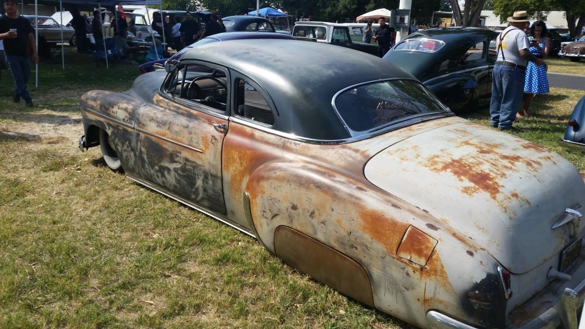

  16. gimpyshotrods
    Joined: May 20, 2009
    Posts: 24,525
    gimpyshotrods
    Take it down to bare metal.
    Whenever I see pink filler, I shudder. Pink filler is often Bondo brand filler, which I would not use to fill a dent in a dumpster.
    If the "builder" would not even spring for good quality filler, more is likely wrong.
    As has been mentioned, I'd look for a 150 window and surround, or a whole surround and window, that has not been messed with.

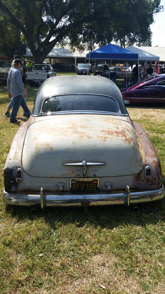

    I like the look of Fosters ‘54 and I think that’s a ‘50 rear window. Let the search begin

  21. gimpyshotrods
    Posts: 24,525
    gimpyshotrods
    In the pictures I posted, that is a cut-down (new gl***) '50 Styleline rear window.
    I built the ch***is on that car. Tony Parker did the chop.
    Stogy and Nailhead A-V8 like this.

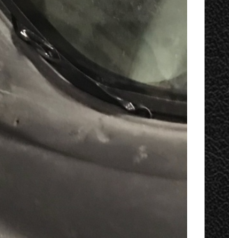

    The bottom of the frame is crooked in relationship to the body. The p***enger side lower corner is sunken into the beltline.
  23. punkabilly1306
    Joined: Aug 22, 2005
    Posts: 2,655
    punkabilly1306
    from ohio
    Right, I would need to cut out the window as it sits now and reposition it properly. Yes?
  24. gimpyshotrods
    Posts: 24,525
    gimpyshotrods
    Yes, but you need to make sure that the rest of the frame was never cut. If the plan is to lay the gl*** forward in a chop, the entire gl*** frame is cut free, and moved.
    If the frame was cut apart, you have a bigger headache. Fixable, but will need careful planning, measuring, cutting, and welding.
