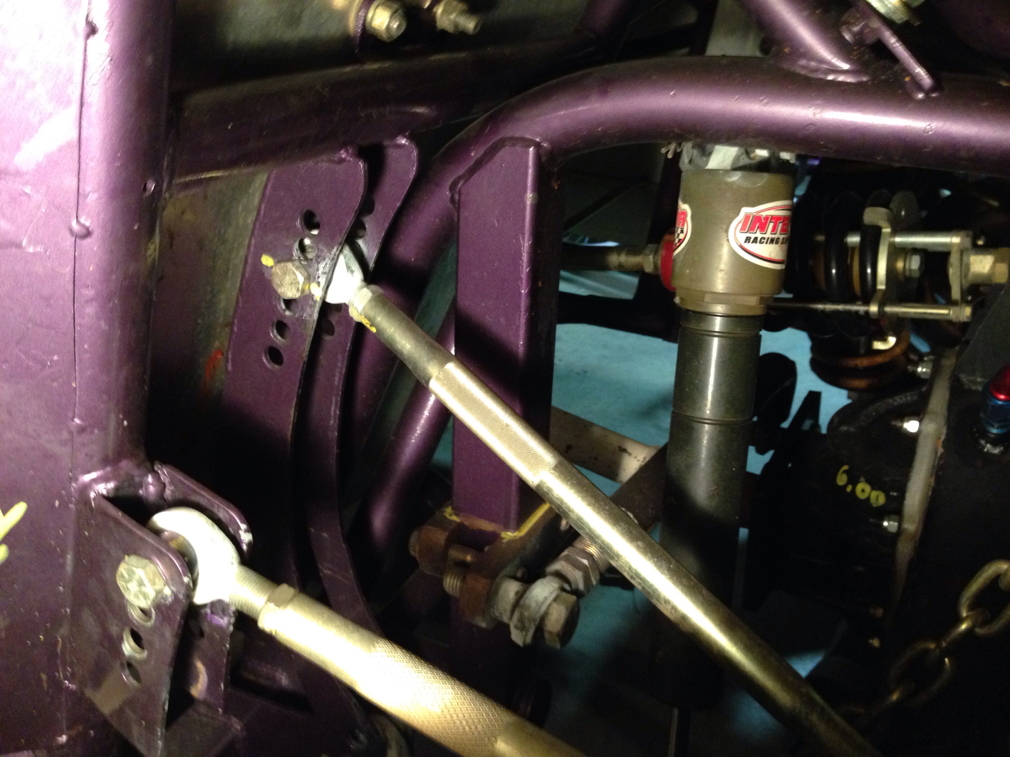

    OK, got my panhard bar move up just above the pumpkin, roll center up about 5 inches from where it was. Then I got sidetracked installing a parking brake on the pinion, something I've been wanting to do for a long time. So far in my highly scientific testing, dong 1st gear figure 8s, it does have less body roll. Haven't hit any bumps yet.
    I've been trying to install a front sway bar (Corvair IFS, highly modified) for some time but haven't been able to find the wiggle room, that would help too I'm sure. The one thing that might work is to clamp one to the strut rods, dunno if that's ever been done or if it would work. That would be the lower bar in this photo
    Nothing on this heap is ever easy...

    Me too, on my coil overs I have 5 sets of holes on the top cross member to adjust stiffness, another 5 vertical on the bottom mounts for ride height and another similar set for the panhard bar. I've been under there so many times I should put a pillow down. I'd snap a picture but it's embarr***ingly ugly, haven't gotten around to painting any of it.
