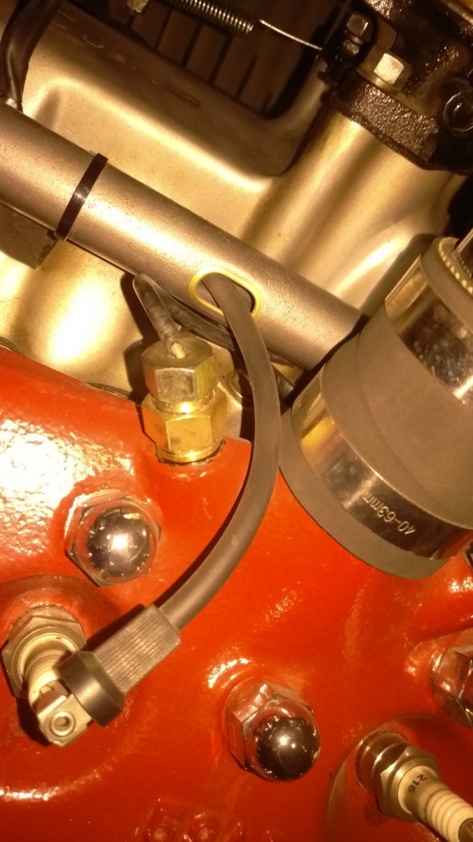

    Here's my set up. Came with the S/W gauge I got from speedway.

    I got the proper one from Jegs.
    The head should be 3/8 NPT (a tapered and threaded hole)
    Maybe someone "modified" it or overtighted and then rethreaded it at some point.
    The senders I got were two wire so I didnt have to worry about the grounding at the threads so I could use teflon if needed.
    Something like this I think....
    https://www.jegs.com/i/Longacre-Racing/441/46150/10002/-1
