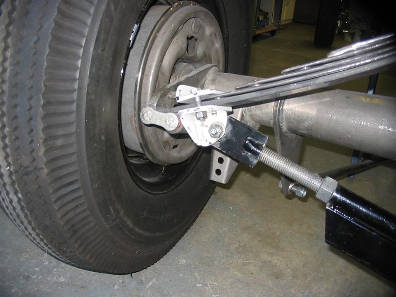

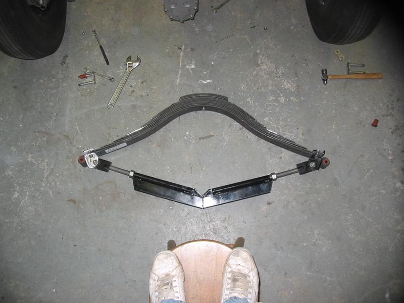

  10. Or build a spring spreader, it's easy and safer when dismantling a A rear spring.
    akoutlaw, patmanta and lothiandon1940 like this.
