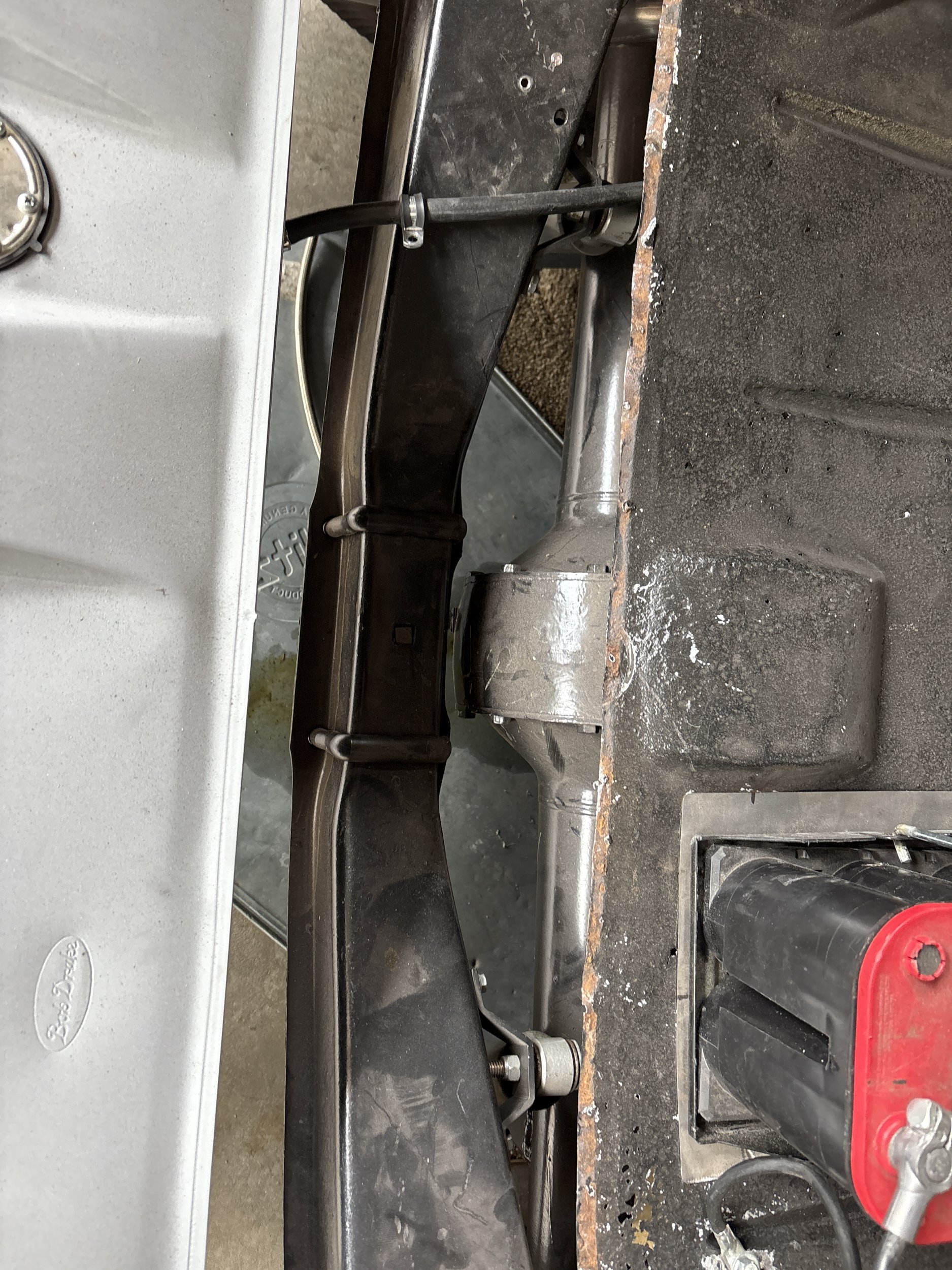

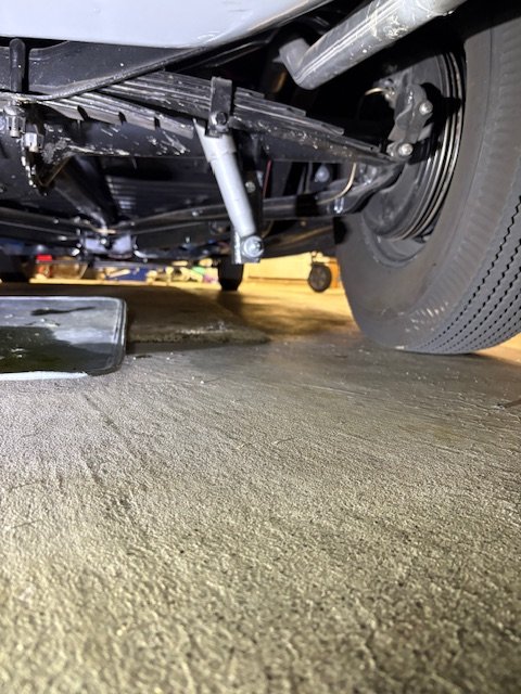

    My lowered 40 rides like ****. To be expected no doubt but I think I can make it better. The back is the worst!
    I have a posies front lowering kit and rear spring/shock kit. I don’t think my shocks have ANY travel making the ride really bad when I hit certain numbs. Makes me cringe every time. It seems as though I need to make the shock travel longer? Any tips for how to do that? Here’s pictures of my set up.
    when I push down on the back of the car, I get zero movement but I can lift it up and get movement.

    Sounds like your shocks are too long, looks like there is another set of holes below where they are bolted on on the bottom. Move them to those holes and report back. It may not be enough but it is worth a try

    this looks like a shock that is fully compressed and at its limit, you need shorter shocks or move it to the lower hole, although that will not be enough....also looks like a bunch of leaves were removed from the top of the spring and put back in under for spacers so the u bolts would still "clamp"

    Like moriarty said, likely the shocks are too long if no down travel but you can lift it up.
    I’m surprised those upper shock mounts haven’t broken off.

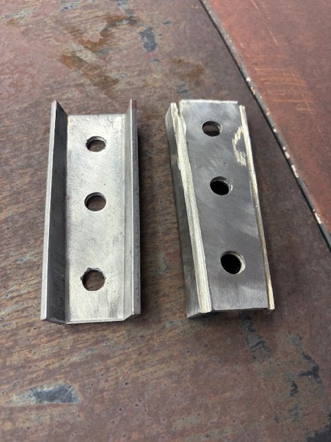

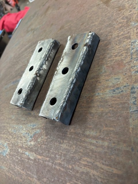

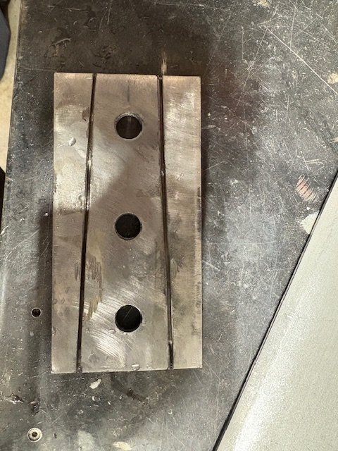

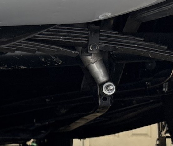

    Did some investigating and experimenting. The shocks as they were definitely were riding completely collapsed. Upon removal, the car did not drop any more but they were at their fully compressed state. No good. After some measurements, the shocks had about 5.5” of travel.
    I didn’t want to spend much on this so I made some brackets with some 3” flat bar. Holy ****, it’s like a new car. I’ve been putting this off for 18 months and it was such a simple fix.
    In my area, most major intersections go from asphalt to concrete. Where the asphalt meets the concrete, it was always a bone chilling bump. Now it just glides over as it should. Like a 97 2nd Silverado, I spose…
    Here’s the brackets I made. I will now take them off and clean them up and make them look good.

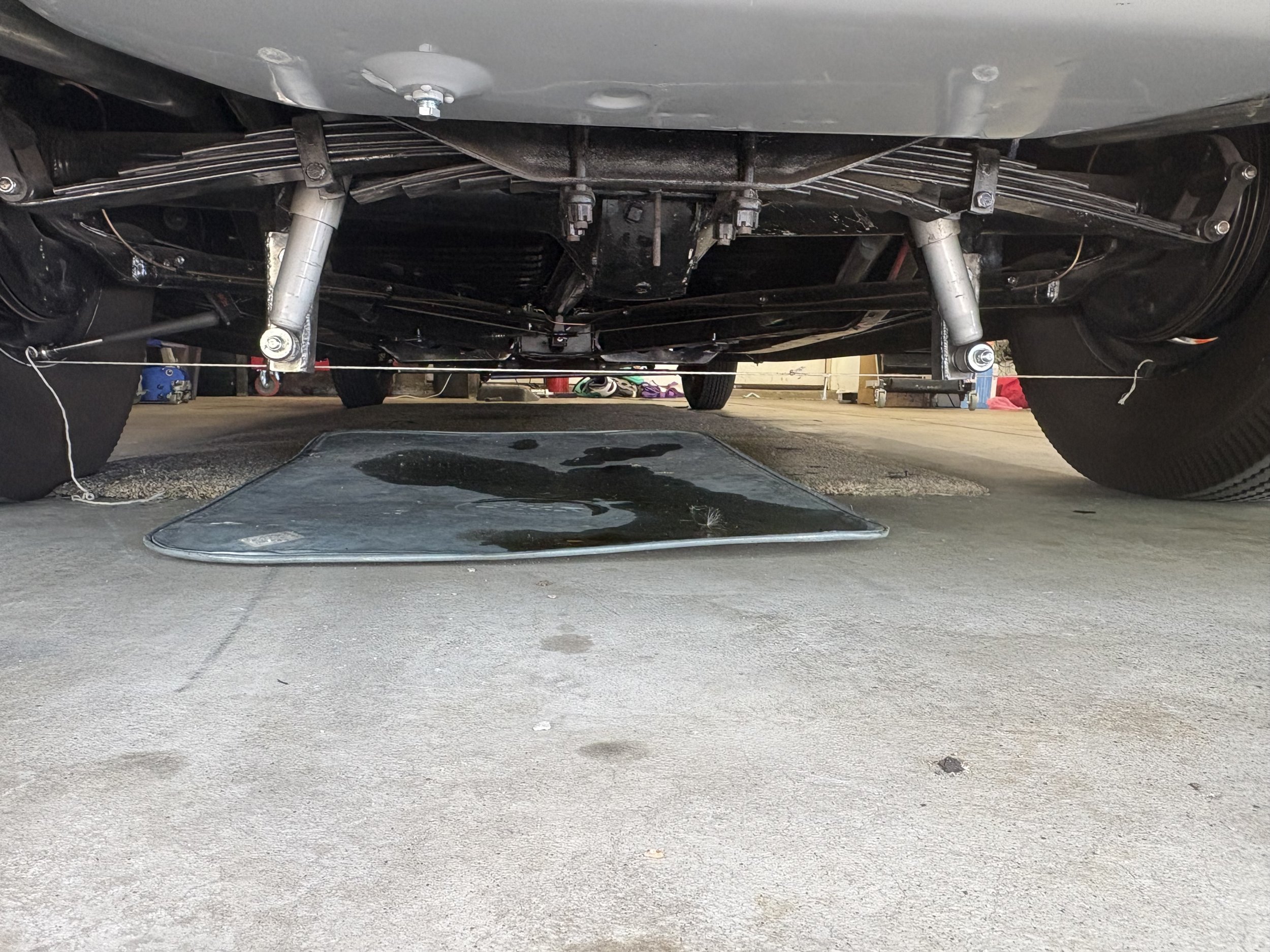

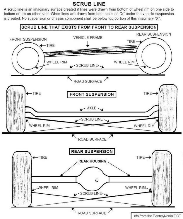

    Is the bottom of the shock below the scrub line?
    325w, Happydaze and pprather like this.
  24. pprather
    Joined: Jan 10, 2007
    Posts: 9,081
    pprather
    If rear tire goes flat, will shock bracket hit the pavement?
    Scrub line as suggested above.

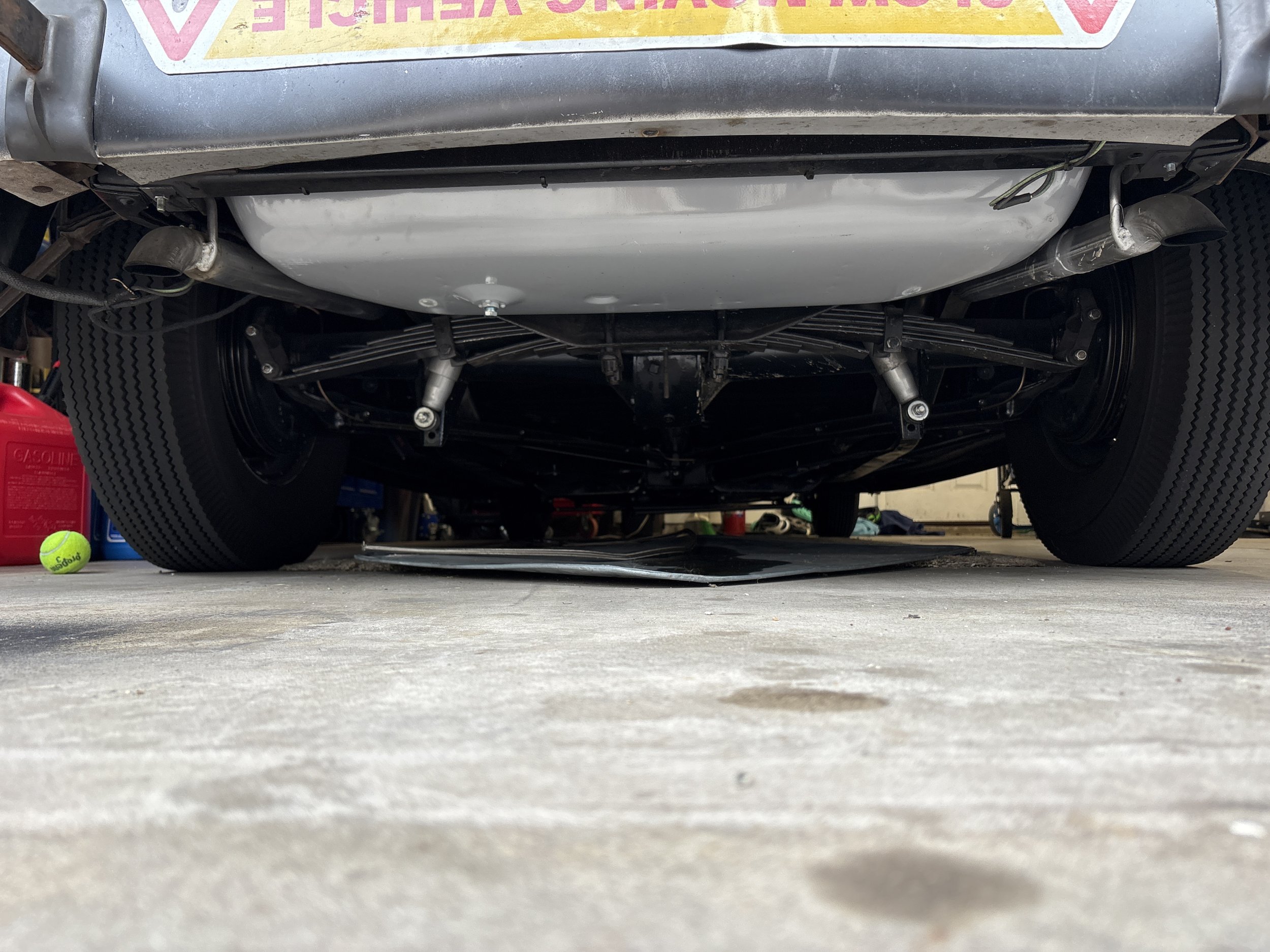

  26. Busmania
    Joined: Oct 16, 2022
    Posts: 193
    Busmania
    from Denver
    Alright. I took some magnets and a string to check clearance. The bottom of the bracket are basically dead even with the bottom of the rim. Too close for comfort? I still have about 1/4 - 1/2” of metal to grind off the bottom of the brackets to clean them up. That will give me say 1/2” clearance, if I ever completely lose a tire.
    Went for another drive. I can’t believe how good it drives now. I’m in disbelief that such a small change can make such a difference (though I totally understand they why behind it…)
    dana barlow, PONTNAK123 and pprather like this.
