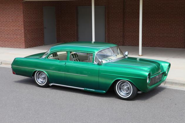

    yup, it is this car, it has been that way since 1964..... astorianchadly2.jpg
