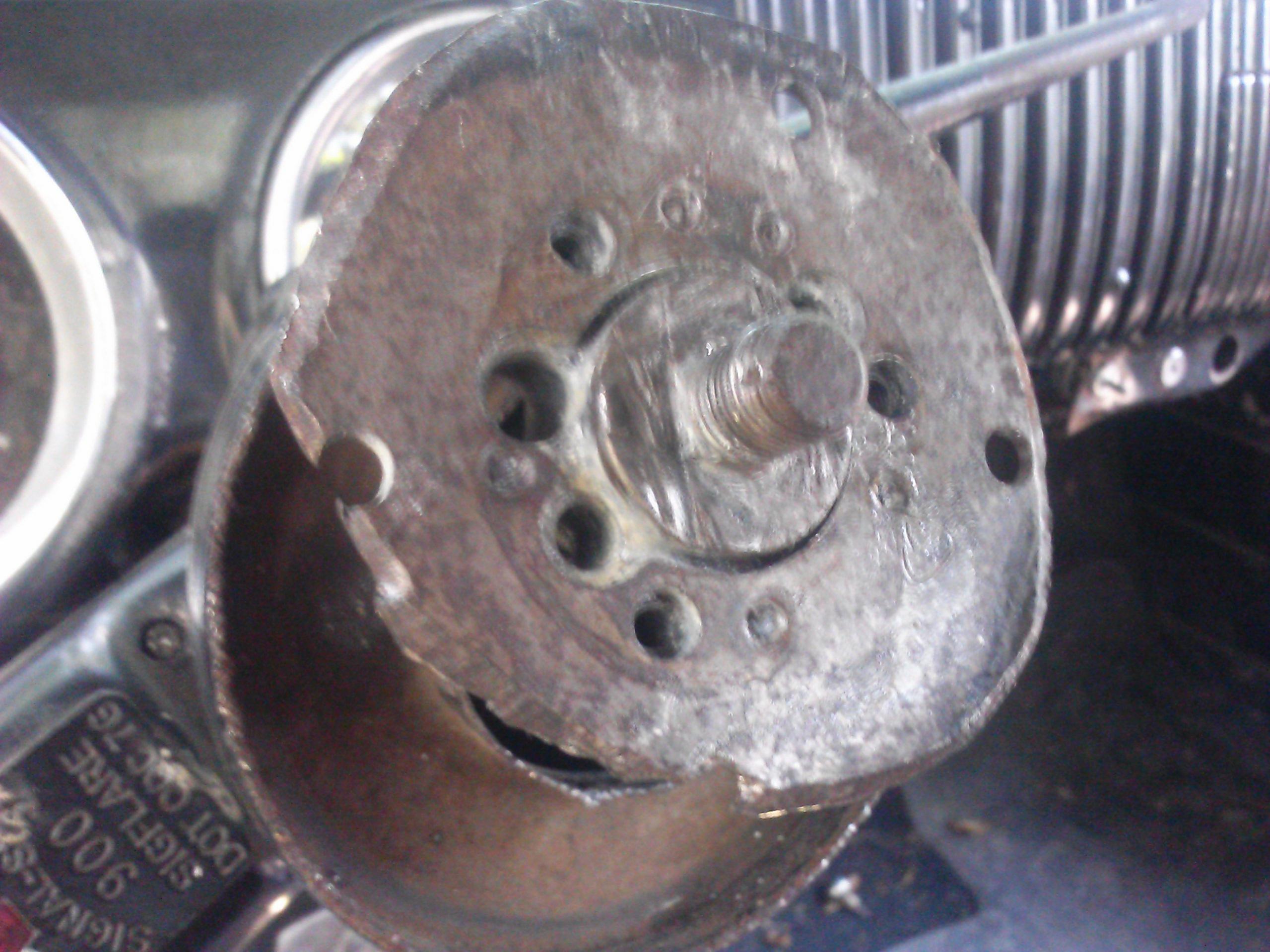

    Folks, I have a '54 Chevy p/u with a really ugly after-market steering wheel. I bought an original wheel which was in pretty good shape. Then I removed the after-market wheel. That was easy. But then I came across a plate that someone had ground down to an odd shape. The after-market wheel was screwed in to that. Underneath it, resting on the steering column, is the original collar that fit on the factory steering wheel.
    That plate has to come off, but I am stymied. Does this call for a gear puller? I am ready to get one but wanted to solicit opinions first. Please see the photos.

    I would try a wheel puller first. Looking as good as I can through old mans eyes, it looks like the very center maybe welded to the steering shaft. So I'd use a puller and watch it for bending the outer plate and not giving around the shaft. You may have to heat the center up with torches but being careful not to cause heat damage to the bearings and whatever else maybe in the area. Good Luck.

  4. Holy ****! What a mess that plate is .
    I'd start with a standard steering wheel puller.
    You may need to drill and tap new holes in that plate for the puller to work.
    Look well for a weld around that shaft, if it is welded you can cut it with a hole saw that will just fit over the threaded shaft. The shaft will act as a guide so you can remove the center pilot drill, the hole saw will stay centered and cut the weld

    Not sure it was welded, but it does look like there is some solder/brazing there.

    what a hatchet job---makes you wonder how some people survive--use a gear puller slowly--maybe a little heat &it should come apart . If its screwed beyond repair , it would be a good time for a little later model column
  7. Looks like somebody cut the center out of a stock wheel, then butchered it into a 'adaptor'. You might be looking for a new column....

    That looks welded which it should not be and any amount of pulling will not remove that. I think your best shot is to get a Dremmel or even a hack saw and cut that thing like a pie. The welds can be broken by moving the cut piece back and forth till it breaks. Once the pieces are off, file smooth whatever remains.

  12. Well, it can't hurt to try a puller on it.
    Harbor Freight makes a wheel puller kit that's pretty slick, I've used mine dozens of times now. Either it will pop off easy, or it won't.
    The next step is to see how ugly it is with it off, and decide if you can put a stock wheel back on there.

    Once you get that mess off you are still going to have to deal with the column as it appears that the top bushing/bearing is out or severely damaged too. Looking at that again it may be that what I was looking at was the back side of the hub of the stock steering wheel that got knocked off the hub.
    You might want to chase what threads are left and run a nut on the end of the shaft so the puller doesn't damage it any more than it already is.

    There are two holes 180 degrees apart that are threaded 1/4 " fine thread. a standard steering wheel puller will pull that hub and expose the original set up.

    I put a wheel puller on that torn-up plate yesterday. I applied penetrant and pressure. Nothing. I tightened it some more. That plate did not budge. I will work on it some more this weekend, trying some of the tactics you guys suggested.

    Take a 4" cut off wheel and cut in until you reach the shaft use puller or slice both sides and whack it with a BFH.

    I will try cutting the wheel this weekend. My efforts with a wheel puller did not work. BFH is ready.
