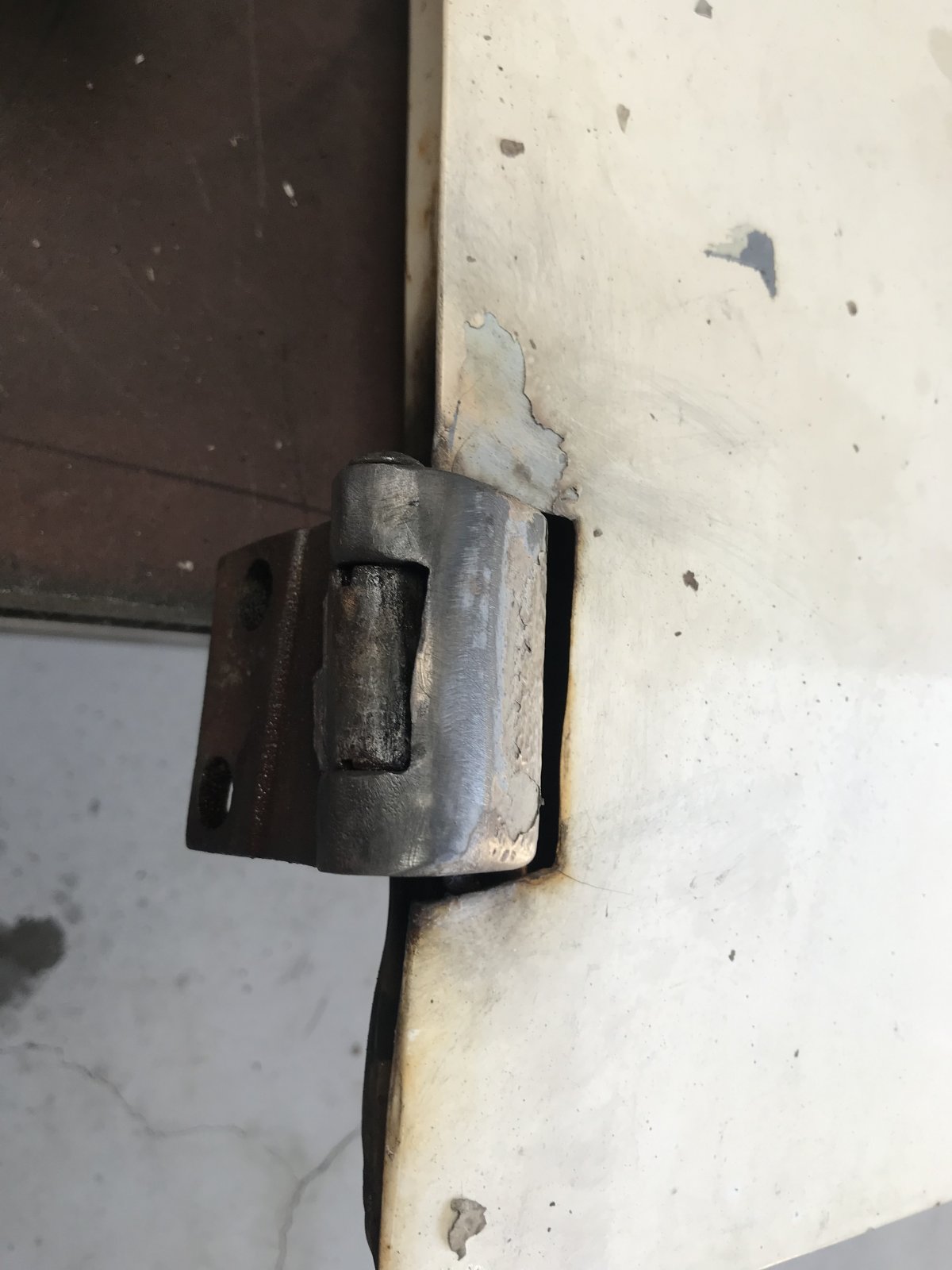

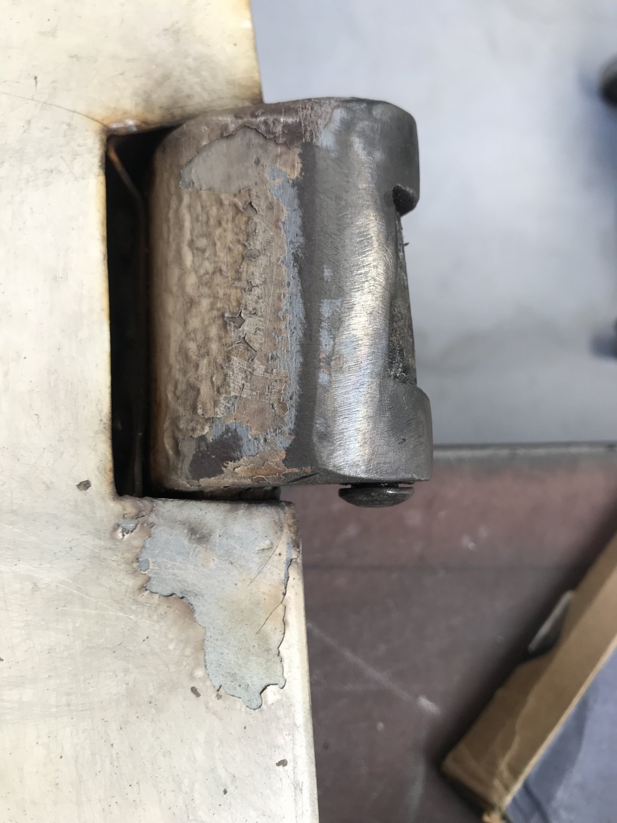

    Any advice or tricks would be appreciated…. I am trying to remove a hinge pin from a 62 econoline door with no success so far. I have a hinge pin press from Bob drake and have tried heat and partially drilling out the center to no avail… any ideas would be appreciated. Thanks 0154ADC7-243E-45AB-9621-548254E172E6.jpeg EFCA6C4F-0F2C-4448-87CB-81905561BEE9.jpeg

  2. Are you going to replace the hinge? If so, cut the pin with a grinder. If you want to rescue the hinge, did you heat it cherry red hot?

    Yes I need to save the hinge

    I see grind marks on that hinge. Has it been welded on too? Looks to have suffered some carnage. Maybe the pin is stuck from something besides just rust.
  7. Might just be an illusion, but in the first picture it looks like the pin is bent.

    Perhaps drill both ends of the pin out as large as you can without getting into the hinge
    Only drill a bit past the hinge area on top and bottom
    Cut a section out of the pin in the middle
    lLghtly drive a wedge or such between the cut out area of the pin
    Pushing the top out and the bottom down
    The pressure will be less on 2 pins than the pin as a whole
    The pin looks swollen from corrosion
    My experiences with such are that the forces to remove are greater
    If the hinge ID bcomes damaged from drilling the pin or corrosion, ream or hone and use an oversize pin

    That's the nice way of saying you have a hell of a mess on your hands. The hinges look bent like a dog's hind leg. You want to fix that, remove them off the unit. Once off, straighten them to align the hinge parts and the pin will most likely come out then. I doubt you can fix that with a door attached and most likely will damage more then you fix by trying.

    believe it or not that hinge is not bent... the bad thing about the econoline hinge is that they are rivited or swedged to the door side so the hinge is not easily removable from the door side. thanks so far for the tips that have been givin.

    Cutting the head off and driving the pin out in reverse is doable, if it's drilled down past the locking splines. Sometimes the splines are locked into the hinge really tight and can be the one thing that's making removing the pins tuff.
    I've done lots of hinges and have had good luck using the pin tool. I set the tool up, put some tension on it, then smack the end of the tension screw with a br*** hammer. Keep repeating this and the pin will eventually start to move. If it won't work cold I use heat and keep at it.
    Tip: Tape up some cardboard around the hinge to keep from gouging sheet metal. Good luck!

  16. It looks like the pin is REALLY worn and off center, meaning you'll play hell trying to get it to line up while you're extracting it. I'd vote for using a thin cutoff wheel or hacksaw to cut the pin on both sides, then fishing out the pieces. Might have to drill the remnants out.
