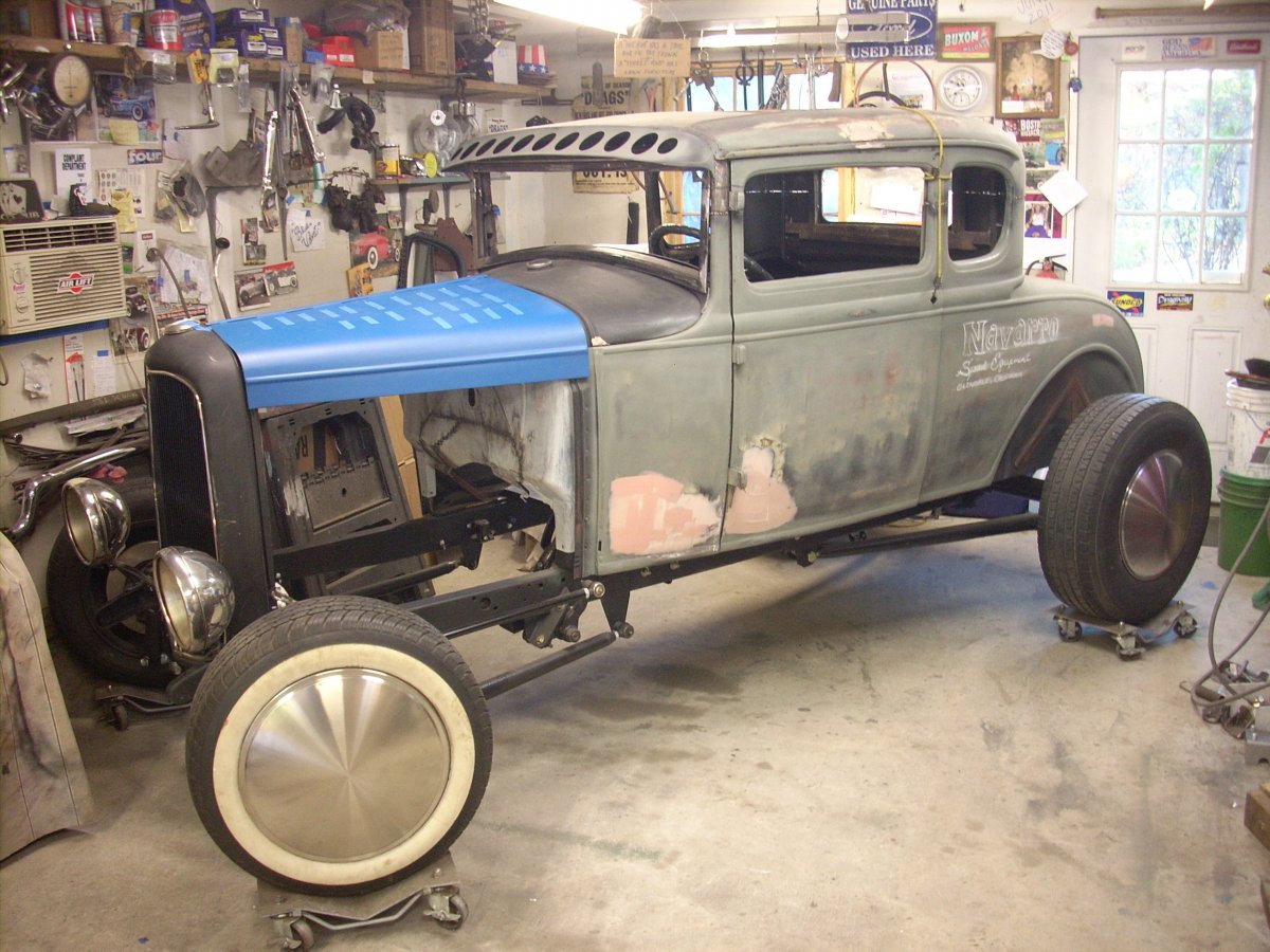

    So here goes.. I'm looking for a general "rule" of how much, if at all, to lower a 32 grill shell in relation to a model a body. My particular case is a 28 roadster, on a model a frame, using the wood body blocks. Grill shell is a vintiques repop.
    My question is should the shell be level with the firewall or should it have a slight drop. If so ho much to get the look correct. Pictures of said car attatched. Any and all help/opinions are greatly appreciated. Thanks in advance.

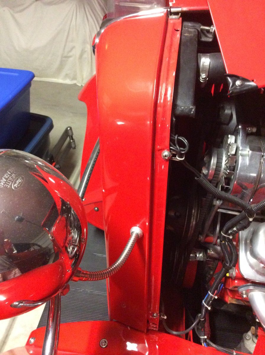

    I didn't lower anything, I took my A shell off and put the 32 right on. I trimmed about 1/2" off of the sides to keep it from rubbing the fender. I'm using an A size radiator, it looks perfect from the side. Hope this helps.
  6. dudley32
    Joined: Jan 2, 2008
    Posts: 2,163
    dudley32
    ^^^this is a 30/31... 28/29 won't work like that...I would suggest mocking up with a hood...when it lines up you've got it...

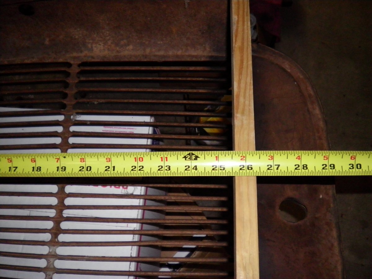

    What's the mesurement of a stock '32 grill?

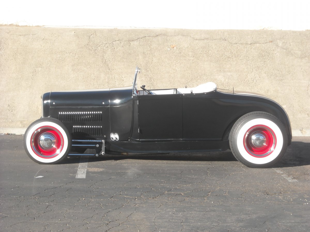

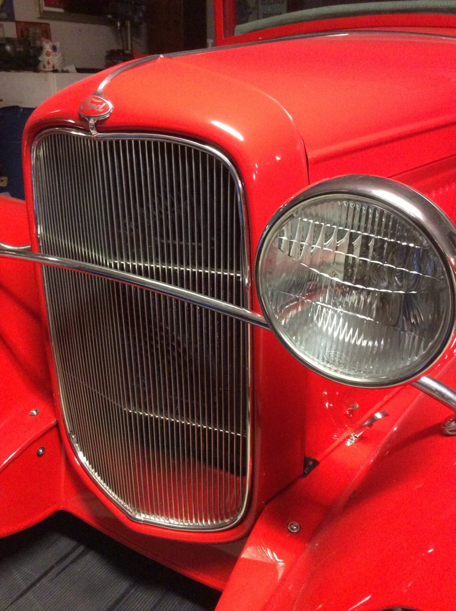

    Make it look like this!! I think mine is cut 2 inches. But in reality trim it a bit at a time until you get the proper look.

    both my '32 p***enger and '32 commercial measure 26 3/8 inches
