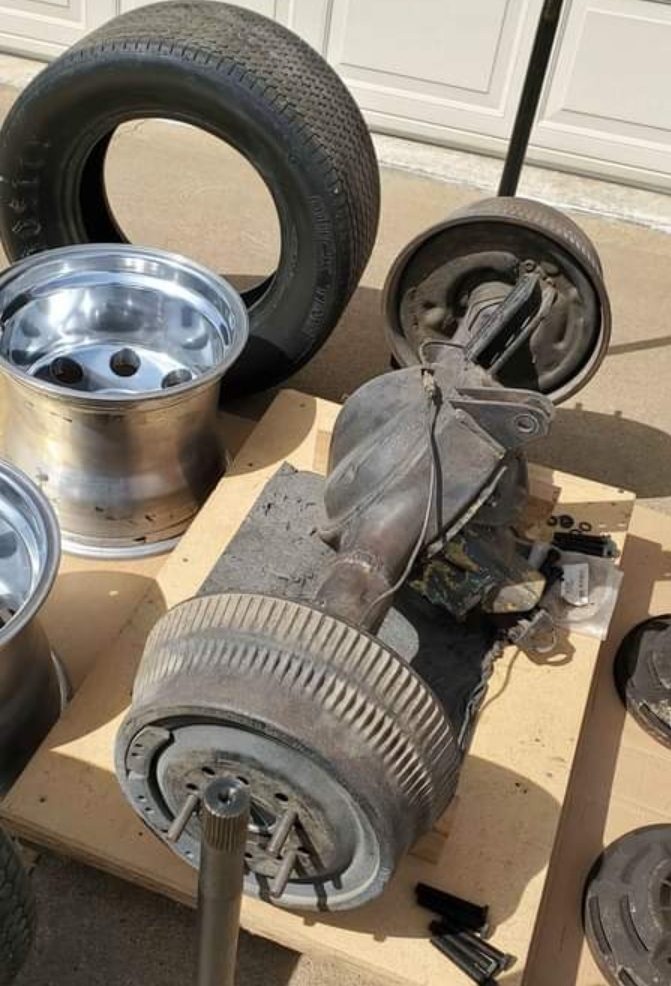

  17. Sadly the axle is now stripped ready for the new diff

    slide the axles in and measure, no need to have the center section in it....
    Mr. C. likes this.
