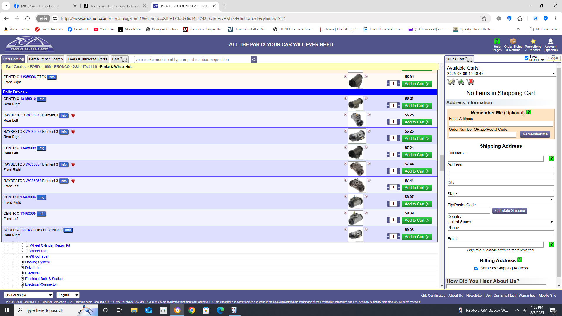

    I put this in Google
    Mr. C. likes this.

    You could maybe do the same off the part number on the backing plate.
    There were some 57.25 wide rears but with your dimpled housing and no oil drain/fill hole it doesn't correspond to the correct years.
