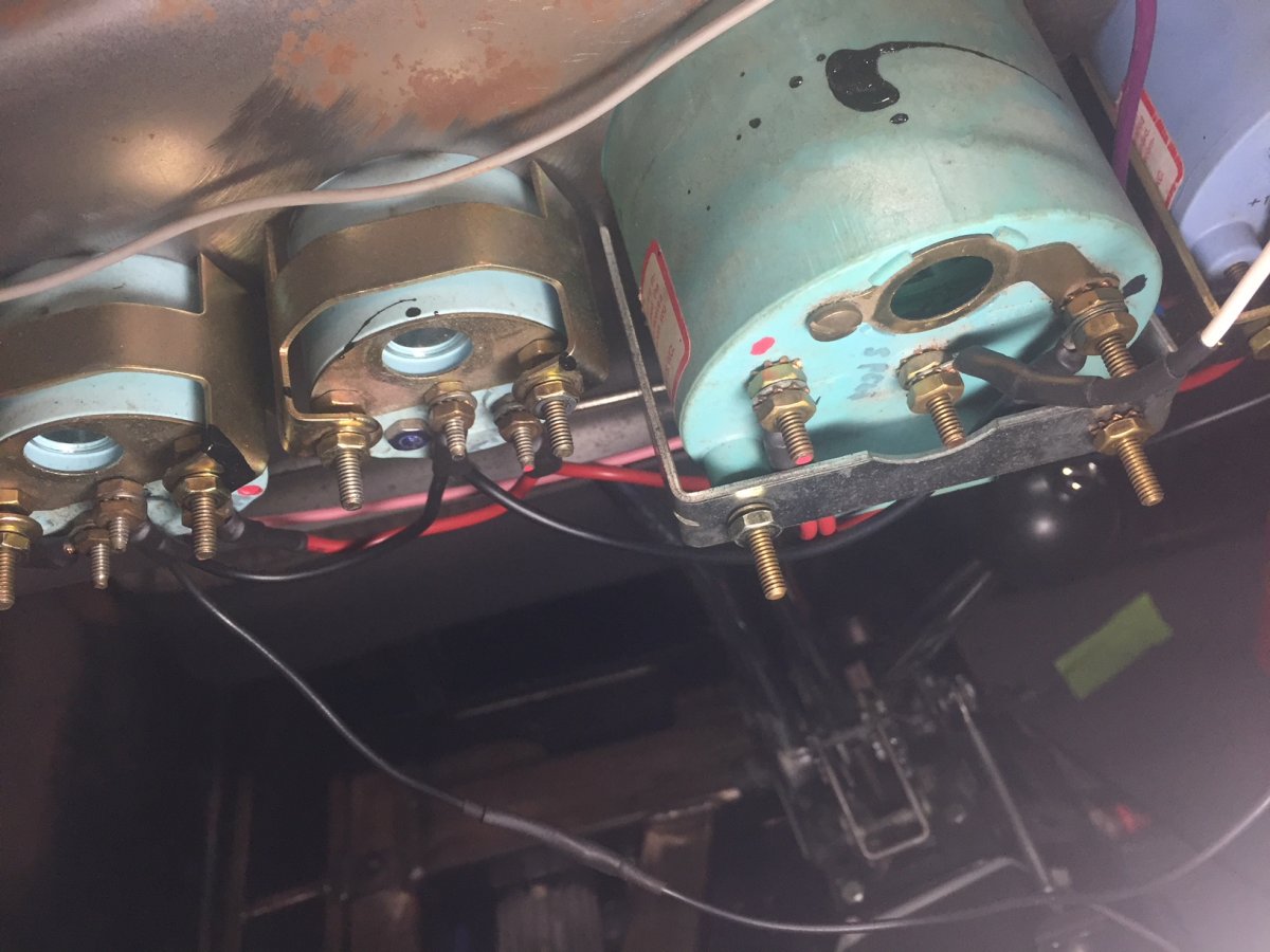

    843BAE41-D47E-4719-9717-969EB52F0B23.jpeg I have a six pack of electric Mooneyes gauges, but no wiring. I have the bulb & socket for the larger gauges (they are single wire with multi finger prong metal socket) but need to know what type of socket fits small gauges? Single wire, dual wire? Metal housing? Plastic housing?
    Tried Classic Instruments tech support, but they never got back to me.
    The hole is very close to a center thread, so I don’t think it has any collar like the two larger gauges...
    Any help appreciated- thanks!

    Looking at the photos you posted there appears to be a metal plate at the rear of the gauge that the light socket attaches to. The plate is connected to the ground stud. If this is the case then than a single wire light socket will work. However there is no reason why you couldn't use a 2 wire socket with one for hot and the other for a ground. If it was me I'd just use a single wire socket and call it a day.

    Single wire, grounds through that copper part.
    You may have to grind a little bit of the flange to clear the stud.
