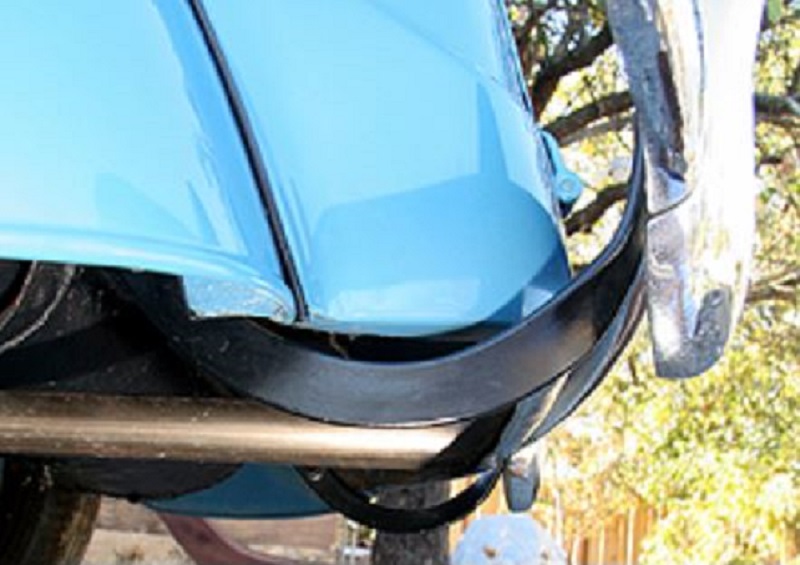

  6. Xdrag48
    Joined: Mar 1, 2009
    Posts: 477
    Xdrag48
    '48 Ford Anglia's have brackets under the body panel. They would be easy to make. Here are some pictures. I am sure a google search would show more.
      111.9 KB
      60
      78.9 KB
      53
      50.8 KB
      50
