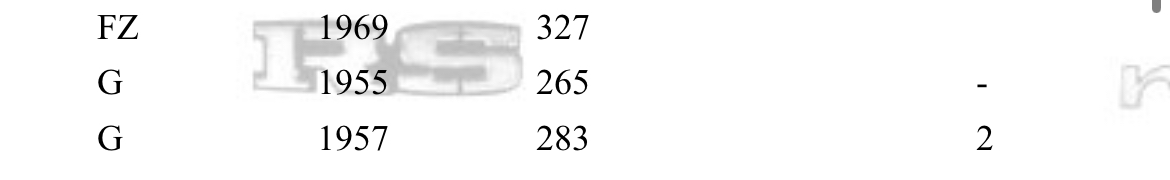

    My buddy just acquired this motor they told him it’s a 283 from a Vette (shocker I know right) anyways, there are a couple things about it that are confusing
    The casting number is ‘60-64 283 according to everything I can find, and it has casting boss for side mounts. So that rules out 55-57 blocks. Then he said it had suffix code G but everything I can find on that shows “G” as 57 283 but the casting number is later than that. He sent me these pictures and at first glance it does look like a “G”but now I think it’s probably a “C” a few other things I noticed are the exhaust manifolds don’t look like Vette either. So I’m thinking it must be a ‘60-‘64 283 that someone has put front mounts on probably to put into a tri 5 car at some point.

  3. Suffix code C
    suffix code G

    That's not an original G stamp. The line was higher, and straight
    Did you find the casting date code on the back of the block?
    Why does a Vette motor have that oil pan?
    etc.

    It's a C, with an scratch.
    Squirrel is right (again).

    Also when they used that block casting, all the Vette suffixes were two letters.
    You need to tell your friend to ask you about this stuff BEFORE he buys the engine

    In order to help nail it down, there will be a casting date code on the intake to the rear of the carburetor, and one on each cylinder head in between two of the valves. Something like C 5 2 would be March 5, 1962. By the way, Corvette engines never used a Rochester 4GC like this engine has. Of course, after 60 plus years, it could be made of parts from six different engines.

    The block casting number 3789935 I.D.'s as a late 61 and possible early 62 Chev pass and Corvette 170 hp 283 with a manual trans. I sourced this from the Chevrolet by the Numbers books by Alan Colvin, taken directly from the G.M. Archives.

    The fact remains, the lowest horsepower rating for an early 1960s Corvette 283 was 230. A 170 HP engine had a 2 bbl. carburetor.

    True, I should have been more clear in my description. The casting number posted by the O.P. is for a late 61 and possibly early 62 283. the suffex code"C" indicates that this block was used in a 61, 170hp passenger car. This block casting was used in both passenger cars and Corvettes for all horsepower ratings, 170 thru 315 hp. All Corvette suffex codes were two digit and the lowest Corvette H.P. rating was 230.
