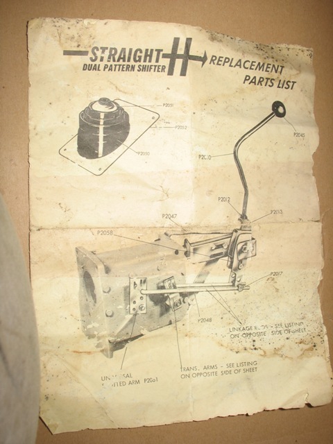

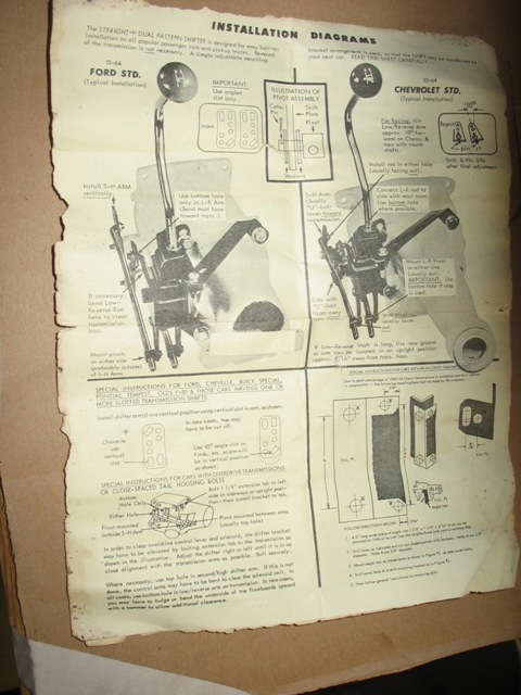

  1. I need to install my Hurst Shifter to the trans and I would like to see if anyone has the same trans I am using and which shifter did you use for this conversion. I have pictures of my Hurst but I may have to cut and make my own brackets. If you have something that may look like what I am doing if you could post some pictures so I have some ideas. I have a 1952 Mercury 3 speed I am told.
    Thanks
    Frenchy

    It looks like your kit is complete with brackets and hardware but your crossmember is in the way. You need to either raise the engine and trans to sit on top or make a new one.
  4. I am planning to have the trans sit on top of the brace so that I can install the shifter. No problem should be easy to modify.
    Frenchy
