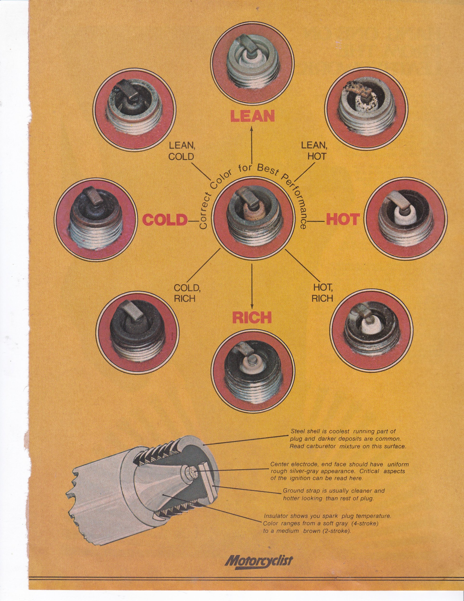

    Here is a better reference.
    vintage6t, CSPIDY, saltflats and 2 others like this.

    Funny thing with these plug charts that they never so a plug like I try and research.

  26. It’s says “champion”
    lostn51 likes this.

    Old plugs without any historic information. You stated they have around 6,000 miles on them, back in the points and old gas blends days, 10,000 miles on plugs was at the end of their usable mile range. Replace them.
    A J18 seems like a pretty hot heat range plug to me, and the plugs look a lot like the plugs second to the left, bottom row of the last plug reading chart. Without history of the plugs, any reading is going to be questionable. You have no idea what those plugs have been through.
