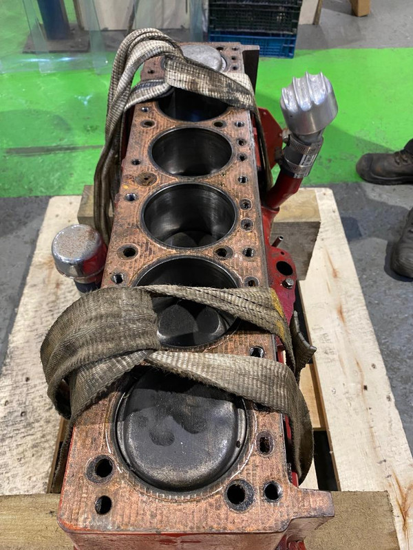

    Hello everyone.
    I am in need of some help, please. I am trying to put a 46-54 270cid GMC motor (according to casting numbers) back together in my sprint car. This motor has been heavily hopped up in the past and so is now far from stock.
    I have a new gasket set, but the bores are larger than stock (approx 3.15/16"). The head gasket in the kit I have is too small and overhangs the bores. I am worried about hot spots and detonation with the gasket hanging into the top of the bores.
    There is a part number on the old gasket (Felpro 7607), but I cannot find any leads on where I can get one from, nor what I can cross reference it with.
    Please can any of you experienced guys give me some guidance on this - I am hoping to get to the beach races with the car in May.
    I am in the UK, which makes it even more complicated!
    Thank you
    LT

    Best gasket company makes 302 head gaskets, but won't sell to individuals, only businesses. Find a shop that will order one for you.

    Look on the Best site. Their 302 head set will have all you need and their intake manifold gasket is better than anyone else’s. A 3-15/16 bore is close to the limit on the later blocks but good on the early ones. If your H head has not been cut too much the compression is pretty good. I’ve used Venolia pistons that look like those on a head with .100” cut off. The H head accepts 1.94-1.60 Chevrolet valves with ease. I’ve also gone to head studs from ARP. They don’t list them but you can buy them by length.

    Thanks guys. Roy at Best Gaskets and Bob at Marx Parts have been really helpful and I think I am now sorted.
