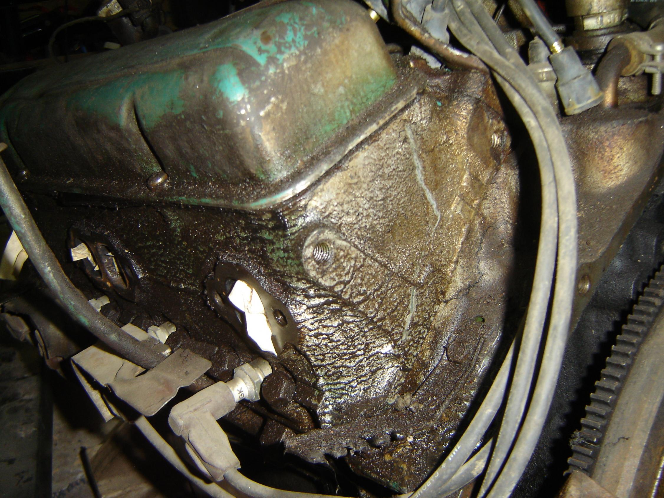

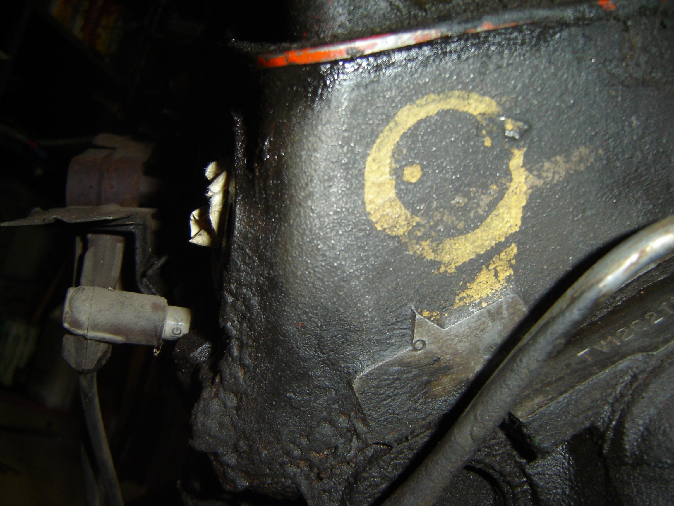

    take a look
  20. primed34
    Joined: Feb 3, 2007
    Posts: 1,534
    primed34
    The second picture is post '69 head.
  21. old slingshot
    Joined: Dec 9, 2009
    Posts: 81
    old slingshot
    the first and second picture are the same head casting num 3755538

    They had the bosses on late 50s heads, and some were drilled for air compressor mounting, both on air suspension cars (of which they built very few) or for trucks with air brakes.
    Does that head with the holes in the end have staggered valve cover bolts? that ended in 59

  24. old slingshot
    Joined: Dec 9, 2009
    Posts: 81
    old slingshot
    Yes squirrel , staggered valve cover bolts

    The early head is not double hump, it's two bars, they're square, not rounded on top. Looks like a truck head, on a truck engine. probably open chamber, might have different exhaust valves or something to deal with the higher heat that truck engines develop.
    To answer the original question, the engine probably has more compression on one side than the other, and if you were going to try to run the engine in it's original truck application, it might not last as long as it should. Apparently it does still run.
    I have the 1959 Chevy parts book, it lists a 3755537 head casting, but not the 3755538. And I've had a few of the 1958-59 heads with the bolt hole bosses on the ends. Looks like it's just a truck motor, that had one head (and valve cover) swapped with one from a 60s power pack engine. If you found another 520 power pack head, it would be a good engine to build for a 60s style hot rod.
