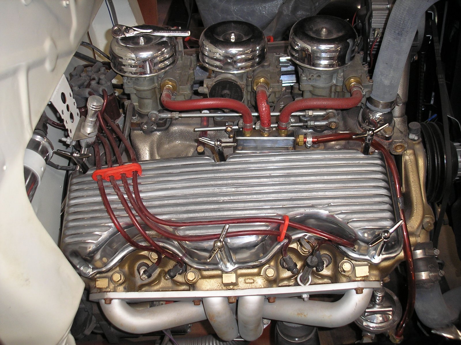

  2. You want the carbs with the fuel inlet facing the side. Such as these;
    loudbang, lewk, Deuces and 2 others like this.

  4. Please correct me if I’m wrong, but are the side inlet 2GC’s the smaller sized carbs?

    Thanks for the pic! Are these original carbs?
  6. They are supposed to be as far as I know. But I am no expert.

    Side inlet is needed for rear two, not enough space between them to run a front inlet fuel line :rolleyes:

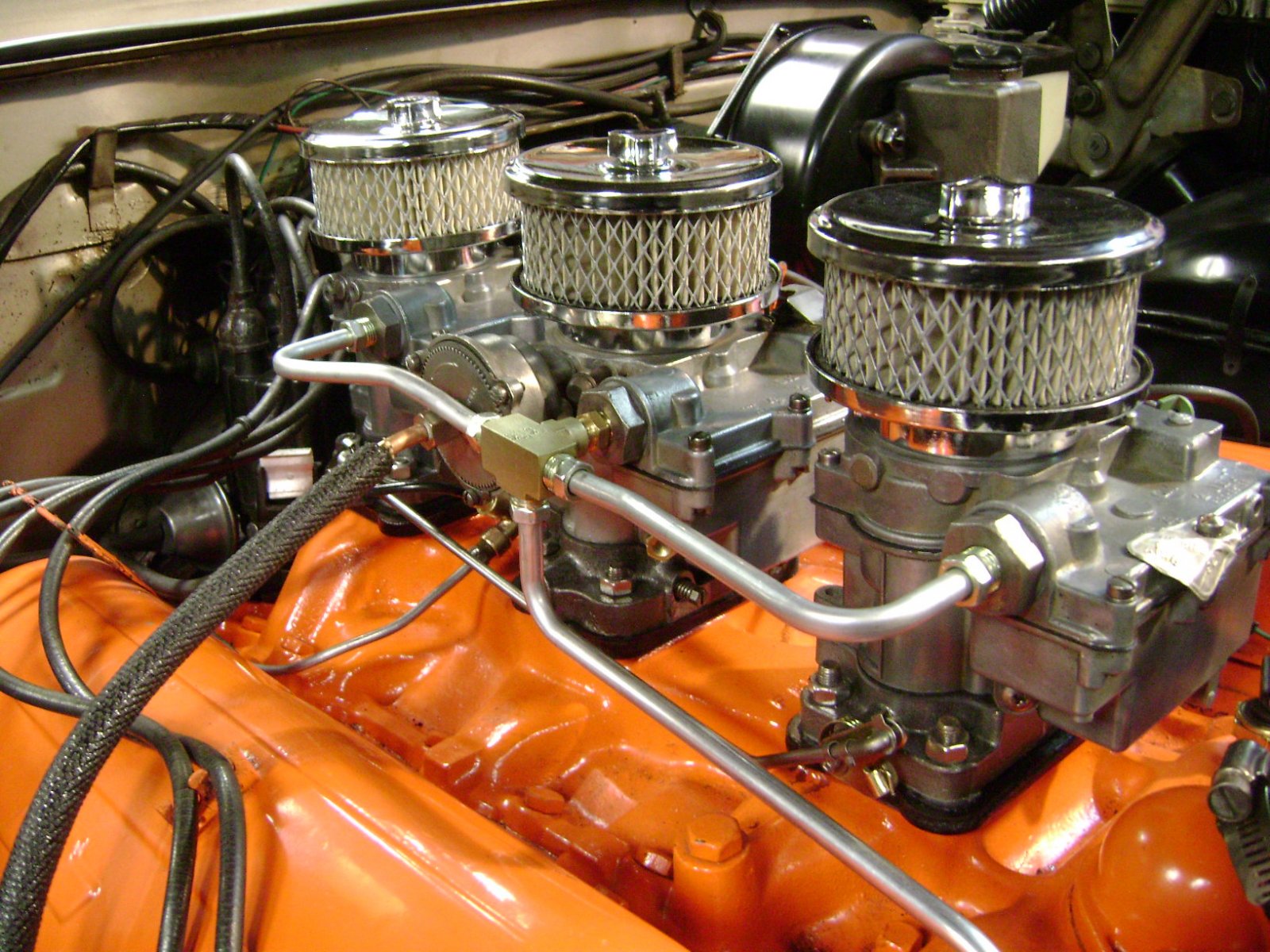

  8. Pretty sure the original carbs were front inlet, with pipe to inverted flare elbows screwed into the inlets.

    I might be mistaken but looking at some of the factory intake manifolds from back then it looks like they had a different base bolt pattern than the regular Rochester 2GC single 2bbl carbs.
    Real end carbs should be recognizable by the lack of the bigger lever on the driver's side and the presence of a small lever on the passenger's side. Also no idle mixture screws.
    Front inlets on these;
    loudbang, deathrowdave and lewk like this.

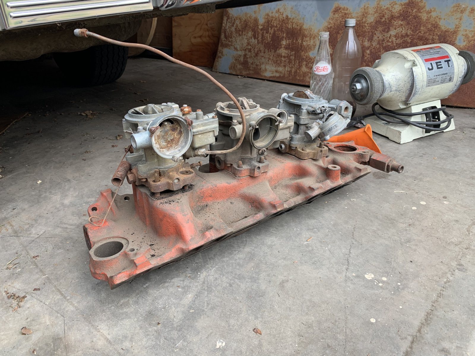

  15. lewk
    Joined: Apr 8, 2011
    Posts: 1,069
    lewk
    from Mt
    Thanks for all the input and pics guys. This is all super helpful. If I run the conversion kit, there’s still a local yard with early sixties stuff that I could pick core carbs from. I’ve already got maybe 4 2Gcs around in various conditions. One from a running engine, one came with my tripower intake and a couple off junk 265s.
    The car is a 60 El Camino, the engine is a 59 250hp 348. The intake is 59 as well and I’ve got a 58 348 as a backup if the 59 can’t be used.
