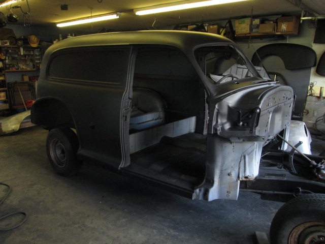

  3. Bandit Billy
    Joined: Sep 16, 2014

  5. gimpyshotrods
    Joined: May 20, 2009

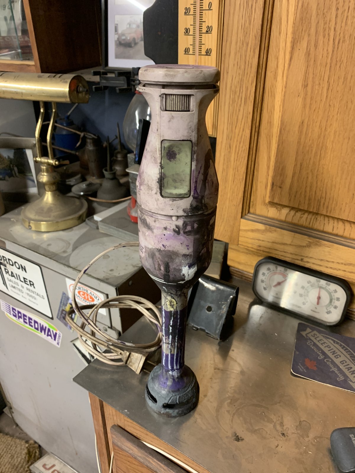

    I gave up and bought an industrial paint shaker. I run the hell out of my cans before starting. You cannot over-mix.

    This is an awesome paint mixer.
