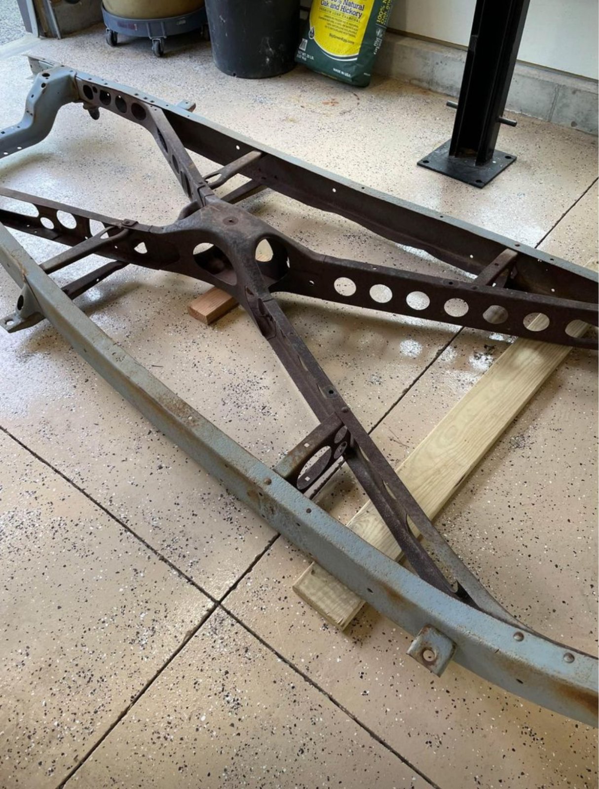

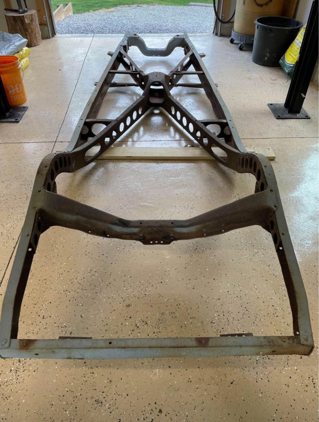

    As I study these pictures, the reason I think this is a '41 is the lack of the small front cross member. But it could just be missing?
    And the "hump" in the X-member being flat, not having the X stamped into it.

  12. andy dewitt
    Joined: Mar 25, 2017
    Posts: 37
    andy dewitt
    Not a 41 ,sold one a while back and the brackets on side of frame are different on a 41, the frame in question matches 46-48 which I have several

    Kelly, that is a '42 to early '47 frame with the welded style x-member. The only difference than a '41, is the side body mounts that bolt on the side. It will also work on a '48. If you moved the front crossmember forward, you could also use it in a '41 Mercury, or a '42-'48 Mercury, with slight modifications. Hope this helps.

  17. I recently looked up frame specs and 35 to 40 cars and 40 to 41 1/2 ton trucks had the same frame. It looks like some one modified this frame for a v 8 at some time

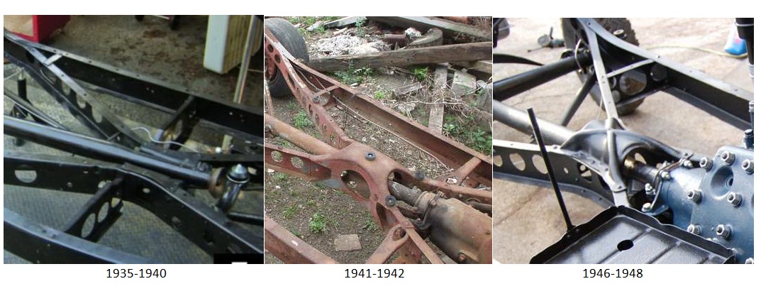

    This might help, as mentioned earlier the center X area is different.
    Otherwise your frame looks similar to my '46 Tudor one. upload_2023-1-30_21-5-28.jpeg
