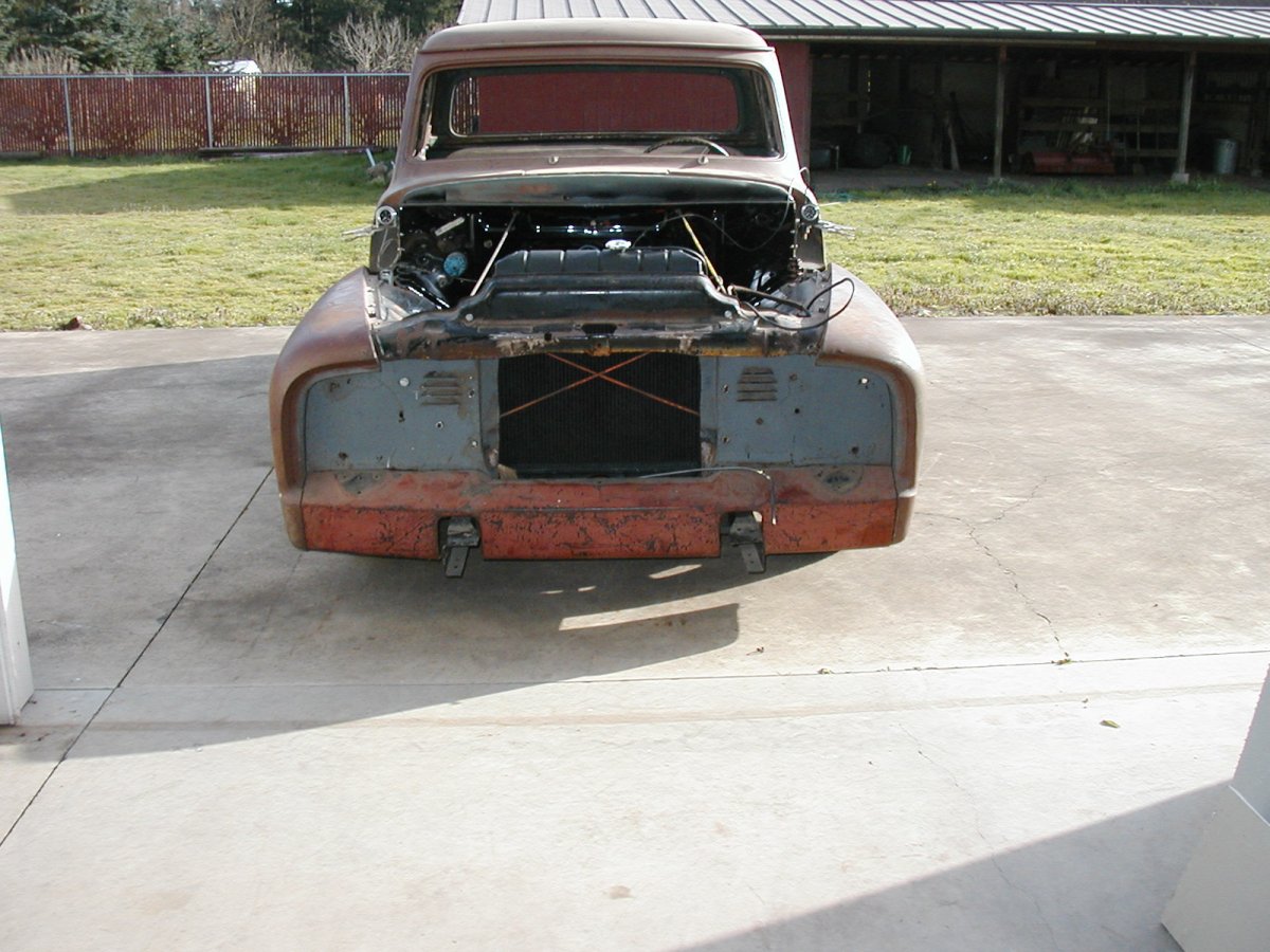

  5. I've chopped many tops. I learned on my First one not to tilt the door tops inward to make up for the narrowing that occurs when pinching the A pillars to get things to line up. I also have never split a top down the center. Think about it and do a lot of home work keep it simple. Buy a Tig welder if you can. Don't do like most and just Chop and bend and fill gaps. It's not that difficult to do clean work. So to back that up here's a dead on front view of an old project showing the Windshield opening. The A post was cut 3.5". To make the front gl*** fit it only required the Bottom edge to be cut and the lower corners rounded to fit. NOTHING was cut off the top edge or either side.

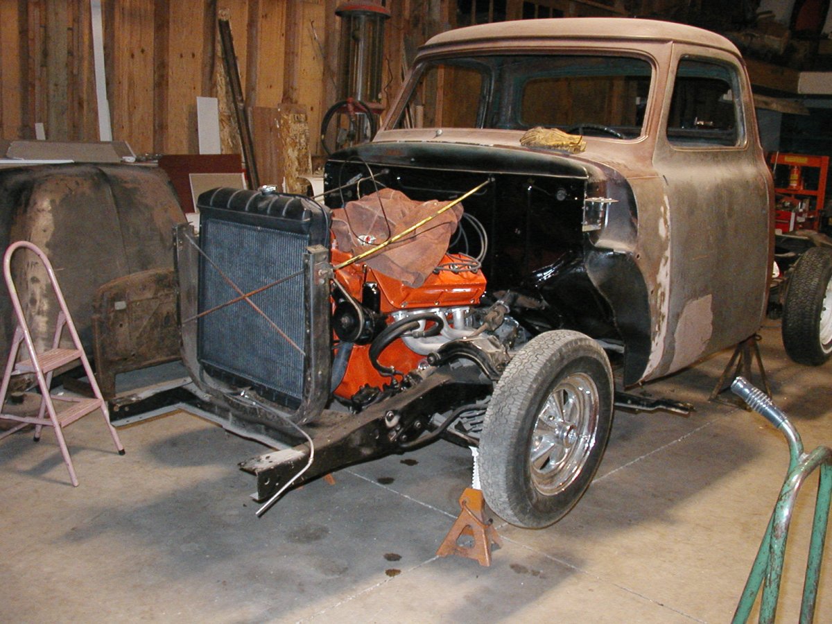

    53 F-100  3-19-10 016.jpg Now, here is a side shot showing the Door. Notice there is NO cut and tilt marks that would indicate the door top being layed inboard to get to the Jamb. That's because they were not.
    Apart agian 1; 002.jpg Look close, think about it. Yes you can ask me questions. What I should tell you is that I don't think like the Normal builder. I don't cut, push and bend things into submission. Sometimes it pays off to not follow the heard.

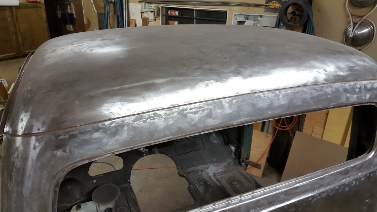

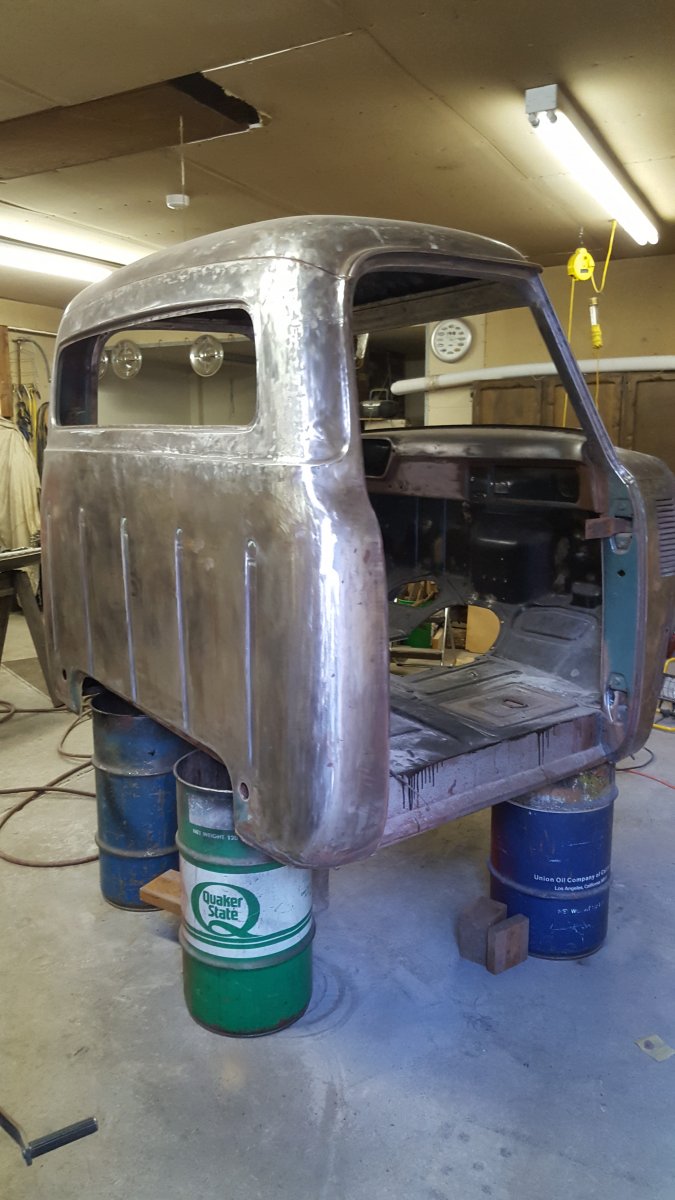

  15. On this F-100 project I used 2 Roof panels to get what you see. There's a give away where the A pillar makes contact at the drip rail. Also if you look close right where the windshield gasket flange begins the bottom corner radi. you'll notice a divot. So, on the A post what I did was brace the post on the Cab to each other and cut the 3.5" off the Top measuring right below the drip rail down 3.5". Then I sliced the gasket flange off that post down to where the lower radi started. Top #2 A post was cut long to fit all the way down to the lower radi cut. It also was braced very well. I slid #2 inside #1 and made inside and outside vertical welds and ended up with a little fatter A post than stock. I made a front to back slice on the center of the shoulder above the drip rail. I left a good bit of #2 roof skin on the new front half. I removed the back window out of the back panel leaving about 1.5" of metal on it. The back panel is cut and dropped keeping B Post strait to itself and made the same cut above the Drip Rail as I did on the front section. Then align and join the two door jamb tops to each other just about center of door opening. This actually makes the top of the jambs a touch wider than they were is stock height. Now the radi above the drip rails and the top skin are hand worked till they can be seemed back together. The shoulder is now just a bit flatter than stock. When re installing the back window it required about a 3/4" strip to be added to get the vertical edge of the window section to re join the outer edge left behind the B Post. Here's what it looked like Bare Naked. This was before I did the metal finish work. Also notice the factory seam above the back window is still there and if you look close you can see where I joined the drip rail together between the two top panels. Oh, and there is a horizontal seem side to side joining the front and back panels together. I always do that on the high spot of the crown.
    The Wizzard
