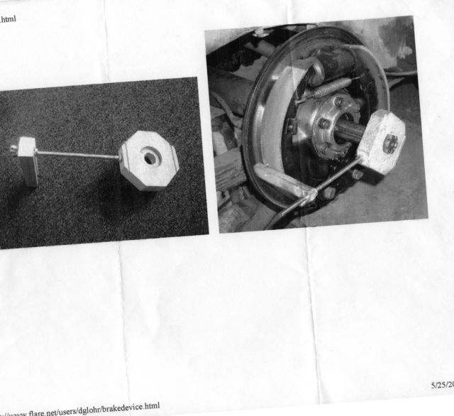

  3. Make certain your shoes are adjusted properly prior to bleeding. I cannot stress this enough. Here is a home made tool to use as an adjustment tool....it should work on your brakes, too.

    The pushrod adjustment had been done yesterday, screwed it back to zero what was a bit too much so today I adjusted it again to the point that the piston has returned completely.
    The brakes have been adjusted also. Made me a tool as discribed and went to work with it. Then started bleeding the entire system again but no result whatsoever...
