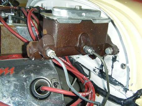

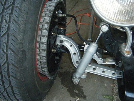

    Howdy.. new to rods, just baught a 28' Ford model A Tudor ratrod and the brakes are terrible. It's got (this is what the seller said) 40's ford truck brakes with early buick finned drums. Pulled them apart and the shoes were GONE and drums needed turned. So I had them turned, and got new shoes and it still doesn't stop for crap. I tried bleeding the lines over and over. Went through about 10 or so MC's full of fluid, and still getting some air bubbles in the line. My next step was to swap out the MC and the lines to make sure it's all new, then I started thinking, why not just go to disk upfront. I've read a number of threads on the HAMB about who likes what, and I keep coming back to the Speedway conversion kit. But in order to get the right one, I have to know what I've got, and I don't. I will attach some pics, and if any one has any thoughts, please please chime in. I tried to do my homework 1st, but I'm stuck. Thanks in advance.
    Also, if you have any advise on why I still have air in my front left line, I'm open for suggestions. Like I said, my next step was to swap the MC and lines. I have adjusted the top and bottom cams on the backing plate to the point where they just begin to drag on the drum, so it's not my adjustment.

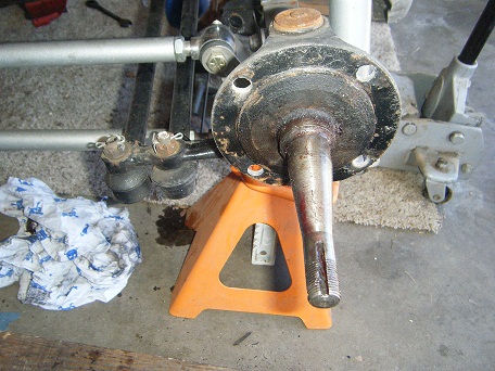

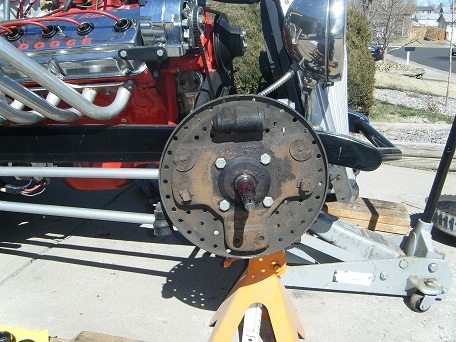

    The backing plates you have are 39-41 Ford passenger car and pickup.
    The spindles are 37-41 Ford passenger car and pickup.

    Unless you find something wrong with the L/F wheel cylinder, I would suspect the master.
    You didn't have a picture with the shoes installed. If you have unequal length linings
    on the shoes, the longer one is the forward shoe. Different than people are used to with
    self energizing brakes.
    Like the other guys posted, there is a specific procedure for the initial adjustment to center the shoes these '39-'41 Lockheed brakes.

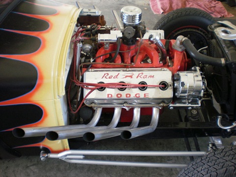

    I don't have any more suggestions for your brake issue, bud would like to see a pic or two of your HOT ROD. Red Ram Hemi power in a '28 Tudor has gotta be fun.

    Here are some pics Ebbsspeed. I've read tons of threads on the 241 RedRam Hemi, and it sounds like it's a pretty solid engine. Not the most power, but that's not what I'm going for (yet). Love it, if only I could drive it.
